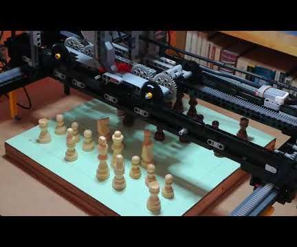

Step 2: The Hardware Build
As I previously indicated, the heart of the vision code will work with a variety of builds.
This build uses a robotic arm kit from Lynxmotion, the AL5D. Included with the kit is an SSC-32U servo controller board, which is used to control the motors in the arm.
I chose the AL5D because the arm has to be able to make repeated accurate movements and not drift off. The grabber has to be able to get between pieces and the arm has to be able to reach to the far side of the board. I still needed to make some modifications as detailed below.
The Raspberry Pi I use is a Raspberry Pi 3 Model B+. This talks to the SSC-32U board via a USB connection.

I needed further reach on the robot arm, so I made some minor modifications to it, using additional Lynxmotion parts which can be bought from RobotShop:
1. Replaced the 4.5 inch tube by a 6 inch one - Lynxmotion part AT-04, product code RB-Lyn-115.
2. Tried using an additional set of springs, but went back to one pair when I implemented item 3 below
3. Extended the height using a 1 inch spacer - Lynxmotion part HUB-16, product code RB-Lyn-336.
4. Extended the gripper reach using spare gripper pads attached by some spare LEGO pieces I had and elastic bands(!) This works very well, as it introduces flexibility when lifting pieces.
These modifications can be seen in the image above on the right.
There is a camera mounted above the chess board. This is used to determine the human's move.
