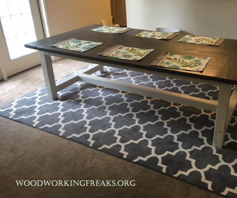

Since my last project , the wife and I have opened our own business doing marketing and branding. The building we chose to put our office in is an older warehouse converted into offices and is near the train tracks in our city. As this is a new business my wife has decided that we should build a lot of the furniture ourselves and the designs should be rustic in style. We decided to build a chevron table using some legs from an older office table we had that broke. This project took limited tools and money to make and added some extra character to the conference room area. So, let us get started on this project!
