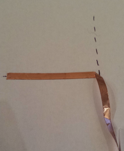

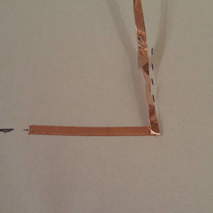

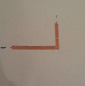

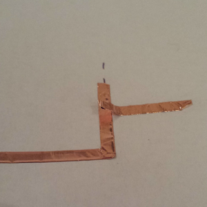

Following the template you made in the previous step, add copper tape to your circuit sheet. Remember, some copper tape is only conductive on the non-sticky side, so if you have to turn sharp corners with it, use the following procedure:
  • Fold your copper tape away from the direction you want it to go, sticky side up.
  • Fold your tape back over itself in the desired direction.
  • Flatten the corner.

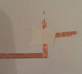

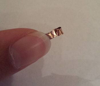

If you need to connect two pieces of tape, use the following procedure:
  • Fold the end of one of the pieces of tape over so the non-sticky copper is visible on both sides.
  • Tape the folded-over end onto the other piece of conductive tape using regular adhesive tape.

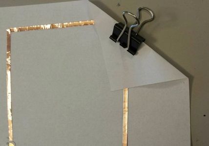

Step 6: Add Battery
Connect the battery by folding the edge of the paper over it so your positive and negative tape ends are both touching the battery. Make sure that you have the negative side of the battery touching the negative tape path, and the positive side touching the positive tape path. You can secure the battery and ensure a good connection by clipping a binder clip over the folded corner, as shown above.

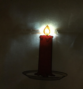

Step 7: Finish
Tape or glue your candle sheet down over your circuit sheet, leaving the corner clipped over the battery free. You're done!
With some resizing, this project makes a nice greeting or holiday card.
