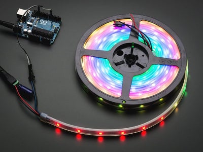

9 NeoPixel LED Lights

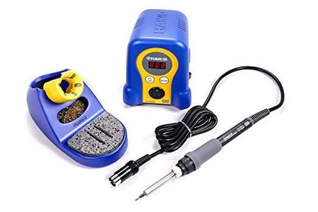

Tools:
Soldering Iron

  • Connect the Neopixel GND wire to ground, the +5V wire to VUSB, and Din wire to the argon pin D6

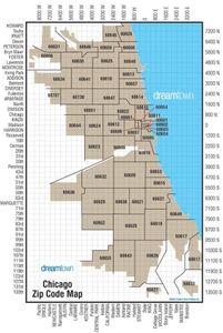

Step 2: Categorizing Zip Codes Into Neighborhoods
The Chicago zip codes were sorted into the nine different neighborhoods pictured above.
Here is a list of the zip codes in each region:
Central: 60610, 60654, 60661, 60606, 60605, 60604, 60603, 60602, 60601, 60611
Far North: 60631, 60656, 60630, 60646, 60625, 60659, 60645, 60626, 60660, 60640, 60666
Far Southeast: 60827, 60633, 60628, 60617, 60619
Far Southwest: 60652, 60620, 60643, 60655
North: 60613, 60657, 60647, 60614
Northwest: 60634, 60641, 60618, 60707, 60739, 60639
South: 60616, 60653, 60615, 60637, 60649
Southwest: 60638, 60632, 60609, 60629, 60636, 60621
West: 60651, 60644, 60624, 60623, 60612, 60622, 60608, 60607, 60642
Each neighborhood was assigned a different NeoPixel light. For example any zip code on the far north side would turn on the first NeoPixel Light.

The Chicago neighborhood map was printed, cut, and glued onto a 24 x 22 cm box. 1 x 1 cm holes were cut in each neighborhood to fit a NeoPixel light. A hole was cut out of the side of the box to allow the NeoPixel lights to connect to the argon.
Step 5: NeoPixel Set Up
9 NeoPixel lights were soldered together with sufficient connecting wire to ensure they reached the cut out in each neighborhood. Superglue was added on top of the soldered connections to reduce the chance of breakage. The NeoPixel lights were then taped into the map cut outs.
Step 6: Finished!
You should now be able to input any Chicago zip code and have the corresponding neighborhood light up. Click this video to see the complete project functioning.
