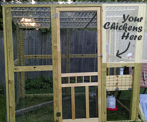

Fill the pipe with food and use the socket cap for the top. Connect the whole thing wherever you like with the worm drive clamps, but in the next step we're going to construct a feeding platform about 2 feet off the ground.

Get the 4 2-foot pieces of 2x4 and make a table. When putting this in your coop, I highly recommend either adding some cross-braces to make it more stable OR, if you have a conducive wooden chicken run as I do, just screw the whole thing to the side of the coop or run, for stability.
Now make something so that your chickens can get up there. Some can fly, some will need a ladder, or a stepping stone like a large rock, tree branch or roosting bar. I've got a ladder I put together with some scrap and the trunk of a young Rose of Sharon tree we cut down last year.
