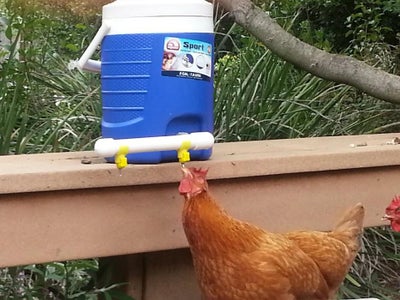

I want demonstrate using an easy-to-find cooler , PVC pipe, standard PVC fittings, plus standard electrical fittings to create the required bulkhead.

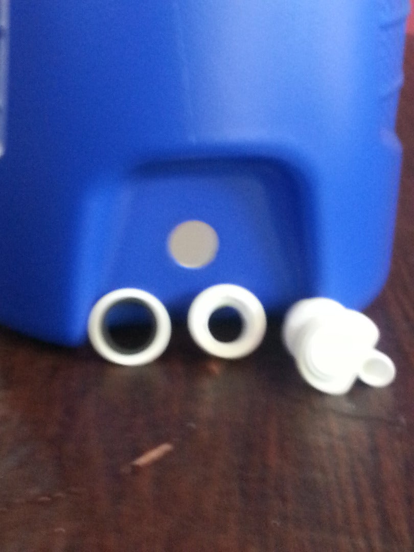

1/2" male terminal & 1/2" female threaded adapters from the ELECTRICAL department. << this is the clever part to make a bulkhead fitting! The difference between plumbing and electrical fittings is whether or not the threaded bits taper! Makes a difference, who knew?

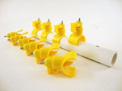

Poultry nipples & PVC pipe to create the watering manifold. I used saddle nipples made for 3/4" PVC, a scrap of 3/4" PVC, and a 3/4" end-cap to create my manifold. My small setup is great for 3 hens. But you could customize this array to your needs.

Remove the cooler's spigot. Make sure to save the gasket that is on the inside.
Here's how my parts are arranged:
- Watering manifold is made from 3/4" PVC, nipples & PVC end-cap.

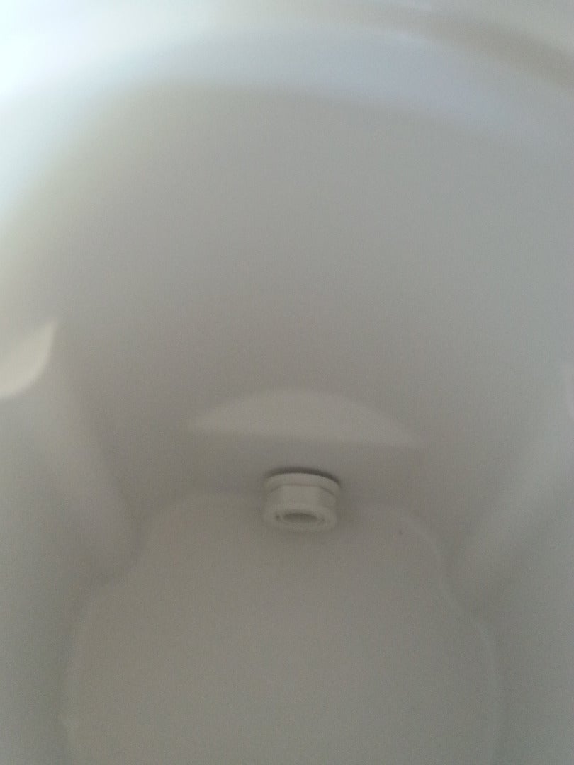

- Connect the electrical adapters through the spigot hole to create a bulkhead fitting. The saved gasket and some Teflon tape makes it watertight.
- 1/2" to 3/4" PVC elbow plus a scrap of 1/2" PVC connects the manifold to the bulkhead.

Drill 5/16" holes into 3/4" PVC to install saddle nipples. Connect the end-cap, elbow, and male electrical fitting with PVC cement.
Use the female electical fitting as a nut to screw the manifold onto the cooler. The gasket plus some Teflon tape makes the connection watertight.
