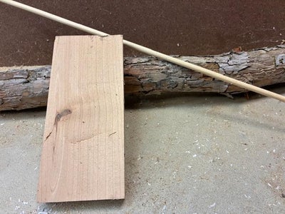

A dry tree limb about 2" in diameter and a foot long
1/4" x 6" wooden dowel
Wood 7" x 3" x 3/4"

From a piece of 3/4" thick wood, cut the base to 7" x 3". Sand all edges and corners smooth.

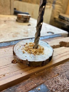

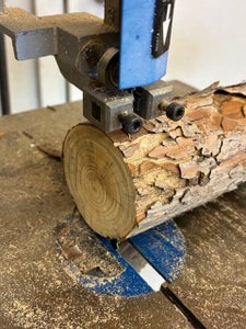

On a band saw or using a hand saw, cut 12-14 slices of the branch 1/4" thick. Smooth any rough surfaces. One by one, set the discs on a backing piece of scrap wood and drill 5/16" or 3/8" holes in the center of the discs.

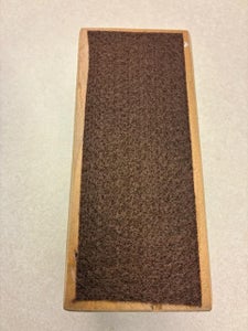

Place two of the discs on the base piece to determine about where the holes for the dowels should be drilled and mark the centers. Remove the discs and measure to determine the final drill locations. Drill a 1/4" hole for each of the pegs. OPTIONAL: Glue a 6-1/2" x 2-1/2" piece of felt to the bottom of the base piece. Add a drop of glue to the bottom of each peg and install them into the holes.
