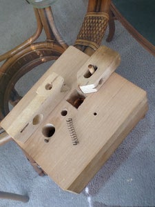

This is the slider mechanism for the gumball machine I made. It is my own design. The two main parts are designated as "A" and "B." In summary, a coin is inserted through a slot from above (not shown.) and its edges fit into the recesses marked as "D." The operator pushes on the left end of "A." The coin pushes on "B" and moves it forward. The gumball loaded in hole "C" from an inverted glass jar above is pushed until it aligns with another hole below in the frame of the gumball machine (not shown), and the gumball rolls down a channel (not shown) to fall into a cup on the exterior of the machine (not shown). When the operator begins to pull the slide "A" back to its original position, the pressure on the edges of the coin is released and it falls through a slot below into a coin box (slot and coin box not shown). Part "F" is a piece of bent wire. It slides in the recessed channels and round holes indicated by the two "E"s. "F" engages "B" when "A" begins to be pulled back to its original position. This also pulls "B" back to its original position so a new gumball can fall into hole "C" from the jar above. Although shown too small in the graphic, the round holes that are part of the inletting for "E" on each piece are a large enough diameter that if someone pushes "A" without a coin in the machine, "A" moves harmlessly inward, but "B" does not move forward and no gumball is dispensed. Make the round holes in "E" larger in actuality. There is enough tension on "B" supplied by a light spring from below that it does not slide when the machine is tipped. "G" is a recess in the side of "A" that rides over a vertical pin set to limit the travel of "A" so it can neither be pushed inward too far, nor pulled out of the machine.
"A" and "B" are made from a good, but inexpensive close-grained and easily-worked hardwood. The thicker end of "B" is as thick as the diameter of the gumballs you will be using plus just a little bit more, perhaps a little less than 1/16 of an inch. The hole marked "C" should be just slightly larger in diameter than the largest gumball in any package of the type you buy and use.
The photo shows the actual machine I made. I was able to get it from my daughter and take actual dimensions. I am working on these photos from an iPad and I am forced to use text notes, which make precision difficult. Check for pictures in other steps and dimensional information to get a complete set of measurements.

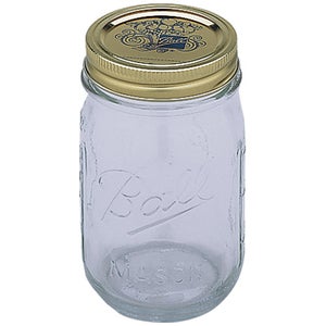

Choose a glass jar about one quart in size. It should have a good sturdy metal lid. A one-piece metal lid would be preferred, but a two-piece lid from a standard home canning jar could work.
Make a hole in the center of the lid large enough to pass a gumball. Make a wooden disc 3/4 inch thick and just a tiny bit less than the diameter of the jar's opening. Chisel by hand or turn the wooden disc on a lathe so one surface forms a cone like a funnel to help feed the gumballs into the gumball machine. Make a hole in the center of the wooden disc to match the hole in the metal lid. Set the jar and the disc aside for now.

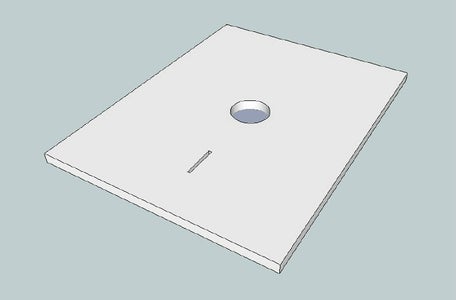

Begin by cutting a piece of Masonite the size of the machine's base. This could be about 4 1/2 x 6 1/2 inches. The hole is for the gumballs to fall down into a channel so they can roll to a cup on the side of the machine. The slot is for the coin to fall down into a coin box. Notice that both are closer to the back edge of the machine than the front. It is impossible to give exact dimenions because those will depend on the gumballs and the coin you use.

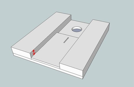

The red arrow indicates the width of sliders "A" and "B" from step 1. Add two pieces of hardwood to the Masonite piece and glue them in place. Their thickness should be equal to the thickest part of "B" in step 1, which is the diameter of the gumballs.

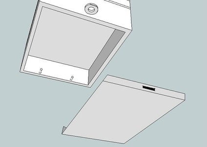

Add a skirt for a base to the assembly with the moving parts. (The view is from the underside.) The protrusion is the "A" slider fully retracted and ready for a coin to be inserted. The hole in the graphic is where the gumballs drop down.

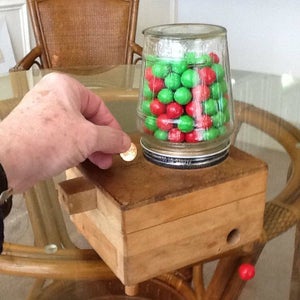

Fill the jar with gumballs and let the kids play. This gumball machine makes a fun bank.
Obviously, the kids can unscrew the jar from the top of the machine and take gumballs without inserting coins. But, that takes all of the fun out of using the gumball machine. The one problem we had with this gumball machine is that the balls did not always feed into the hole on top of the machine as they should. We often had to shake the machine to get a gumball to feed properly. Perhaps a larger hole in the jar lid and wooden disc would have helped.
I no longer have access to this gumball machine. That is why I used graphics rather than photos to describe its construction, and that is why I cannot show a photo of the finished gumball machine.
