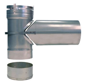

Step 4: The Tee Connection
For this application we will be demonstrating the two part tee connection. The part of the tee connection with the cut out on the side is known as the vertical part of the tee. The part of the tee with the looping hose clamp is known as the horizontal part of the tee. Start by locating the vertical part of the tee and insert the liner into the top of the female end. Tighten the clamp at the top of the vertical part of the tee around the liner with your flat head screw driver. This will give you a great, tight fit without having to drill screws through the liner.

Step 6: Finish Installing the Tee Connection
Locate the horizontal part of the tee connection. First, insert the horizontal section of the tee, hose clamp end first, into the thimble. Snake the vertical part of the tee through the horizontal hose clamp until the lips of the tee are inside the horizontal part.
You will find when you look through the inside of the horizontal part of the tee that there is a worm screw. With your flat head screw driver, tighten the worm screw until the two parts of the tee connect. Take this step slowly. As stated above, the lips of the vertical part of the tee should be inside of the horizontal part.

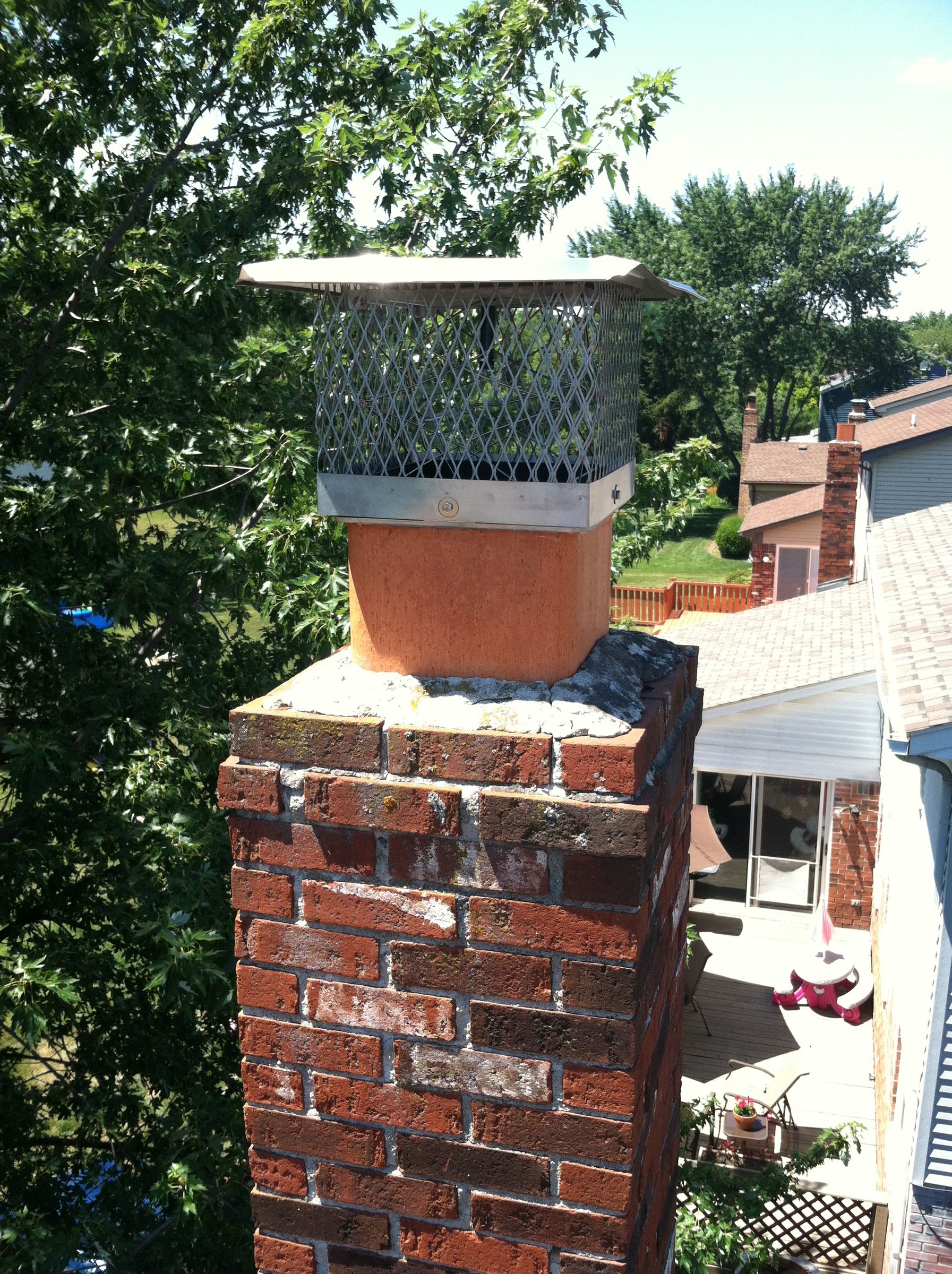

Step 8: Installing the Chimney Liner Top Plate
Once the chimney liner is all the way down the flue to the point of the thimble, the next step is to connect the top plate to the top of the chimney. The main function for a top plate is to seal the existing flue from rain, wind and critters from entering the chimney. It also has a clamp located on the inside collar of the top plate to support the weight of the liner.
Start by using your caulk gun and a tube of weather resistant silicone to run a bead of silicone along the top edge of the clay flue.
Next, thread the chimney liner through the round collar of the top plate so that the top plate is sitting on the top edge of the clay flue.
Locate the locking bolts welded on the four sides of the top plate. Center the top plate on the clay flue and use your flat head screw driver to secure the top plate to the side of the clay flue. Warning: Make sure not to overly tighten the locking bolts. If tightened too much the clay chimney flue could crack.
