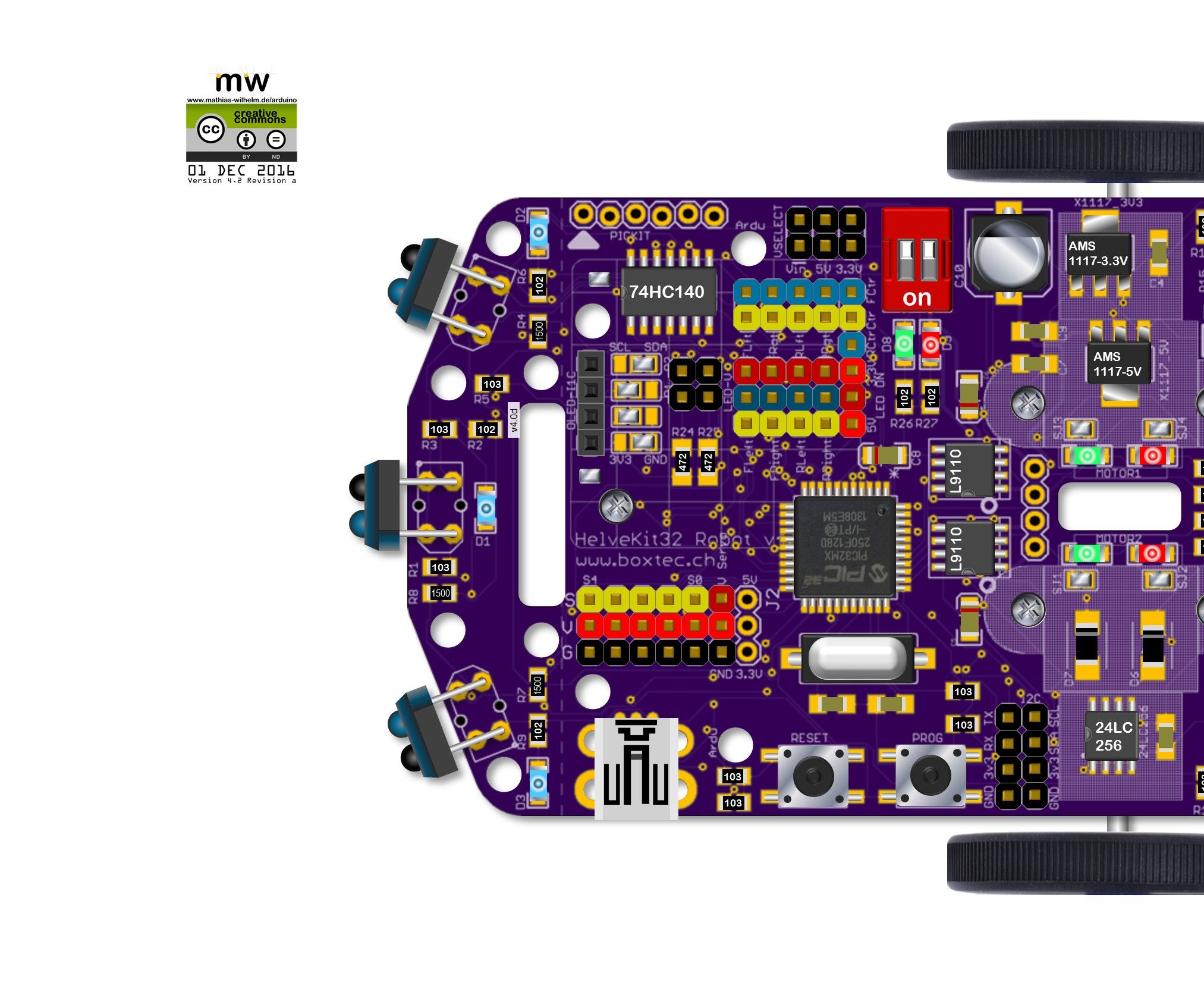

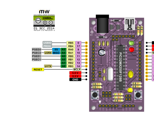

Step 2: The HelvePic BreadBoard Side
The HelvePic32 BreadBoard Side - short: BBSide
Inspired by the work of a friend with breadboard, I started to use breadboard as well and did not lik at all the mesh of wires that connect my controller board, being it an Arduino or the Lenny, to the breadboard. Of course there are plenty of boards that you can clip on to the center of the breadboard like the Arduino Nano or the chipKIT fubarino. But these boards consume quite some space on the breadboard and I still have a mesh of wires connecting the boards to the parts that I have to place on the side of the clipped-in board.
This launched the idea of having a board that you can clip into the side of a breadboard. TGhis would leave the entire opposite side to parts without connecting them immediately to the pins of my board - the HelvePic32 BreadBoard Side was born.

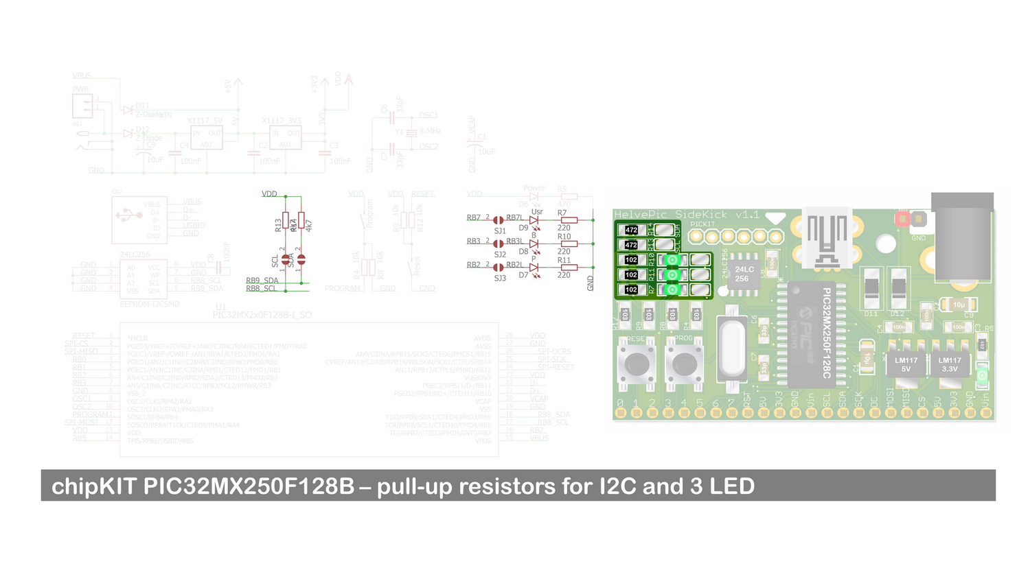

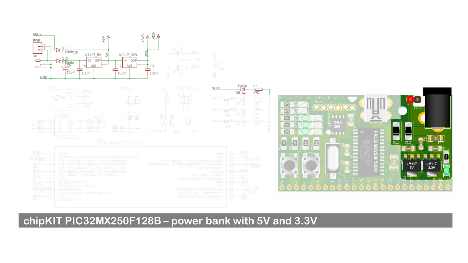

The Schematic
The schematics shows how simple the chipKIT board can be: There is the microcotroller with its 28 pins. To the right side, there are the header pins so we can connect the controller chip to the rest of the world. Above the chip, there is a small EEPROM chip with a small 100nF capacitor to smooth the power supply voltage.
The chipKIT controller needs two tactile switches to change its operation mode: The RESET button and the PROGRAM button. If the controller is reset and comes back on, it checks if the PROGRAM button is pressed. If that is the case, it goes into bootloader mode awaiting new code - otherwise it starts the code that is already loaded. These two buttons are shown above the chip with some pull-up resistors.
Then there are four LEDs with their current limiting resistors. The three LED, that are connected to pins, have a solder bridge so you can detach the LED if it interfers with your pin usage.
Above all, there is a standard power supply setup with two voltage regulators, one for 5V and one for 3.3V. There lis alos a Crystal that is needed by the controller to operate at a defined frequency and a 10 uF capacitor that stabilizes a special voltage.
The remaining two items to mention are the USB connector and the 4.7 kOhmpull-up resistors for the I2C lines.
And we are done!
So on a PCB this looks like the follwing pictures:
The core chip circuits
The power bank

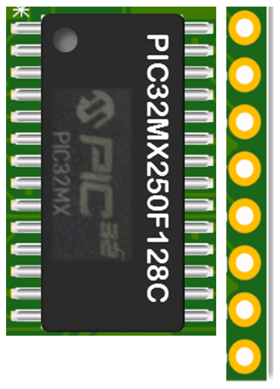

DYI - build your own board
The BBSide was created after a sequence of boards that started with a Through Hole design (PTH) that can be soldered by almost anybody including young children from the age 12-14 (under supervision by na adult as we operate with hot soldering irons at 300-400 degrees C).
In a later step I changed the Through-Hole DIL chip to the SMD chip with more pins (TQFP44) but that is not easy to solder and requires a lot of experience.
But there is also a chip version with the package size SSOP-28W - and that can be soldered by hand with some exercising. The comparison of the chip pin spacing with the 0.1" header spacing shows that this kind of SMD parts are easy to solder.
Soldering SMD - no way!
When I first thought about soldering SMD parts I was convinced I could not solder them by hand. But today, I prefer to design my boards all on SMD parts. Of yourse not this tiny form factors 603 or smaller! but 1206 or 805 are sizes, that you can solder easily. Any finally, it becomes much more convenient to solder these parts than through hole with its bending the wires, flipping the board, soldering, checking it had not moved, cliping the wires ... not to mention the hassle to remove or replace a part in through hole setup.
The parts I use are pretty large and the trickiest part is the processor with its SOIC28 package. But on that package, the pins of the chip are almost as far apart as the pins of a header:
So I made a video on how to solder this board and it takes about 15 minutes from start to finish.

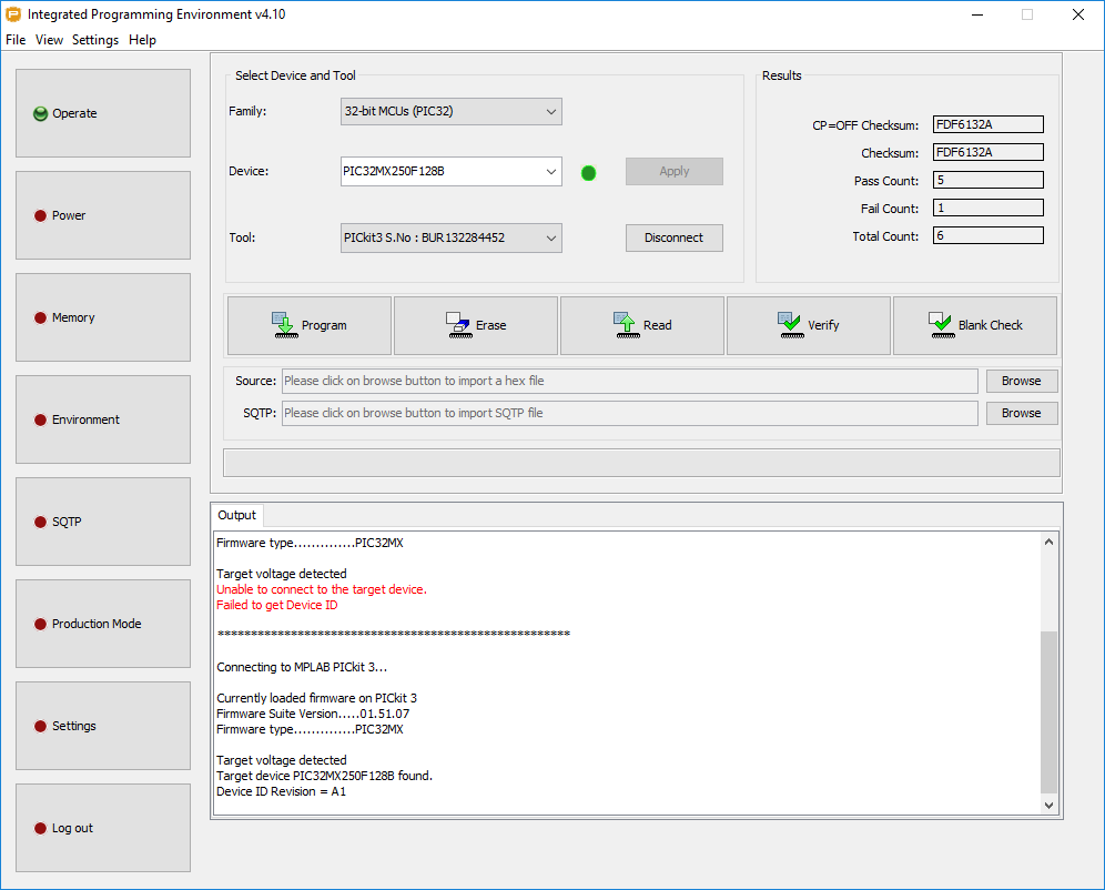

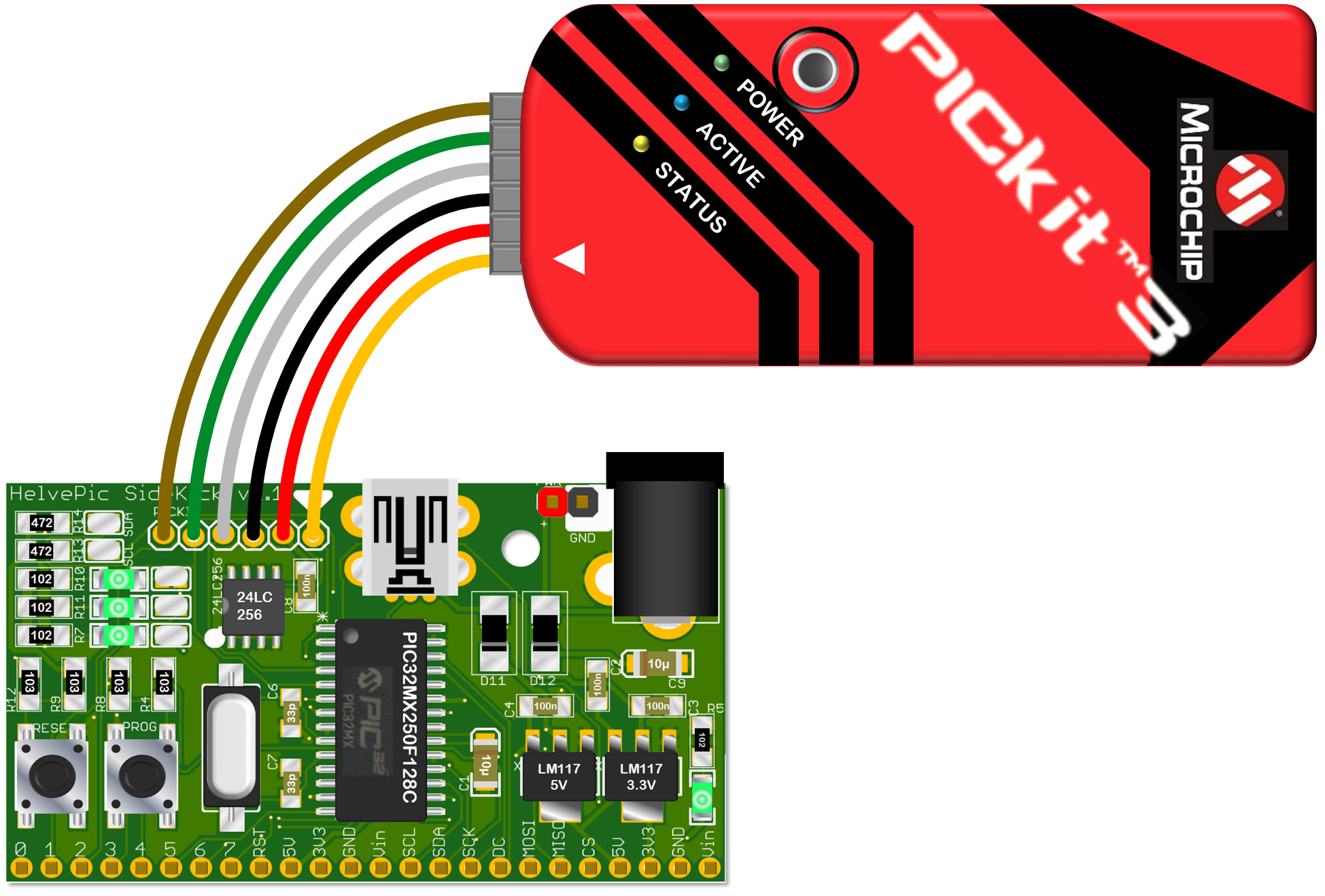

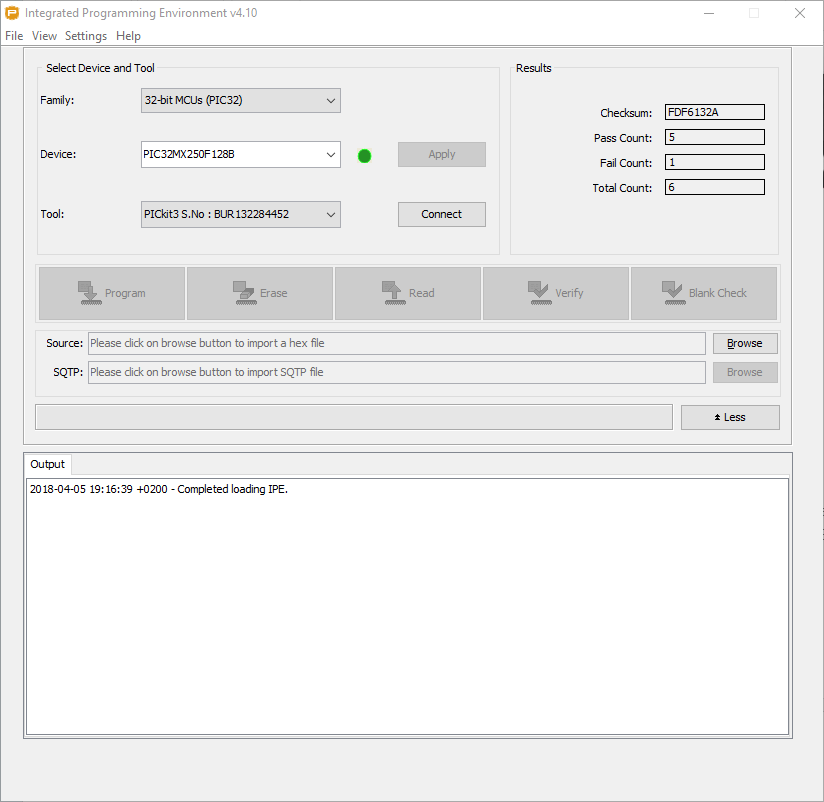

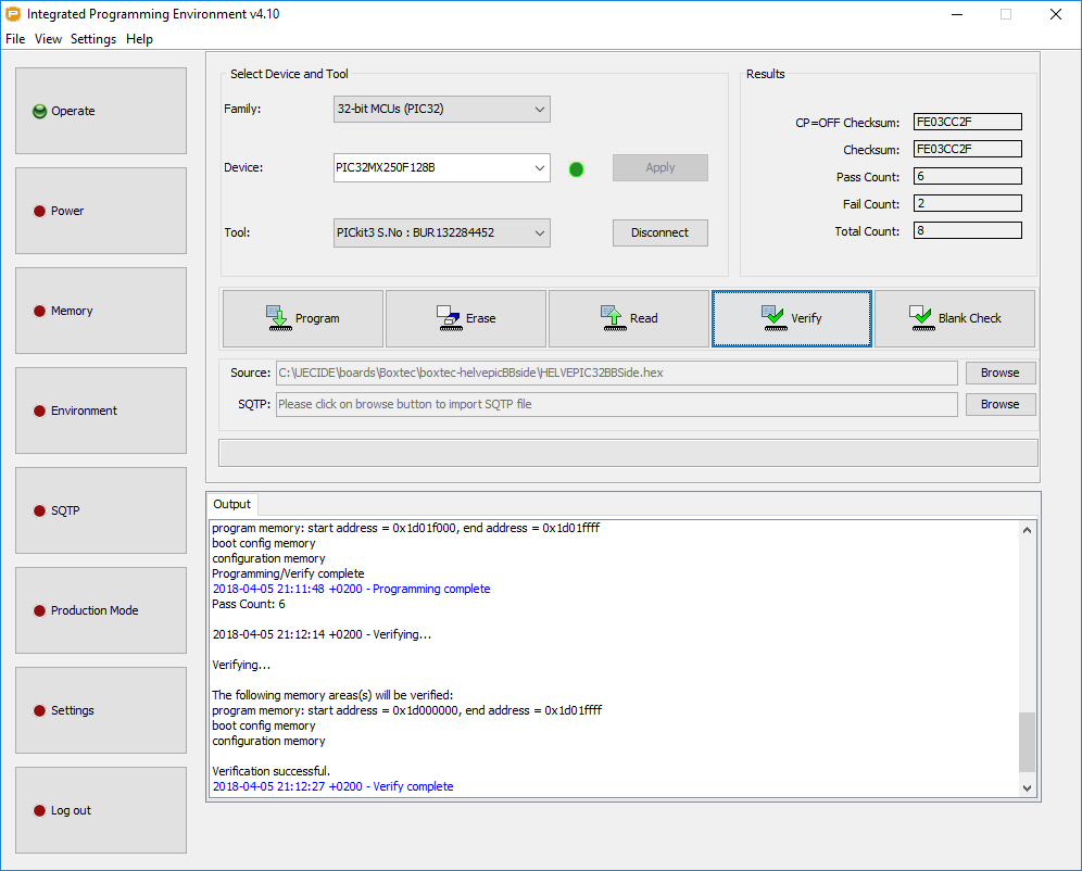

Once done with the soldering of the kit, you have to load the bootloader to the chip, which is done through a programmer called Pickit3, available for 10-20 USD over the internet. Connect the tool as follows:
To program the chip you need to download and install the MPIDE software from microchip. You do not need to install the compiler at the end of the installation process, as we do not use them, All we need is the MPLAB IDE to flash the chip. This is the icon on your screen I am talking about:
With the Pickit3 connected and the chip family and processor selected, the initail screen looks like this:
On my PC, the initial connection to the chip fails and I have to disconnect the Pickit3 from the USB port to get it going. The picture here shows the failed connection and the successfull connect afterwards:
Now we select the source for the bootloader. It is a 16kB file that you can download from this page.
Pushing the Program button will flash the bootloader to the chip.
If not sure, you can verify that the source and the bits on the chip are the same.
The best feature compared to the Arduino is the fact, that teh Pickit3 can also read a bootloader that is already on the chip and store it to a file. That makes playing with bootloaders absolutely risk free, as you can save the working bootloader and flash your version. It is not working, just reload the original bootloader.
Any by the way - no fiddling with fuses etc ...

The variable PIN_LED1 we did not define. This is due to the fact, the the two boards we look at have three LEDs on the board and the variable is already defined for the boards.
The digitalWrite routine takes care to set the state of the PIN_LED1 to either HIGH (the LED is on) or LOW (the LED is off)
