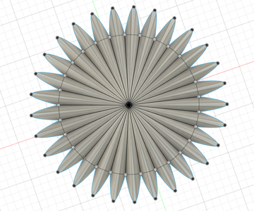

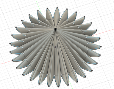

I had started off with a circular base and put a curved pattern using the spline tool. It was a singular curve between two points on the circular base, I had then used the pattern tool around the circle on the curve to create the indents around the circle. I had then extruded the indented circular base 0.5 mm. I offset a plan 15 mm above the circular base and put a 0.5 mm circle in the middle. I then used the loft tool on the circular base and the offset mini circle to give the idea of a conical shape. I finally lessened the diameter of the circular base so the indents poked out past the base.
