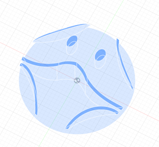

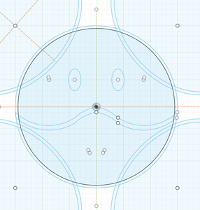

Created a circle profile for Haro’s body (Ø 30 mm).
Added arcs and spline curves to define facial details.
Used extrude to cut grooves and add shallow features.
Final dimensions: 30 mm diameter, 12 mm height, flat base for molding.
