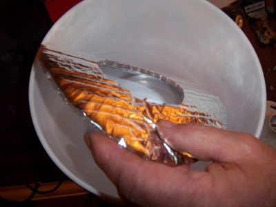

Step 2: Prepare the Lid
Ok, I got lucky. My bowl fit my bucket pretty exact. If you are lucky enough to find a bowl that fits your bucket like mine did. Well good for you, Yeah!!! you can skip this step. Otherwise...
You will need to cut a circle from the foil insulation with the scissors the same size as the inside of your lid. Then cut from the middle of that circle a whole the same size as your bowl. Glue the circle to the bottom of the lid. Then cut a whole in the lid with a knife, jigsaw, or Dremel the same size as the bowl so when placed inside the lip of the bowl will rest on the lid and hold the bowl up. You can prepare multiple lids this way for different size bowls as well.
