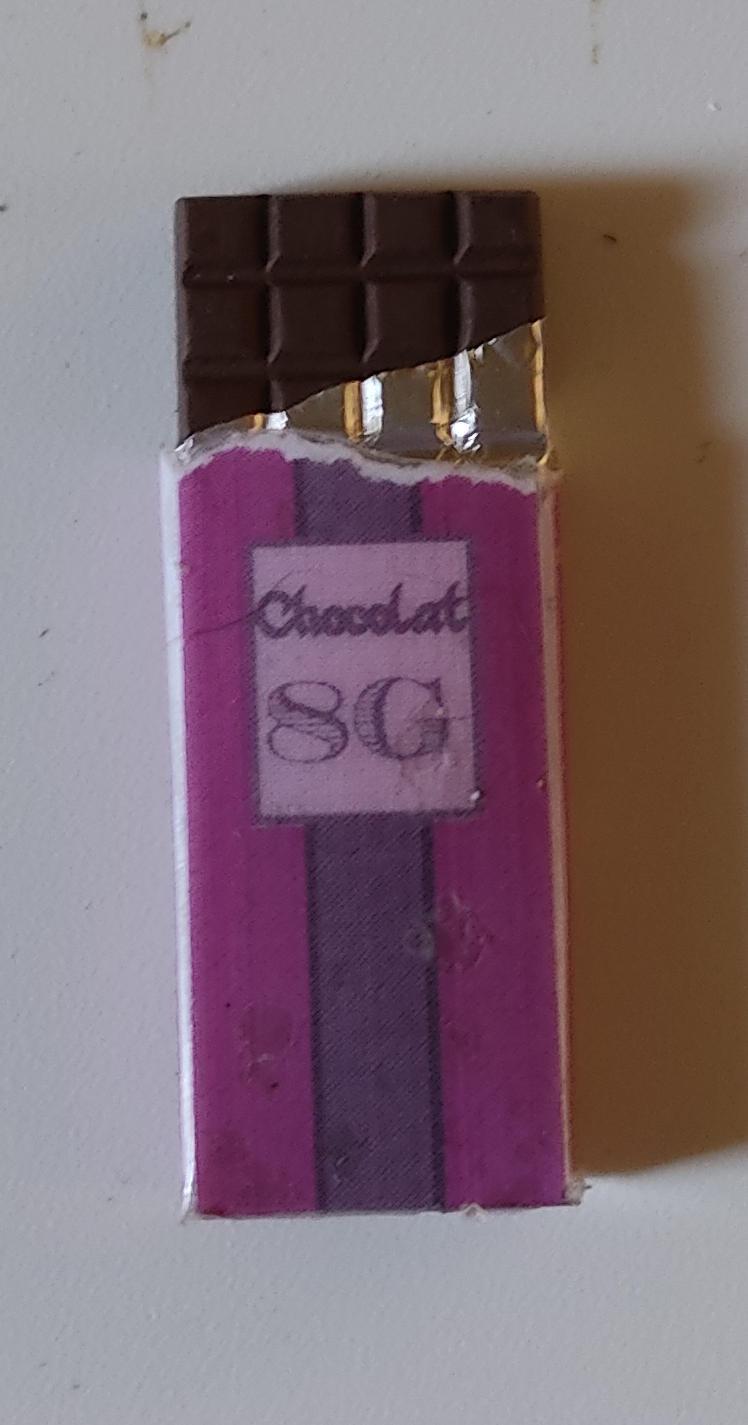

Introduction: Chocolate USB Keyring
With this insctructable, I will show you how to revamp a USB key to a more appetizing tiny chocolate tablet key ring on a budget.

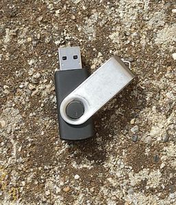

  • A USB key. The easy to dismantle kind is better than the other kinds as you will need to get its guts without damaging it.

Step 1: Dismantle USB Key
With the king of USB key I chose, dismantling is quite simple :
  • Remove the metal part by bending it.
  • The two plastic parts that protect the circuit can be separated easily using a screwdriver.

You can download the provided SVG (vector image) to print it or draw your own design. You basically need a 3D rectangle with one missing face. Dimensions are :
  • Length : 45 mm
  • Width : 20 mm
  • thickness : 6 mm
Cut the packing using scissors or cutter, except the parts where the missing side should be. Rip this side for a more realistic look : who ever use scissors to open a chocolate wafer ?
Don't forget to let some margins to ease gluing.
Either you have a laminator or you can use transparent tape to solidify and protect the packing.
Bend the packing over the wafer and use transparent tape to glue it tight around the wafer. If it's too loose, you will lose it very quickly.
Step 6: Paint
Paint your wafer. I suggest a chocolate color, but everybody is free, after all.
Let dry, then varnish.
Step 7: Aluminum Foil
For the same reason that you ripped the packing, the foil will not be cut in a straight line.
Use a sculpting tool or a plastic ruler to shape the foil on the wafer, then glue (with PVA) the foil on the top of the wafer.
Use a small paintbrush to spread out the glue on the aluminum and finish gluing it.
Cut the overlapping foil to "free" the USB plug.

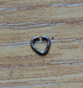

Step 8: Attach to Ring
Dig a hole in one of wafer corner using a small drill.
Reshape the attachment ring if needed from round to triangle and plug each end inside one opening of the hole.
You're done.
You now have a unique USB key for chocolate lovers !
