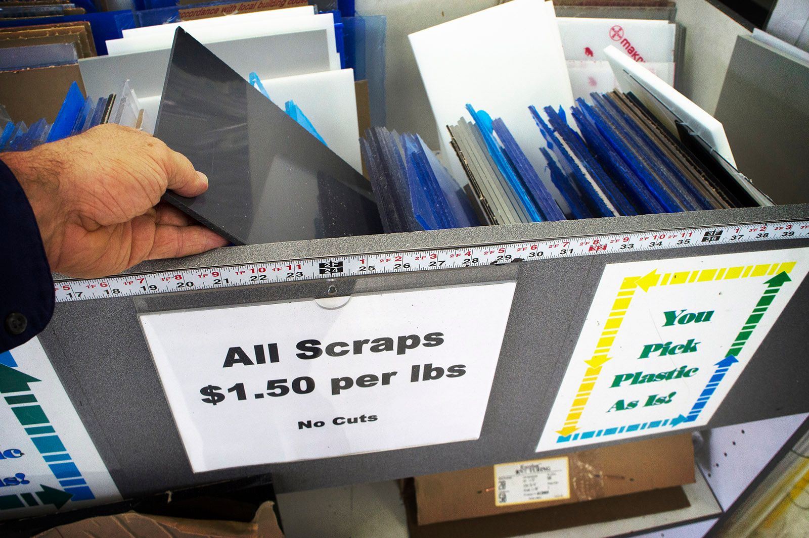

Step 2: When You Go to Your Local Plastics Store, Raid the Scrap Bin!
If you're saving something from landfill, you can argue it's "ecologically free". Don't get too self-righteous about this, but it's a pretty good rule of thumb.
Also, pulling a material from the scrap bin doesn't reduce any bad health effects the material might have on you!

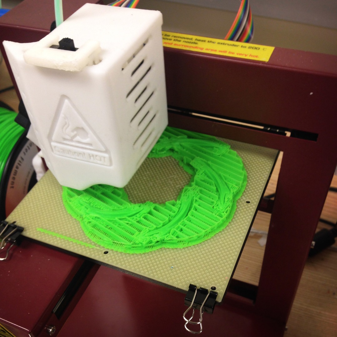

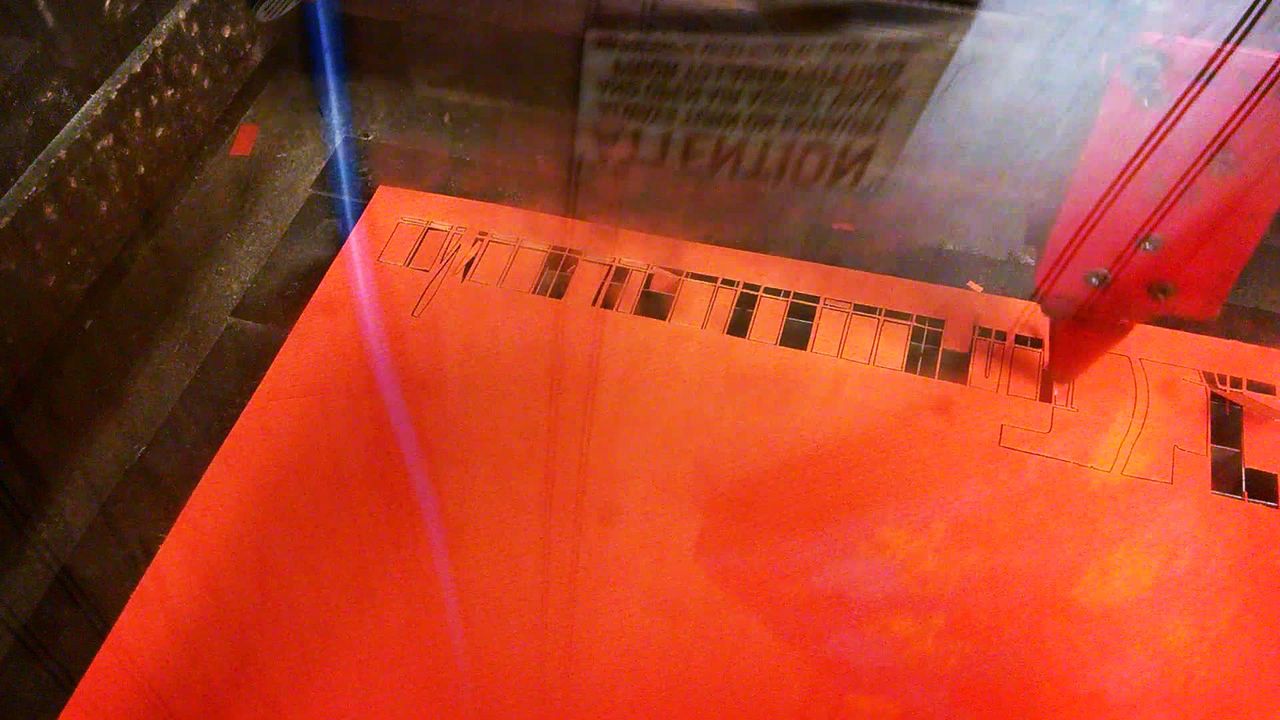

If you're laser-cutting, FDM 3D-printing, or otherwise melting the plastic, you might be exposing yourself to burning plastic fumes. These fumes are basically always toxic, but some plastics aren't that big a deal, while others are truly nasty. Some melted or burned plastics release things like dioxins, hydrogen chloride, hydrogen bromide, formaldehyde, phosgene, particulates, and more. You won't drop dead from the tiny amounts you'd breathe while laser-cutting, unless you're doing things horribly wrong, but it's somewhat bad for you (and those around you) in the long run.
More toxic plastics are PVC, ABS, PC (polycarbonate), and PS (polystyrene). PVC is usually singled out as the worst. Less toxic plastics are polypropylene (PP), polyethylene (PE, PET, LDPE, HPDE, and UHMW, and Mylar), acrylic (also known as Plexiglass, Lucite, or PMMA), silicone, and PLA (a bio-plastic). PLA is usually seen as the best, along with some other bio-plastics.

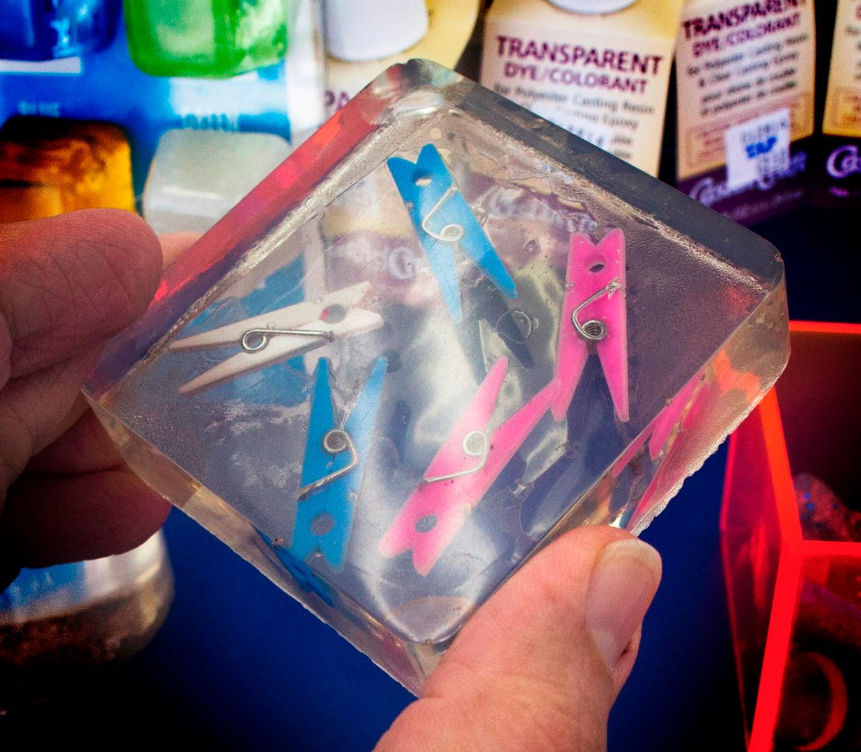

If you're casting things IN clear plastic, acrylic is the default at most plastics stores. This is a slightly different version of acrylic than the sheets you'd laser-cut or heat-form, but both are fairly low-risk. When you mix up the two resins, you'll be exposing yourself to some bad fumes even though you're not melting anything, but they're less toxic fumes than most epoxies give off.

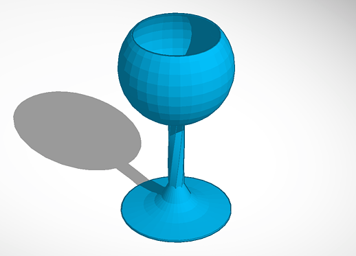

If you're eating or drinking out of the thing you'll make, definitely choose polyethylene, polypropylene, acrylic, silicone, or PLA. Those are what commercial food and drink packaging is made out of, from milk jugs (LDPE) to 2-liter bottles (PET) to heat-resistant spatulas (silicone) to compostable party cups (PLA). Here's a 3D-printed wine glass made of PLA!

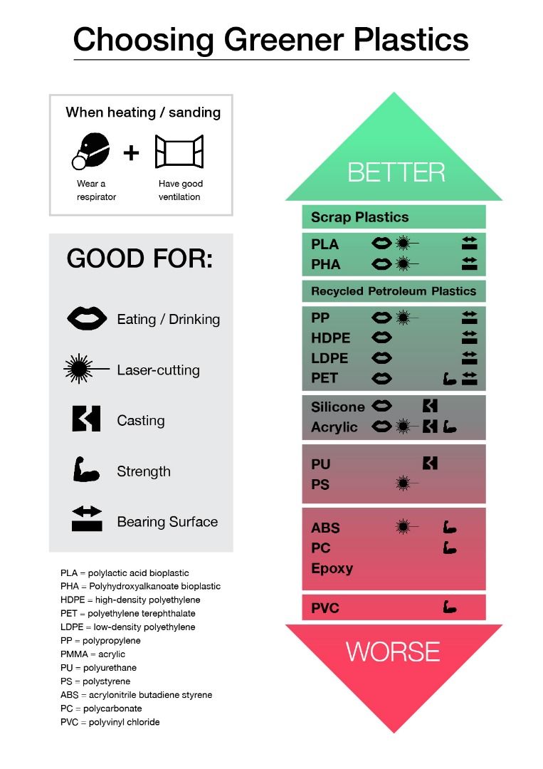

Here's another chooser chart, combining recommendations from the Healthy Building Network and someacademicsources. You can also download a quality PDF of this chart below.

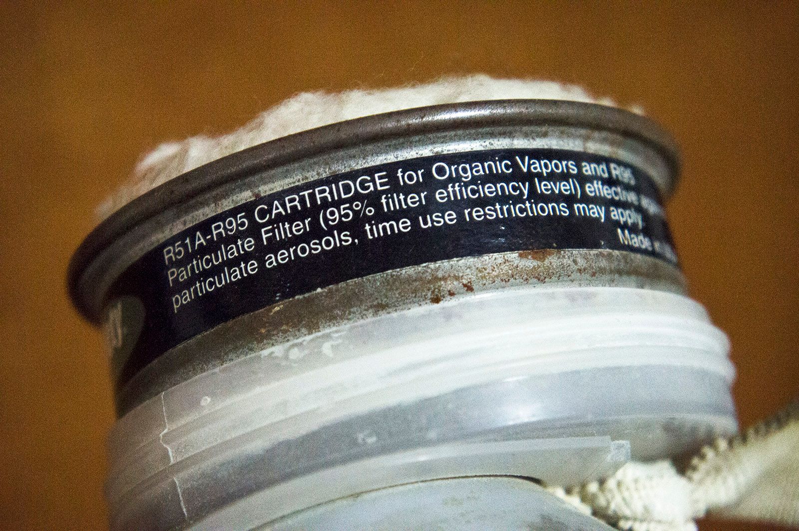

When you laser cut, 3D print, heat form, sand, or otherwise mess around with plastics, try to avoid breathing it in. Even the greener plastics here aren't good for you to breathe, they're just less bad for you, and anytime you have chemical unknowns, it's better safe than sorry. Things that seem fine now could mean cancer ten years later, so be smart and keep your air clean by using good ventilation, an air purifier, and/or wear a respirator.
I'm smiling in this picture, really.
For an air purifier or respirator, read the packaging to see what the filter is rated for. Choose one that's rated for organic chemicals and particulates. A simple home dust mask or bedroom air purifier doesn't cut it.
