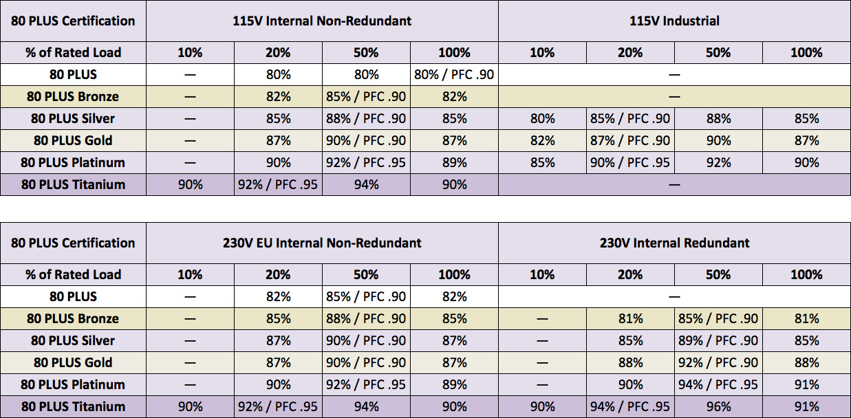

So how efficient can your power supply get? You might guess the name "80 Plus" means 80% efficient or more, and you're right. They have six levels of certification, though, so it gets better! Their top level, "titanium", is 90%+ efficient all across all wattage loads, and 94%+ efficient in its mid-range of power load.
(Above) Chart adapted by permission from plugloadsolutions.com
If you care about power factor, 80 Plus units will also help you—all certification levels require a power factor of .9 or more, and some require .95 for some load levels.
The 80 Plus website (PlugLoadSolutions.com has a list of what manufacturers have units certified to what level, but they don't have direct links for you to buy them. So use whatever retailers or wholesalers you use now. On NewEgg you can filter your search list by various levels of 80 Plus certification!

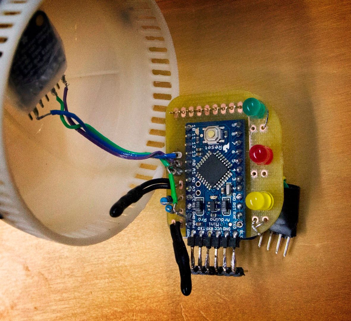

To make standby power hardware, just make two separate circuits: one for the whole device operating, and one for the absolute minimum set of components that you need to "wake up" the rest of the system from your desired input (like an IR remote control, Bluetooth proximity, HTTP request, etc.). These can be on the same board, and often use the same power supply, as your main circuit.
(Above) Arduino Mini in a circuit to turn on/off high-power-draw components based on three possible inputs: an HTTP request from the WiFi shield (on the back where you can't see it), a temperature signal, or a tilt of the accelerometer.
You might need to get redundant with some of your hardware to do this (like having an Arduino with a WiFi shield to listen for HTTP requests to wake up your 300-watt computer for remote access). But if you're building all the circuitry from scratch, you shouldn't have to. If you do need redundant circuitry, then it only becomes worth it (both in terms of your effort and the environmental impact) at slightly higher power drains. Maybe 200-500 Wh/day. (It'll depend completely on how much redundant hardware you need, of course, and the lifetime of the device, so this is a wild guess. But consider it a decent order of magnitude.)

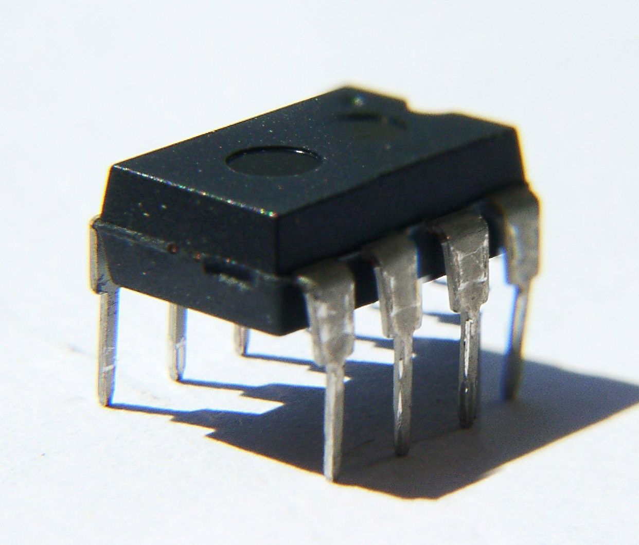

Depending on what you're making, there're even some great chips that handle standby power control for you. Two good makers are Power Integrations and Infineon.
(Above image: adapted from “PIC16F84 microcontroller in DIP.” Author: Wollschaf, Source link, Licensed under the Creative Commons Attribution-Share Alike 3.0 Unported license: CC BY-SA 3.0 Permission is granted to copy, distribute and/or modify this document under the terms of the GNU Free Documentation License, Version 1.2 or any later version published by the Free Software Foundation; with no Invariant Sections, no Front-Cover Texts, and no Back-Cover Texts. A copy of the license is included in the section entitled GNU Free Documentation License.

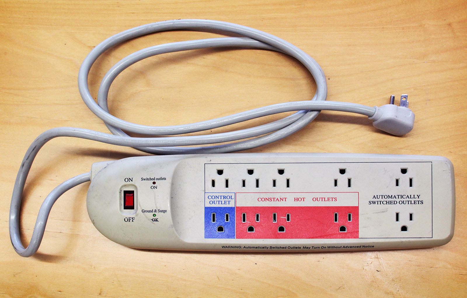

If extra circuitry seems too hard or laborious to you, or you're using off-the-shelf parts you don't want to hack, you can also just buy a "smart outlet" or "standby power controller" off the shelf, and plug your device into it.
A quick web search will show you dozens of companies, with power outlets you can turn on/off by schedule, web interface, phone interface, GPS proximity, motion sensing, the power draw of a different "master" device, and any number of other things. Have fun with it!
