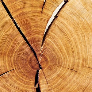

Introduction: Choosing Greener Wood
Wood is a beautiful material to make things with. By choosing greener wood for your project, you can keep the Earth beautiful too. How do you choose sustainable wood?
Wood can be a fantastically "green" material, but it can be horribly bad, too. It's mostly a question of growing trees back as fast as they are harvested, because unlike food farms, tree farms and natural forests usually aren't dosed with much chemical fertilizers and pesticides. Of course, the way trees are harvested (clear-cuts vs. selective cutting) and the social impacts on the workers and local people are also important. Certified-sustainably-grown wood can do all these things.
For plywood, particleboard, and other composites, the toxicity of the glue is also important to your own health.
Of course, the wood has to physically stand up to your usage too, so you need to think about the strength, rot resistance, or other qualities you need for the stuff you make to last.
Here's a step-by-step guide to choosing "greener" wood!
(Above image: adapted/ cropped from "Slice from oak tree, about 400 years old, from Soling, Germany, sampled for tree ring chronology" Author: Hgrobe, Source link, Licensed under Creative Commons Attribution-ShareAlike 3.0 Unported: CC BY-SA 3.0)

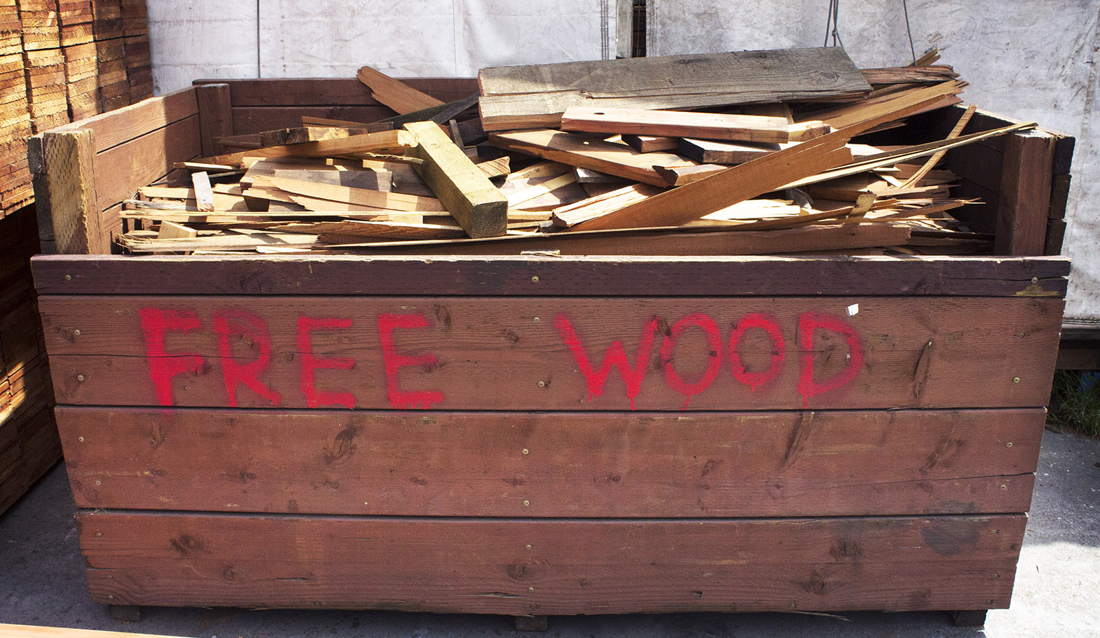

Step 1: Raid the Scrap Bins!
The most sustainable wood is the wood that never felled a tree—there's a lot of it just sitting around. Many lumber stores have it for cheap, or even free! Local woodworking shops might have scraps of very fancy wood they're just throwing away. If you keep your own scraps when you're woodworking, you'll accumulate your own useful pile.

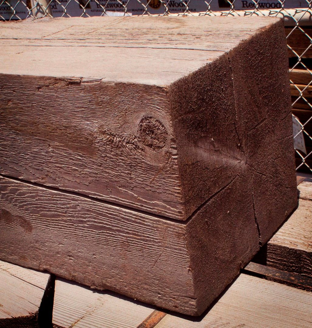

Sometimes you can even get great wabi-sabi aesthetics from using old weathered wood reclaimed from buildings, railroads, or other places. You can also sometimes find giant timbers that'd be super-expensive new. Though be careful for embedded nails or other safety hazards! This's a giant 12"x12" reclaimed timber:

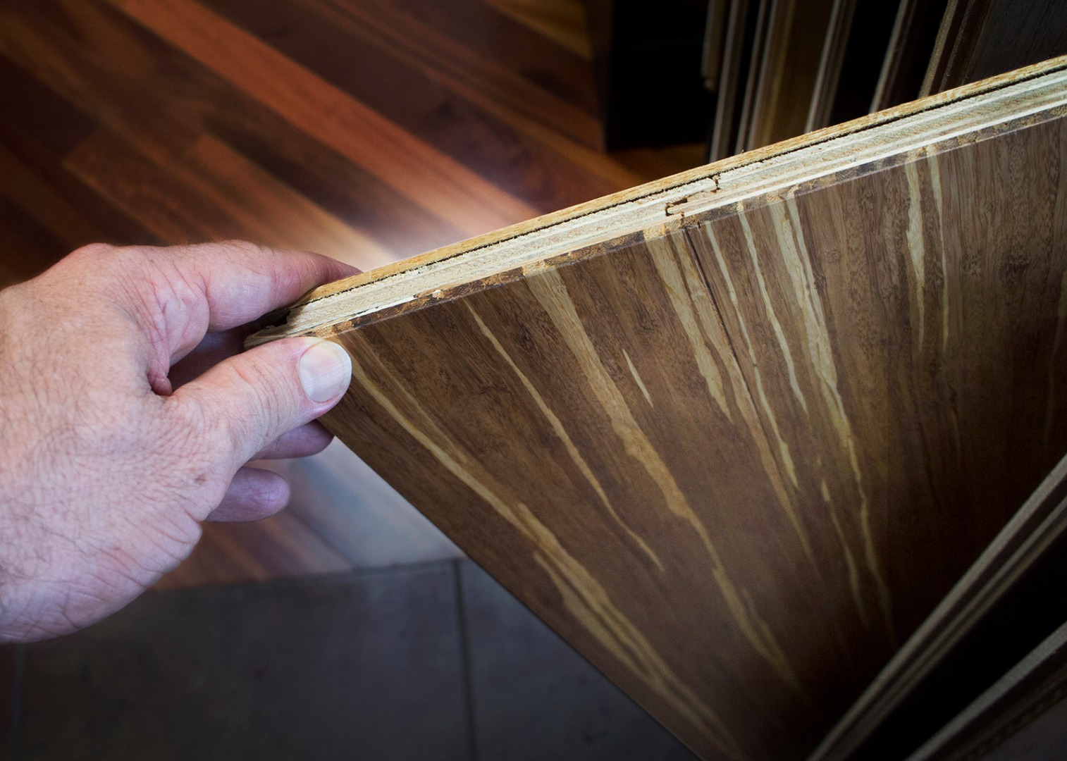

They say "the grass is greener…" In the case of bamboo lumber, they're right, because bamboo is a grass, so harvesting it is a little more like mowing a lawn than cutting down a tree—the plant is still alive and will regrow. Bamboo also grows really fast.

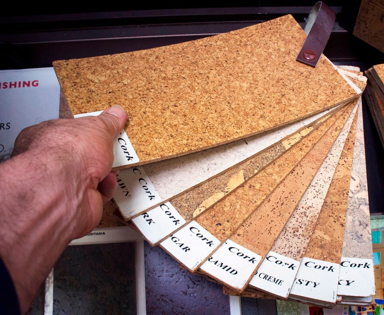

Cork is another rapidly-renewable wood. It's a proper tree, unlike bamboo, but harvesters don't cut down the tree, they just skin the bark and it regrows, allowing several harvests before a new tree has to be planted. It's not very structural, but it's more water-resistant and sound-absorbent than most wood.

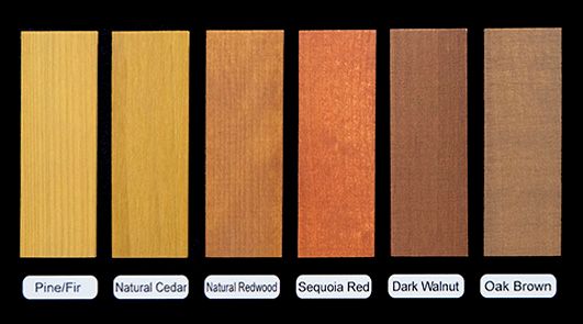

If you want a particular wood because of its look, remember that a good stain can radically transform the look of a wood—not only color, but grain. It's easier to find a healthy stain than it is to find sustainably-harvested tropical hardwoods.

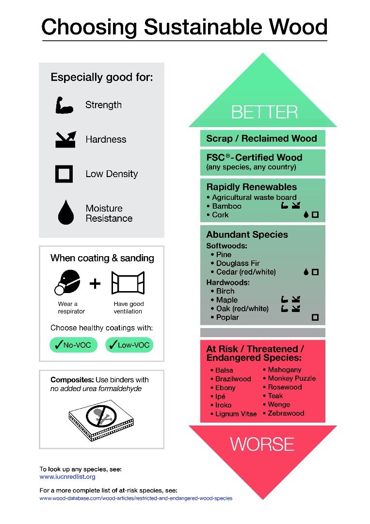

Here's a little chooser chart to help you choose more sustainable wood. You can also download a quality PDF of the chart below.

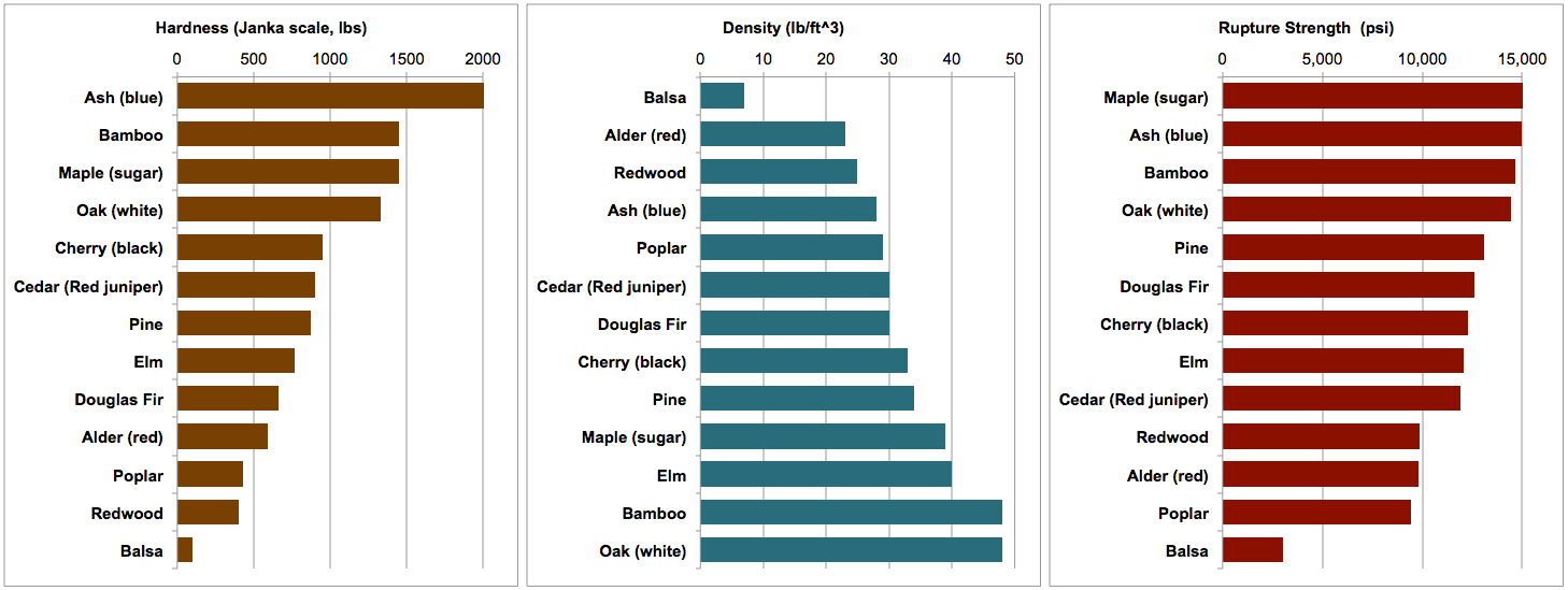

If you're advanced, though, and engineering properties are important to you, here are three graphs ranking common woods by hardness, density, and rupture strength. People make a big deal of the difference between hardwoods and softwoods, but these categories don't always determine which species score better, and bamboo technically isn't in either category.
Note that freshly cut ("green") wood is weaker than properly-dried wood, sometimes by quite a bit. It's also heavier, because water is denser than cellulose. However, "green" wood is more flexible, and thus tougher (more crack-resistant) than dry wood. That could be useful for you, particularly if you're bending it.

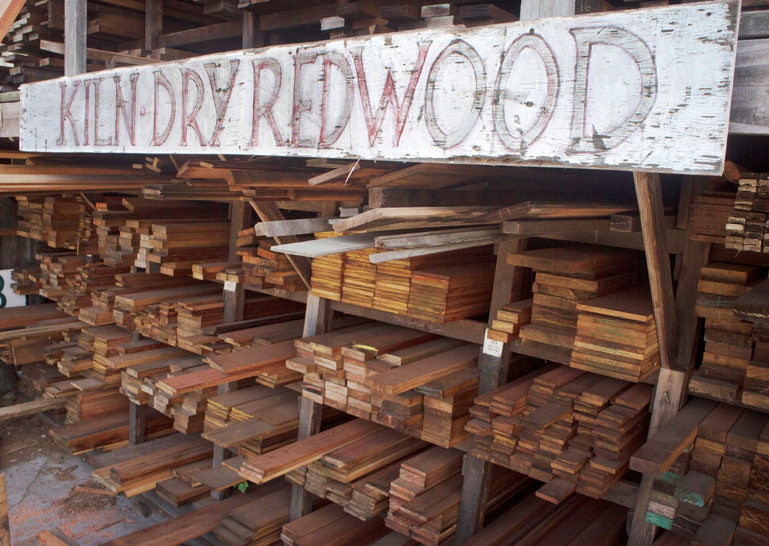

Or you can just buy wood that's naturally resistant to rot, mold, and bugs. For instance, western red cedar and redwood. Much easier for us non-chemists! Some rare tropical hardwoods also have great weather resistance (like teak and ipé), but it's still best to avoid those unless you're sure your project will be used for a long time (decades!) to make it worth it.
