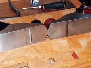

Having access to all the sizes of planes is certainly not essential, and depending on your woodworking, you can even get away with just one or two. So, as a first-time buyer, which one should you choose? A jointer, try or fore plane are all unlikely candidates, as their lengths are too much to be of use in general terms. The most obvious plane to begin with is the No.5 or No.5 1⁄2 the jack plane.
As its name suggests, it's a Jack of all trades and suited to a wide range of tasks: it can be used for some straightening, initial preparation, and final finishing work.
The No.5 1⁄2 differs from the No.5 in having an iron that's heavier and wider by 3⁄8in, and in my opinion that extra width makes all the difference. For one thing, it means it will sit on the work better when cleaning up a planked tabletop. Meanwhile, the No.5 could be seen as the better option for initial flattening of stock prior to truing up with a longer plane: it weighs less, and so requires less effort to drive it.

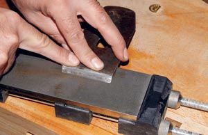

Any minor irregularities can be flattened on the underside of the frog with a sharpening stone. If you can track them down, then, older irons are the ones to have, as their steel tends to be of a better quality, and their extra thickness is a benefit, too. You'll find it difficult to buy one that isn't already fitted to a plane, and those that are for sale on their own are likely to be getting close to the end of their lifespan. You also need to check carefully that the replacement iron will fi t your plane, as the shape of the holes in the cap iron can vary from plane to plane, and some judicious fi ling of the mouth might be needed if the blade sits too far forwards and closes down the mouth too much. Buying a new iron is probably the easiest option, then, and while quality steel irons from the likes of Hock, Clifton and Lie Nielsen may cost almost as much as your plane itself, the price is usually justified by the increased performance of the tool.

The cap iron can be sharpened on the stone so that it fits tightly with the cutting iron Your new bench plane iron will come ground square; to get the best out of it there are some variations that you can introduce to its profile. You can, for instance, round off the corners to stop it leaving marks in the surface as it cuts. Alternatively, you can give it a curved profile which, when fitted in a jack plane, will quickly flatten high spots in much the same way as a scrub but without producing the pronounced U-shape trough.
For the smoother and the jointer, the iron is usually kept either square with the corners eased, or with a very shallow curve, so that it doesn't leave a pronounced scallop that only leads to more work. I prefer a very slightly rounded profile, as this feathers the shavings on the edges when set for a full-width cut, though the effect is almost unnoticeable.

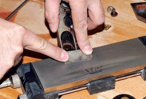

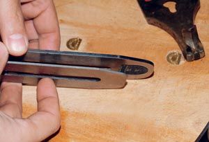

Our next port of call is the cap iron, whose tip must sit tightly on top of the cutting iron. This fit allows the cap iron to curl the shavings away from the cutting edge; even a slight gap will allow shavings to become caught and cause a jam in the mouth. Running the tip of the cap iron along an oil stone will soon flatten it, and you can check the fit by reassembling it with the cutting iron and offering them up to a light source; a sliver of light means another tickle on the stone is indicated. You need to make sure that there is no wire edge left on the back of the cap iron, though I tend not to polish the back unless it has a really rough finish to it.
When adjusting the cap iron, remember that the amount of backset will affect the cut: the further back from the edge of the cutting iron, the coarser the cut.

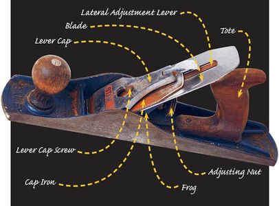

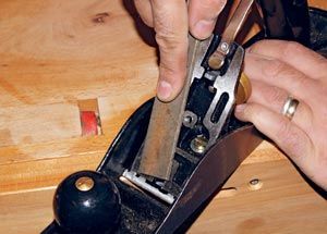

Even if your irons meet without a glimmer of light, the plane can still struggle to cut well if the iron and frog aren't working together. If the iron doesn't seat correctly, or the frog isn't bedded down or in the correct position, then you'll experience chattering and skittering as you try to cut.
The trick, then, is to remove the frog and check the meeting surfaces to ensure that they're not being held apart by the odd glob of enamel or an area of rough casting; scraping and light filing should be enough to rectify these problems. Sadly, modern mass-produced planes aren't as well-engineered as the older ones, whose larger bearing surfaces and superior machining produced better performing planes.
The face of the frog should be checked with a small straight edge which will indicate if there are any high spots that need to be relieved with a fine flat file. When refitting the frog, it's important that the frog is seated in a position that's not so far back as to prevent the irons bedding properly. You should fit the irons, then, and check how the frog sits in relation to the mouth of the plane.
Shunting the frog forwards closes the mouth down so the finish and shavings are finer, but if it's too far forwards the end of the iron can lack support and become prone to chatter; thicker irons don't suffer from this problem so much. Although the frog is there to be used, it's very unusual that I'll alter it once I've set it. This is mainly because the standard Bailey pattern planes need to be partly stripped in order to make adjustments, though if I were using a Bedrock style plane, whose design allows frog adjustments to be made with the plane assembled, I'd be more far more inclined to make alterations.

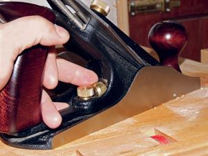

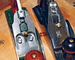

Of course, the grip of the plane can be part of getting the most out of the tool, and the Stanley type knobs and totes even the plastic ones (cue sound of hawking and spitting) feel very comfortable. The totes on Veritas planes, meanwhile, for all that they're high quality tools, always feel a little square to me. But, we're not woodworkers for nothing, and it's easy enough to adapt the handles to suit our own preferences. Alternatively, you can buy sets of knobs and totes for Stanley planes to replace any missing or broken ones.
The whole frog assembly moves as one by adjusting this small wheel on the Veritas frog

The unique Veritas frog (left) has a small cast foot that slides along to close the aperture.
TIP: For general planing, pressure should be applied at the front of the plane at the start of a cut, using the rear hand to steer it. Only towards the end of the cut, apply pressure to the rear and ease off the front; doing the reverse can result in the plane making the jointed edge slightly convex. Get into a rhythm, and walk through the cut so it's flowing with an even pressure throughout. Transferring the weight through the plane as the cut starts and finishes should help achieve consistent results.

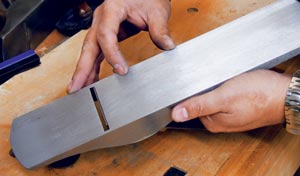

Performing the simple tasks I've described should lift your plane to a new level of performance. If you're still having problems, though, you might have to shift your attention to the body's casting. Providing that it's actually fit for something more than holding your door open, there are ways to fettle it, though I warn you now, when it comes to getting a plane to work, flattening the sole is likely to be the most controversial topic.
I don't sit in the 'check for flat and fettle' camp, and see little point in unnecessary labour. I prefer to try a plane first and only do work if it doesn't perform. The thing to remember is that a plane doesn't necessarily need to be entirely flat. The crucial registration points are the front and rear of the sole, and just in front and behind the mouth; if these are in the same plane and have no twist, you can discount any slight hollows. For general carpentry, joinery and some furniture-making, then, the standard bench planes should hopefully be good enough to perform at the levels required.
It's only when I've exhausted the easier tuning methods and still find that a plane won't take a uniform shaving that I will delve deeper. It is possible, for example, that a plane that started its life true can move over time, as cast iron is prone to distortion (This is part of the reason, by the way, why cast iron was traditionally left to settle before final machining). Before you commit to surgery, however, you should be sure that you understand the mechanics of planing, and that it's the plane and not you that needs the work.

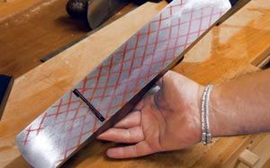

If you do need to resort to flattening your plane then, put engineer's blue or a series of cross-hatched lines made with a permanent marker on the sole, and pass the plane over a piece of abrasive on a dead fl at surface to reveal the hollows and high spots. A suitable surface can be made from a thick piece of fl oat glass stuck to a stable surface like MDF. A 19mm MDF backer, for instance, with 6mm glass on top is the minimum, but 10 or 12mm glass is much better if you can get it. You can also use the bed of a saw or planer, but again, this needs to be checked for true or you'll simply introduce more problems.
It's important that the frog, cap iron assembly (with the blade retracted) and lever cap remain in place during this process as they affect the tension of the casting. If they're removed during lapping, the casting may change shape, which will defeat the object of the whole exercise.
To lap the sole, you can use standard abrasives stuck down with spray adhesive, though engine valve grinding paste will do a similar job. Be warned though, this can cut very quickly, so don't be overly enthusiastic on the initial lapping when using a coarser grit! A light touch and running through the grits is all that's required when lapping. Shorter planes should be held over the frog as holding the knob and tote can lead to a slight increase in pressure at the front and rear of the tool and the removal of a fraction more metal.
If the sole is really bad, it may need surface grinding at an engineering shop, but care is needed not to remove too much meat as this will open up the mouth and the finer frog settings will be lost.
