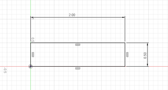

Create a rectangle sketch on the top plane with dimensions 2 in. by 1 in.

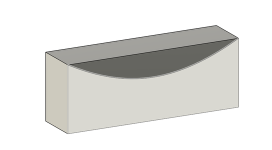

Create a sketch on the side of the extruded shape. Create a curved path by using the line tool.
Step 4:
Split extruded object and select the path we just created as the Splitting Tool.
Step 5:
Remove the upper object.

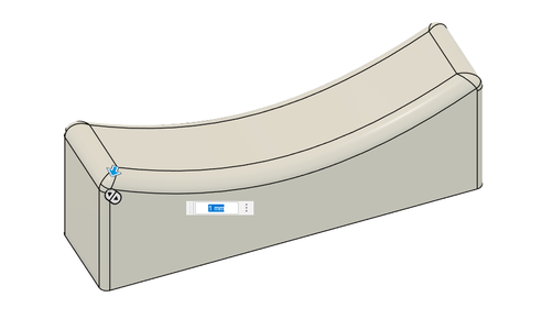

Fillet the 2 curved edges and the 2 edges on the top of each rectangle by 2mm.
Step 7:
Fillet the side edges of the rectangles by 1mm.

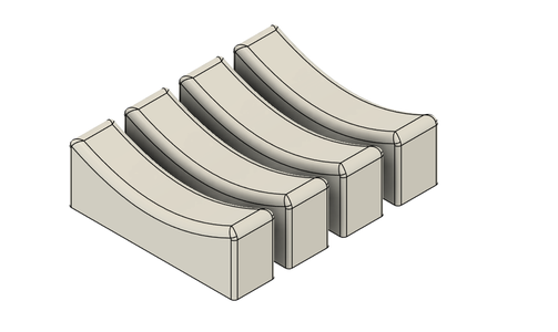

Step 8: Final Product

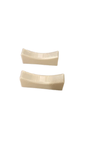

Your final product should look something like this. I've duplicated my design a few times but this isn't necessary.
Step 9: Usage
To utilize this device effectively, position the chopstick holder on a stable surface and rest two chopsticks on it, ensuring that the heads of both chopsticks make contact with the holder. Regardless of their initial placement, the chopsticks will naturally gravitate toward the center of the holder due to its design.
