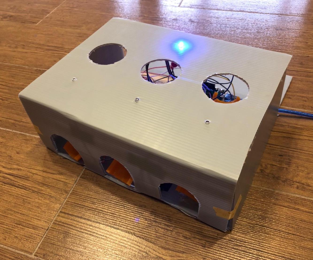

Step 1: Put All the Components in Place
1.Prepare all the supplies
2.Put them in place as the image above
Step 2: Type the Computer Programs
1.void setup(){ // put your setup code here, to run once:
Serial.begin(9600); // opens serial port, sets data rate to 9600 bps pinMode( 9 , OUTPUT); // sets the digital pin as output pinMode( 6 , OUTPUT); // sets the digital pin as output pinMode( 7 , OUTPUT); // sets the digital pin as output pinMode( 2 , OUTPUT); // sets the digital pin as output pinMode( 4 , OUTPUT); // sets the digital pin as output pinMode( 12 , OUTPUT); // sets the digital pin as output _color = random( 0 , 3 ) ;
void loop(){ // put your main code here, to run repeatedly: Serial.print(_color); //print message Serial.print(" "); //print a blank Serial.println(); if ( _color == 0 ) { digitalWrite( 9 , HIGH ); // sets the digital pin on/off a(); } if ( _color == 1 ) { digitalWrite( 6 , HIGH ); // sets the digital pin on/off b(); } if ( _color == 2 ) { digitalWrite( 7 , HIGH ); // sets the digital pin on/off c(); } }
void b() { //customised function if ( analogRead( A5 ) < 555 ) { digitalWrite( 2 , HIGH ); // sets the digital pin on/off delay( 1000 ); // waits a few milliseconds digitalWrite( 6 , LOW ); // sets the digital pin on/off _color = random( 0 , 3 ) ; } else { digitalWrite( 2 , LOW ); // sets the digital pin on/off digitalWrite( 4 , LOW ); // sets the digital pin on/off digitalWrite( 9 , LOW ); // sets the digital pin on/off digitalWrite( 12 , LOW ); // sets the digital pin on/off } }
void c() { //customised function if ( analogRead( A4 ) < 555 ) { digitalWrite( 4 , HIGH ); // sets the digital pin on/off delay( 1000 ); // waits a few milliseconds digitalWrite( 7 , LOW ); // sets the digital pin on/off _color = random( 0 , 3 ) ; } else { digitalWrite( 2 , LOW ); // sets the digital pin on/off digitalWrite( 4 , LOW ); // sets the digital pin on/off digitalWrite( 7 , LOW ); // sets the digital pin on/off digitalWrite( 12 , LOW ); // sets the digital pin on/off } }
void a() { //customised function if ( analogRead( A0 ) < 555 ) { digitalWrite( 12 , HIGH ); // sets the digital pin on/off delay( 1000 ); // waits a few milliseconds digitalWrite( 9 , LOW ); // sets the digital pin on/off _color = random( 0 , 3 ) ; } else { digitalWrite( 2 , LOW ); // sets the digital pin on/off digitalWrite( 4 , LOW ); // sets the digital pin on/off digitalWrite( 6 , LOW ); // sets the digital pin on/off digitalWrite( 12 , LOW ); // sets the digital pin on/off } }
void s() { //customised function if ( analogRead( A4 ) < 555 ) { digitalWrite( 4 , HIGH ); // sets the digital pin on/off delay( 1000 ); // waits a few milliseconds _color = random( 0 , 3 ) ; } else { digitalWrite( 4 , LOW ); // sets the digital pin on/off digitalWrite( 12 , LOW ); // sets the digital pin on/off digitalWrite( 2 , LOW ); // sets the digital pin on/off digitalWrite( 7 , LOW ); // sets the digital pin on/off } }
2.int UltrasonicSensorCM(int trigPin, int echoPin) //Ultrasonic Sensor Code Auto Generated Return CM max distance 200
{ long duration; pinMode(trigPin, OUTPUT); pinMode(echoPin, INPUT); digitalWrite(trigPin, LOW); delayMicroseconds(2); digitalWrite(trigPin, HIGH); delayMicroseconds(20); digitalWrite(trigPin, LOW); duration = pulseIn(echoPin, HIGH); duration = duration / 59; if ((duration < 2) || (duration > 200)) return false; return duration; }
void setup(){ // put your setup code here, to run once: digitalWrite( 6 , LOW ); //set ultrasonic sensor trigPin
pinMode( 11 , OUTPUT); // sets the digital pin as output pinMode( 13 , OUTPUT); // sets the digital pin as output }
void loop(){ // put your main code here, to run repeatedly: if ( UltrasonicSensorCM( 6 , 7 ) < 2 ) { digitalWrite( 11 , HIGH ); // sets the digital pin on/off delay( 10 ); // waits a few milliseconds digitalWrite( 13 , HIGH ); // sets the digital pin on/off } else { digitalWrite( 11 , LOW ); // sets the digital pin on/off digitalWrite( 13 , LOW ); // sets the digital pin on/off } }
Step 3: Set Up the Game
1. Cut necessary holes
2. put the wooden sticks in place
3. REMEMBER to make holes for the USB-B transfer line to go pass
Step 4: Decorate the Appearance and Start the Game!
