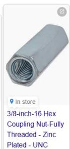

At this point, you want to secure the threaded insert into the tap handle.
  1. I found a nut in my garage that fit on the beer tower's threaded end, then found a bolt that fit, took it to home depot and matched it to the insert.
  2. screw the insert all the way down onto the threaded end of the beer tower. Ensure it's snugly to the bottom. You want to ensure it can't turn any more because when you epoxy the tap handle on facing forward, it'll come out corrked later if the insert can screw on more.
  3. protect everything below the threaded part of the beer tower. You'll be using 2 part epoxy and getting it off the beer tower will be a problem!
  4. mix up the 2 part epoxy and spread it into the hole on the tap handle. You shouldn't need a ton, but enough to ensure the metal and wood bond together
  5. Slide the tap handle onto the insert and ensure it's straight. Once the epoxy dries, there's no adjustment.
