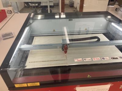

Step 2: Laser Cut Materials
Using a Trotec laser cutter, we cut out the pieces of our box according to our dimensions. All of the pieces were cut out of ⅛” birch plywood; however, the top was cut out of cardboard. We made this decision so that the motors could easily lift open the lid's weight.

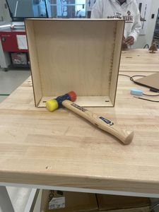

Step 3: Piece Together the Box
Carefully connect the pieces of the box together. We used a mallet to make sure everything fit tight. Use hot glue around the corners for further strength.

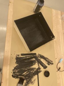

Step 4: Paint the Box and Popsicle Sticks
Paint even coats of black paint on the box and popsicle sticks until they are opaque. We intentionally chose to use the colors black and red because many of the students have visual impairments. These colors are easily differentiated from one another.

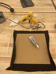

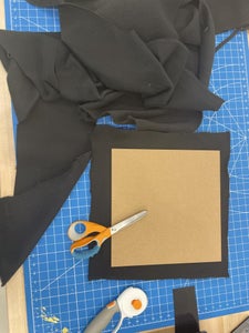

Step 5: Attach Black Felt Pieces to the Box
Cut the felt into pieces of size using fabric scissors. Next, carefully hot glue the pieces securely to the box. When choosing our material, the decision to use felt was intentional. Felt is a good sensory material that we thought the students would appreciate.

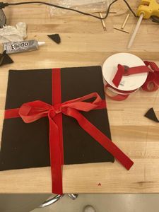

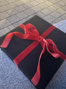

Step 6: Attach Ribbon to the Box
We wrapped the ribbon on the top of the box so that it looks like a Christmas present. Continuing the pattern, we then used hot glue to attach little strips to the side.

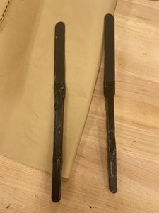

Step 7: Make the Lever
Take the painted popsicle sticks and stack them together to create a lever long and sturdy enough for your box. We ended up only needing one lever but it can be helpful to have a backup. We used duct tape to secure everything.

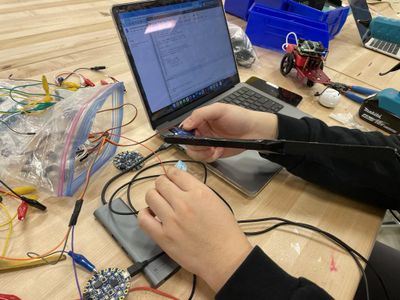

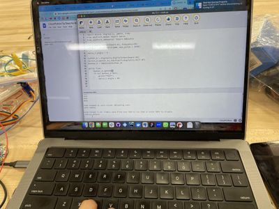

Step 9: Code the Box
We coded in Mu using Circuit Python. Attached to this step is our code.

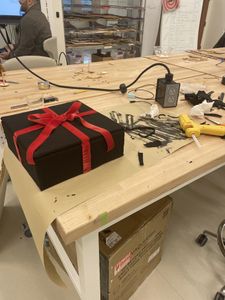

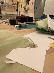

Step 10: Decorate and Enjoy
Decorate the box to your liking! We added a battery-pack strip of snowflake LEDs lights and a CVI Christmas tree made out of tissue paper and vinyl.
This box is for multipurpose use. The Campus School plans to have a student control it so that they can give out candy to visitors at their Christmas Fair.
