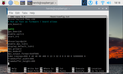

Enable external screen (again, this step is only if you use a GPIO interface for your screen)
Open a new terminal window and enter the following command
sudo nano /boot/config.txt
Scroll all the way to the bottom and paste the following lines.
dtoverlay=dpi24
enable_dpi_lcd=1
display_default_lcd=1
dpi_group=2
dpi_mode=87
dpi_output_format=0x6f005
hdmi_timings=800 0 40 48 88 480 0 13 3 32 0 0 0 60 0 32000000 6
framebuffer_width=800
framebuffer_height=480
If your screen has a different resolution than 480x800 the you will need to adjust for that.
The config file should now look like picture nr 2 (at least the bottom parts).
Press Ctrl + X to exit the file and when prompted if you want to save, press Y and the Enter.

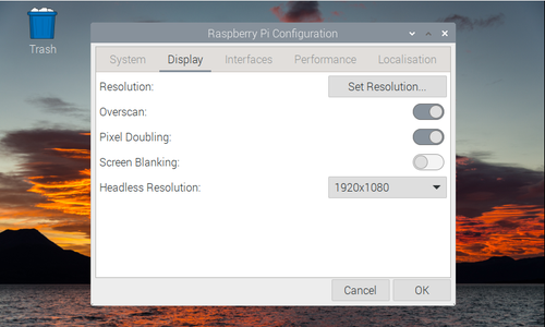

Disable screen blanking
Go the Start menu --> Preferences --> Raspberry pi configuration and then go to the Display tab.
For some reason I couldn't take screen shots while navigating the menu, sorry about that, but you want to end up at picture nr 3 and then go ahead and disable screen blanking, that will make sure that your screen doesn't go black after the pi has been idle for a while.

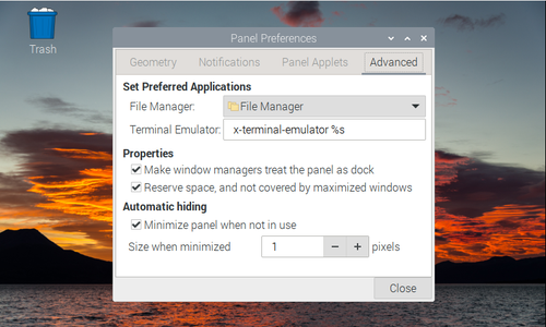

Hiding the top task bar
Hover the mouse over the task bar at the top of the screen and right click, then chose Panel settings and click the tab Advanced and then check the box Minimize panel when not in use. Set the size of the panel to as many pixels as you like, I chose 1. To be able to reach the top panel after this, hover the mouse where the panel used to be and it will reappear.
