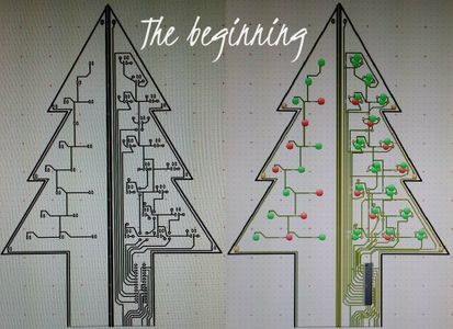

The first thing to do is to download the free software that we used to design the tree circuit, PCB Wizard. We'll put the URL for you in case you don't have it.
http://dfiles.eu/files/dtllkyi6o

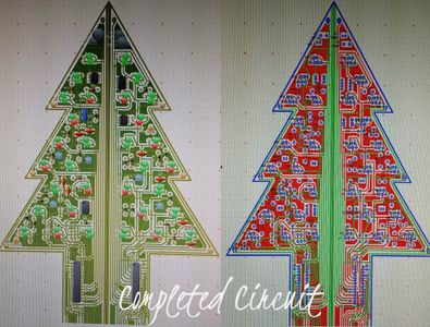

Install it. It can take a few minutes. While doing so, download the ZIP I've embedded to the step before. Once you have it, unzip the file. Inside, you'll find four PDF, two for each face. You can print it directly from there but if you want to change something, you can also use the files from PCB Wizard that we used. It's opened to changes and improvements, if you consider so.
We've also added some pictures showing the process of building the circuit. Firstly, you need to choose the size of the tree that you want to make. We made it A4 shape. Then, we put the LEDs sequence building coloured rows, one green and one red, till you get to the top of the tree. As you can see, there's no need of using resistance for each LED like normally we do. That is because we are using TLC5940 chips (http://www.ti.com/lit/ds/symlink/tlc5940.pdf). They don't need to have a resistor on each pin that leads on a LED. You can see one at the bottom of the tree, which will supply one face of the shape. On the other face, we'll put the other TLC5940 and the LEDs connected.
The second picture shows the first face we made. It is not completed yet. The next picture has the whole circuit built. We added a few random components trying to simulate the Christmas tree decoration. We used electrolytic capacitors, resistors, inductors, AOs and whichever component you want. You can use broken or burnt ones or burnt. It won't interfere on the circuit functionality if you do it right.
And, at last, we've put a picture of the circuit printed on the special paper. It's yellowy, shiny on one side and rough and rugged on the other. You must print it on the shiny one, which gets sticky when touching the water. The next step will show what to do with the yellowy paper.

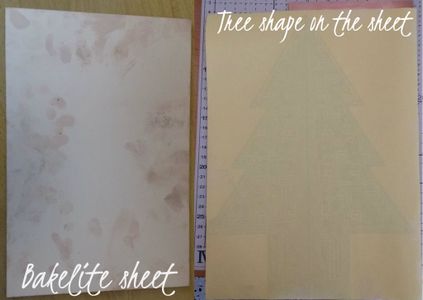

Step 2: Let's Ironing

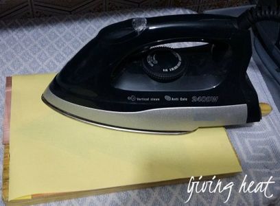

Once you have finished step 1, you can stick the tree shape on the Bakelite sheet.
You'll need an iron. It doesn't need to have water spray. You'll also need a straight platform to work on it.

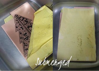

The first picture we put shows both the Bakelite sheet and the same sheet covered with the yellowy paper we made on the step before. On the second picture, you can see both faces put together. Between them we'll place the Bakelite sheet. It should look like that once you stick it on the sheet, otherwise, the wholes for inserting the components won't fit properly. Be careful with that. We had to do it twice because we didn't realise the faces weren't perfectly set. You must keep on giving heat ironing for about 10 minutes, it should be enough.
After that, carefully put the Bakelite sheet with the yellowy paper stuck on it inside a tray full of warm water. Leave it for 20 minutes. The contrast of temperature should help you later, when you take off the yellowy paper. The ink stuck to the Bakelite sheet shouldn't break. After you take off the paper, the Bakelite sheet is ready to bring out, dry and work with it on the next step.

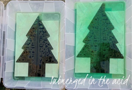

The next thing to do is to prepare the acids. What you need for the liquid is:
- Hydrogen peroxide 110º. (1/4)
- Etching. (1/4)
- Water. (2/4)
Don't forget to get the 110º, it's very important. If you want it to act faster, increase the amount of hydrogen peroxide, but not too much because it might not do its work properly. Don't exceed. Mix it all on a clean tray. You must do it on a breezy place because this liquid can be toxic if you inhale it for too long.

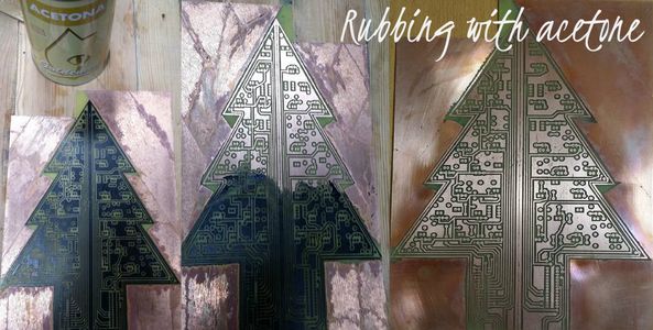

Put the sheet inside the tray carefully. We can't really tell a exact period of time to leave the Bakelite sheet inside the acids, it depends on the condition of the acid: if it's been opened for long it will take a little bit longer to eliminate the copper from the sheet but if the liquids are new it won't take that long. You should stay around checking on it till the copper is totally gone but not the copper that we need, under the paths. You'll see some bubbles coming out from the copper. Be careful and make sure it doesn't mislead on you.
After you take the sheet out and clean it from the acid, dry it. Make sure that all the paths are OK and test the connections with a multimeter. If something has gone wrong, don't worry, if it's a small thing you can fix it later putting a tin bridge or breaking the connection between paths that shouldn't be there with a cutter or a screwdriver.
Once you have the sheet cleaned and dry, you can start rubbing the useless ink. For that, we used acetone. You can find it easily on a supermarket or a chemistry. Women use it for their nails, so you might have some at home if you're living with one. The third picture shows how it was looking while we were rubbing the ink and how it should look at the end of this step.

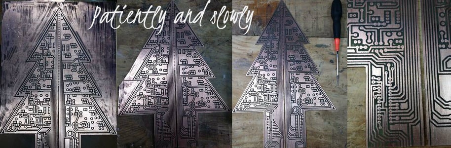

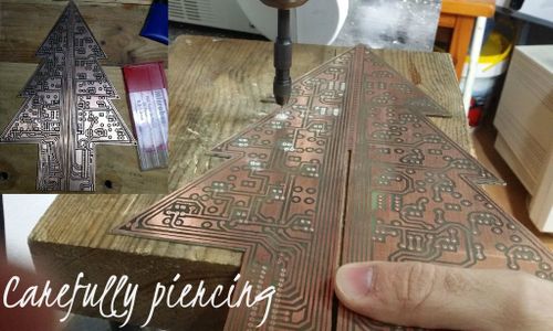

Once you have the sheet with the paths printed on it, you can start cutting the sheet to make the typical Christmas tree shape. Make sure that the sheet is properly fastened to the table. Use an automatic hacksaw if possible, it'll make it easier and faster but if you don't have any just use a manual one but mind the movements, make sure you don't miss the shape. As you can see on the first picture, the hardest part is the inside of the tree because the line is very thin.
Now that the sheet is fastened to the table you can also do the sanding part. Carefully, go all over the outside of the tree shape till it gets softer.
After that, what we recommend is to mark each hole where you'll insert the component. It will help you when you start with the drilling part. Get the drill ready and, patiently drill all the wholes of the sheet. Be very careful because they are very breakable and delicate. We had to buy a few spare ones because we broke the first one... Assume that on the budget too!. We were using a stationary drill so it was easier to make the holes straight.

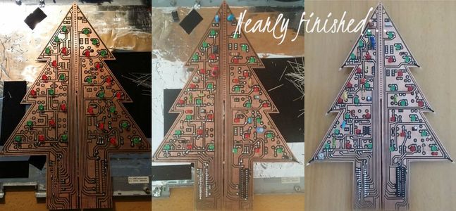

This one is the most repetitive step. You'll have to weld every component to the sheet. First, put each component on the right place, each green LED and red LED following the rows we talked about before. Also the other components for decorating the tree.
The first picture shows how we were proceeding on the welding step. We first started with the LEDs. The next picture shows how it looks with the LEDs, then with the broken components and the last piece shows the socle and the white LEDs of the outside. For those, we used the thermoretractable wires. We put it on the whiskers of the LED so that it doesn't touch any other pin or conductor. Once it's on the right place, give heat to it and it will stick to the whiskers.
That is all you have to do to get one sheet. Repeat the whole thing for the second sheet. Good luck!!

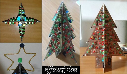

The first picture shows how we welded the groove. The last part of it shows the star we made with a small piece of soft wire. It must be a conductor because we are going to put the microphone there. In the circuit draw we left two holes at the top of one of the sheets. We made that on purpose for welding now the metallic star. We also left two holes for the huge LED welded on the top, it also needed the thermoretractable wire. The second picture shows how it looks like with the microphone and the LED welded to the tree.
This microphone will let us change the sequence of lights. We will also have a switch at the bottom of the tree (in the wood box) to change the mode from random playing to consecutive sequences. The microphone will get the blow of the user and it will change the mode that's on. We will talk later about that...
The last picture shows how it will look like after doing the welding part and putting it on the wood box, which later we will prepare with another PCB with the circuit for the micros.

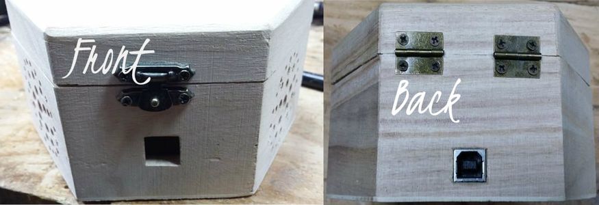

Step 7: Wood Box
We bought this box in a shop here in our neighbourhood. As you can see in the first picture is a normal wooden box where you can open the lid with a hinge. You can choose which ever box you want and the size you prefer but make sure that it can hold the whole structure of the tree.
We also got this wooden one because you can drill it and it's harder to break. If you want to add speakers to the design (we have) better choose a wood box because it'll be easier for you to make the holes.

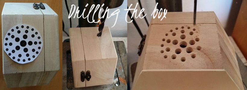

The first thing we made was the holes for the speakers. We found the drawing on the internet, I've put a few URLs to help you choose the right shape for you:
https://www.google.es/search?q=circulo+agujeros+al...
You can find the right drill for your box. Use them to make the holes carefully, don't put them too close because you might break the wood. Try not to move the box while drilling. When the holes are made and finished with the drilling, sand the inside of the box to eliminate the spare wood left.
The next thing to do, shown on the second picture, it's the hole for the supply and the hole for the ON/OFF switch. We used a chisel and a hammer for that. If you don't know what that is (like me at the beginning) here is a link to a picture:
https://www.google.es/search?q=chisel&rlz=1C1SVEF_...
With the hammer, pull softly and it will fall easily (try to choose a box with a pine tree wood because it's very soft). You must also sand the inside and the outside of the box after this. If you want to add the press button for changing the mode, the volume changer and the LED that shows the mode, use those tools and a drill.
The last thing to do is to make the hole on the tip of the box to insert the base that we will build later. We used a specific tool: a DREMEL (http://www.dremel.com/Pages/default.aspx). You can do that when you decide the size of the PCB for the base. Our box has a hexagon shape, so our circuit must fit in that. The next steps shows how we made the PCB.

Then, we put it in the acid, like the second picture shows. Be careful with this!

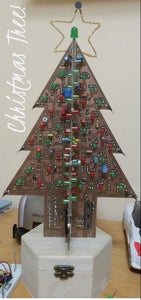

Once you have the tree shape and the base, you can weld them together. The supply from the ATMega328 and the lines that control the LEDs and the microphone are also welded from the base to the tree at the bottom of the shape. The drawings of the base that we've attached to the first step has the perfect shape of both Bakelite sheets together. So it'll be easy to weld the correct lines.
After that, you must screw the base to the wood box. We used two screws but it depends on the box you use, if you don't have enough space just put one but try to put it in the centre of the box and if you have plenty of space, you should put a few more screws to make you sure it's very tight.
One thing we recommend is to label each pin of the ATMega328 in the inside of the box, under the base. That will make it easier if you want to add any other functionality. The third picture shows what we did to our tree.
You can also see on that picture how we put the speakers. We connected them with a few precut wires because if one of them breaks you can replace it easily. Same for the press button and the switch.
Another thing we made, which is not required, is the wooden plate with the capacitor. We also used the DREMEL named before to make the shape of the box. Mind the wires, the speakers and the hinge! The capacitor helps to quit and put again the wooden plate, which covers all the wires inside the box improving its appearance. You'll be able to keep things inside the box!
The second picture shows how it finally looks. We tried to make pictures of all angles so that you have an idea of what you should get after all these 9 steps.
