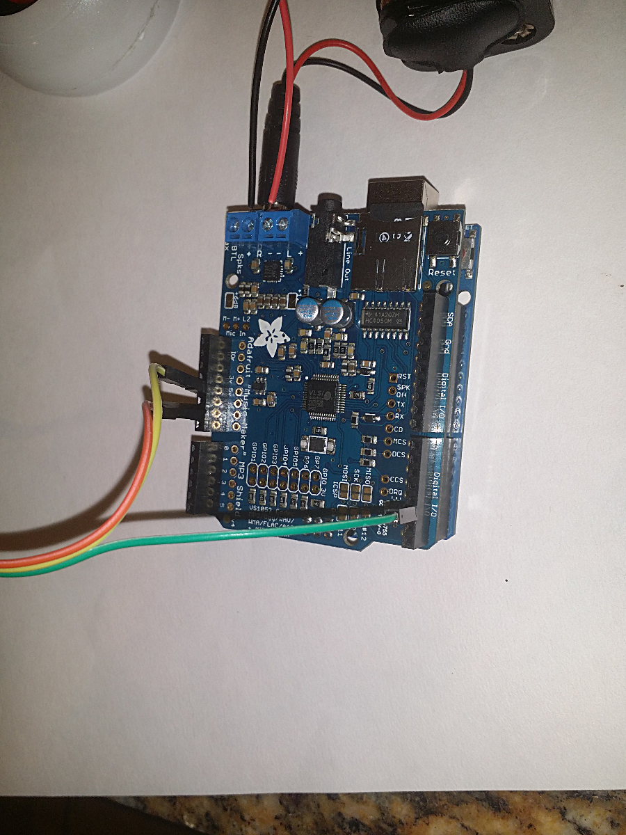

Step 2: Assemble Your Arduino, PIR Sensor, Speaker, and Shield

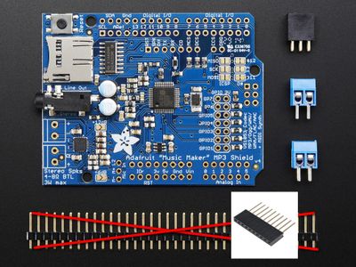

MP3 Shield
I purchased the un-assembled Adafruit MP3 shield so I replaced the header pins with stack-able headers so I could stack and easily prototype other items as I don't intend to leave this MP3 shield on here permanently.
PIR Sensor
The PIR sensor is connected with the following pins / colors:
Yellow (VCC) > 5v
Red(GND) > Ground
Green (OUT) > Digital Pin 2
If you change the digital pin make sure you update the following code in the Arduino INO file:
int inputPin = 2; // choose the input pin (for PIR sensor)
Speaker
Connect the speaker to the MP3 shield to the 2pin terminal blocks OR using a stereo connector if that's how you have your speaker(s) set up.
I used masking type to keep my PIR connected and hope that after the holidays it is easily removable still.
Battery / Power
I first used an 8 AA cell battery pack but it only lasted a couple of days so I switched to a 9v DC power supply which I tucked behind my garland around the door.

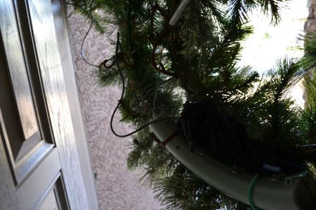

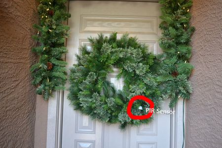

Step 4: Assemble and Mount the Wreath
There wasn't much to this step. I simply put the arduino in a felt bag with the PIR sensor hanging out and the DC input going into the power supply of the arduino. I stashed the bag with arduino near the wreath's battery pack and used some pipe cleaners (green or brown) to keep the cord from whipping around. The PIR just stuck out behind some needles and you can experiment with placement of the PIR. At one point I had the PIR hidden behind some decorating ribbon which was somewhat loose mesh and it still picked up movement about five feet out.
