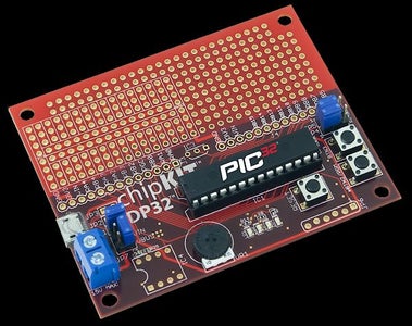

Introduction: Christmas Lightning Using Arduino Ide on Dp32 Board
Things we need:
1. DP32 board
2. PGM Programmer (to program the board)
3. 2 USB Cables (micro and mini)
4. Adruino IDE

Step 4: Restoring the Bootloader for Dp32 Board
Now we need to program the chip "PIC32 MX 250F 128B" sitting on the dp32 board using the chipkit programmer. In other words we are downloading the boot loader onto the chip using programmer
link to download the boot loader for dp32 -> https://reference.digilentinc.com/chipkit_dp32:chipkit_dp32 and scroll down to designer resources, and download the boot loader
Step 5: Programming the Hex File Onto the Dp32 Board
1: Open the MPLABX
2: Start a new project -> microchip embedded -> prebuilt hex project -> click next
3: browse where the boot loader was stored, select device 'PIC32MX250F128B' select hardware tool as a 'chipkit programmer' click next
4: project name and next
5: then hit the "make and program device" button, and PGM will start programing dp32.
6: the video shown above with flashing one green light means it is successfully programmed.
