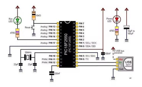

Step 2: Basic Pinguino Schematic Circuit
In the bellow picture We can see the minimal connections necesary to made our board work, according to it, We can made changes and build your own board for specific projects.
Step 3: Christmas Tree Schematic
Schematic Diagrama of the Christmas Tree:
You can get the schematic diagram : HERE
Basicaly We can see the microcontoller pic18F4550 connected with the 22 digital outputs in this case the leds.

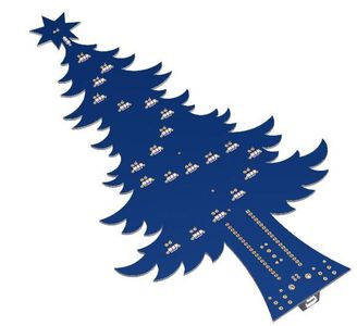

Step 5: 3D MODEL
One of the features of Altium Designer is the 3D visualization, the 3d visualization is important and it give us the posibility to see and check our PCB and how it would be in real, also it can show us the components distribution and dimensions. Before I did not consider this feature so important, but the 3d visualization can show us if our footprint dimensions are ok, if all the components will be places without touching each other by mistake.
► Also very important to remember, if you are going to add 3d models, be carefull that you add in the Step AP214 format, the others extensions and formats can not work correctly.
The 3d visualization can show us if our footprint dimensions are ok, if all the components will be places without touching each other by mistake.

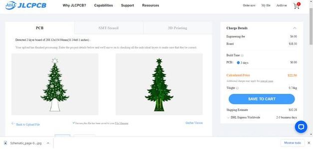

Upload your gerber files

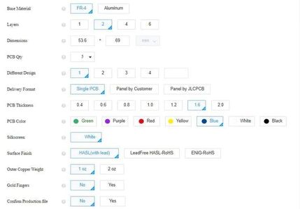

Indicate the features
After the upload of our gerber files, We need to indicate the features of the board, in the next picture you can see the options available.
Add your shipping address
This part is very important, here you should write your currently address, where you would like to receive your pcb prototypes. It is not common but sometimes very rarely, you will need to pay extra feeds, but as I told you, it is very rarely.
Make the payment and finish the order
After you indicates this information, We continue with the payment section, These is the section where you can apply your coupons or discount codes. Basically We can complete the paymente by two general ways, Paypal or Credit card.
Receive your PCB
Days later, 7 days or few more, according to your location and custom broker process, You will receive your pcb prototypes.

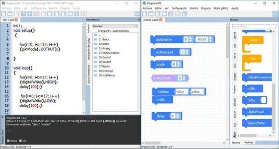

Step 10:
Programing the board
In order to program the board We need to donwload the Pinguino IDE, open source platform which uses the same language than the Arduino. You can download here: https://pinguino.cc/
 Youtube: https://bit.ly/3adS4mV
The Pinguino IDE works with textual programing and also Block programing.IMPORTANT. When you conect the board you have some seconds to upload your program after that You need to press reset boton to load the program again. Once your program is uploaded it will automatically reset and ejecute the program.
