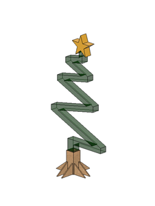

  1. I use Autodesk Fusion360 to design a lamp.
  2. Starting from a sketch on a plane.
  3. I used a reference to a Christmas tree image to design a lamp.
  4. I make this lamp using 2 mm thick Acrylic with different colors and use MDF for the base.
  5. All parts will be assembled using a Glue gun or Feviquick.

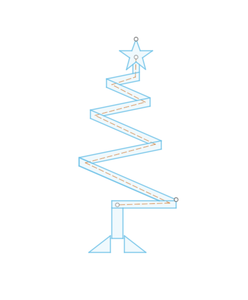

>> Design Part.
  1. I draw a zigzag pattern to make a Christmas tree shape.
  2. Tree shape is getting narrow from base to top.
  3. I take 250 for tree height, use a star of 50mm on top side.
  4. Consider 100 mm eight for base.
  5. Make 2D design considers 2mm thickness of acrylic and MDF.

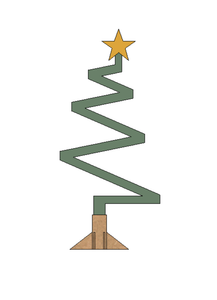

  6. I make 3d designs and then arrange all the pieces according to color to make a .DXF file for laser cutting.

  5. Most Laser Cutting software and vendors need a .DXF file for laser cutting.
  6. I attach my laser cutting .DXF file according to the color & material we use in acrylic & MDF cutting.
