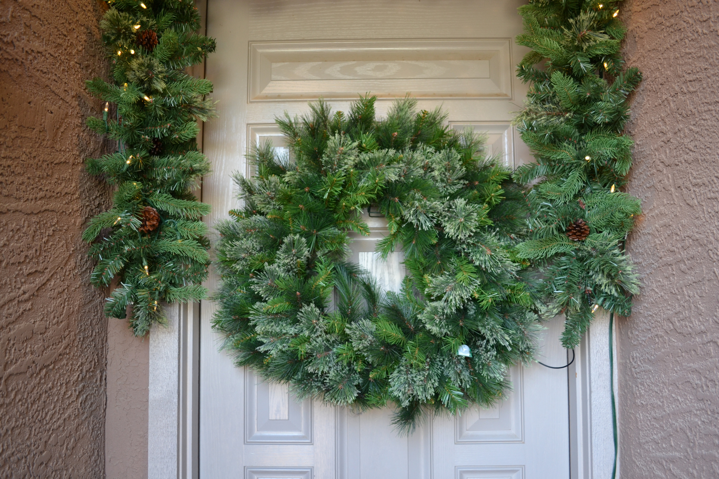

Introduction: Christmas Wreath 2.0 Raspberry Pi / Arduino "Selfie / Photobooth"
This is my festive craft for 2015 and builds on my 2014 Arduino based Christmas Tune Playing Christmas Wreath. I got into playing with the Raspberry PI this year and liked the aspects of running on linux and the various options I had with Linux and Python (or other programming) languages.
Last year's wreath simply used a PIR motion sensor to detect movement and then played a recorded greeting in an "elfish" voice and played a random Christmas song. This year I decided to make a photo booth type greeting complete with a touch screen interface, camera, and remote printer.
When the interface isn't presenting a "Selfie" or as I call it "Elfie" taking option I use a screensaver package to loop through festive Christmas graphics.

Step 5: Interaction and Final Product
When a visitor walks up to your door the PIR sensor from last year's wreath picks up first and greets the visitor with an "Elfish" high pitched "Welcome to the Jones', Merry Christmas" and begins to play a random Christmas MP3 song. The motion sensor hooked to the raspberry PI then picks up and presents the screens (christmas_wreath_2.0.py) for taking an Elfie picture.
You can "Take Elfie" or quit by touching "No Thanks, Merry Christmas"
A preview takes over the entire screen(not pictured above) where you have about 3-5 seconds (easily configurable in code) and then a picture is taken
The Picture is loaded into the lower left of the screen and you can either click "Re-take Elfie", "Print Elfie", or Quit again.
If you click "Re-take" the process re-takes a picture and loads the new preview.
If you click "Print Elfie" the "Now Printing" animation takes over so you know something is happening since the bluetooth printer takes about 2 minutes to receive a standard 5mp photo coming out of the PI camera, then the photo prints out and the app quits until the next movement is detected.
