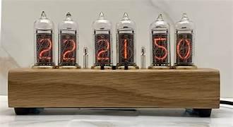

ChronoFlux — A Retro-Futuristic Edge-Lit Nixie Revival is my modern re-imagination of the iconic Nixie tube clock. Instead of delicate gas-filled tubes, I designed a fully custom display made from stacked laser-cut acrylic digits, each illuminated using individually addressable LEDs to create a clean, glowing, retro-futuristic aesthetic.
The entire clock is powered by a XIAO ESP32S3, paired with a DS3231 RTC for stable timekeeping and a NEO-6M GPS module that automatically calibrates the time and adjusts the timezone. It’s housed inside a 3D-printed wood-textured enclosure, designed in Fusion 360 and completely fabricated in our college Fab Lab.
My goal with ChronoFlux was to blend old-school charm with modern electronics, creating a unique timepiece that feels both nostalgic and futuristic at the same time.

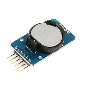

  2. DS3231 RTC Module– Accurate real-time clock

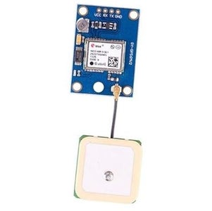

  3. NEO-6M GPS Module – Automatic time + timezone synchronization

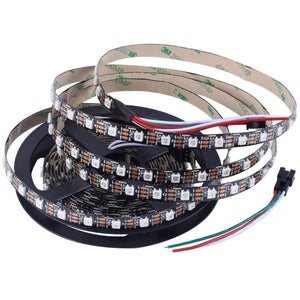

  4. WS2812B Individually Addressable LEDs – Edge lighting for acrylic digits

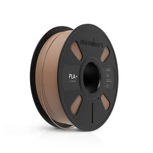

  1. Wood-Texture PLA Filament – For the retro-futuristic enclosure

🌲 1. 3D Printing the Wooden Case (Wood-Effect PLA)
The enclosure of ChronoFlux is designed to look retro, warm, and handcrafted. To achieve this, we use Wood-Texture PLA and a special wood grain technique during 3D printing.
We printed everything using a Bambu Lab A1 Combo in our college Fab Lab.
🔧 1.1 Preparing the Wood Texture in Bambu Studio
To get the natural wooden look, we follow the method demonstrated in these two excellent videos:
  1. https://youtu.be/dPqu9Sk01jc?si=Lq2xsLUWskayY7i7
  2. https://makerworld.com/en/models/868884-add-wood-grain-effects-to-your-models-using-a-smal
These tutorials explain how to create beautiful wood grain patterns on your 3D prints using:
✔ Variable layer heights
✔ Color/texture tricks
✔ Surface pattern variations
✔ Simple slicer adjustments
Beginner summary of the technique:
  1. Import your Fusion 360 model into Bambu Studio.
  2. Select your wood-texture PLA filament preset.
  3. Enable features like:
  4. Variable Layer Height
  5. Surface Texture (light or medium)
  6. Random Z-seam
  7. Apply a slight modifier mesh (as shown in the video) to create grain lines.
  8. Preview the texture before slicing.
  9. Slice the model and get your G-code ready for printing.
Even if you’ve never added wood grain to a print before, these videos + Bambu Studio make it very beginner friendly.
🖨️ 1.2 Printing the Wooden Parts on the Bambu Lab A1 Combo
Once sliced, send the print to the Bambu A1 Combo.
Tips for a successful print:
  1. Use 0.2 mm or 0.24 mm layer height for good details.
  2. Slow down the outer wall speed slightly for smooth finish.
  3. Keep the bed temperature around 50–60°C for PLA.
  4. Make sure your filament is dry for best texture quality.
  5. If possible, print the top cover facing upward for better grain effect.
You will see the wood grain come alive as the printer builds the layers — this is one of the most satisfying parts of the project!

🔹 ESP32S3 → LEDs
The LEDs have 3 wires: 5V, GND, DIN
  1. LED 5V → Buck Converter 5V Output
  2. LED GND → ESP32S3 GND
  3. LED DIN → ESP32S3 Pin D10 (recommended)
Why D6?
It's a stable GPIO and works well for long LED chains.
Important:
Connect all grounds together.
This includes:
  1. ESP32S3 GND
  2. Buck converter GND
  3. LED GND
  4. RTC GND
  5. GPS GND
A shared ground ensures stable LEDs and zero flicker.
🔹 ESP32S3 → RTC (DS3231)
The DS3231 uses I²C, so only 4 wires needed:
  1. RTC VCC → 3.3V on ESP32S3
  2. RTC GND → ESP32S3 GND
  3. RTC SCL → ESP32S3 Pin D6 (SCL)
  4. RTC SDA → ESP32S3 Pin D5 (SDA)
This gives accurate local time at all times.
🔹 ESP32S3 → GPS (NEO-6M)
The GPS uses UART (TX/RX):
  1. GPS VCC → 5V
  2. GPS GND → GND
  3. GPS TX → ESP32S3 RX
  4. GPS RX → ESP32S3 TX
This lets the ESP32S3 receive satellite time data.

✔ 2.1 Cut the LED strip
For one digit block, you only need 10 LEDs.
Cut the strip carefully on the copper pads.
✔ 2.2 Verify data direction
LED strips show arrows → direction of data flow.
Make sure the arrow points towards the stack of digit plates.
✔ 2.3 Insert the LED strip into the LED channel
Ensure LEDs sit exactly under the acrylic plates.
✔ 2.4 Secure the strip
Hot glue or double-sided tape works well, but avoid covering the LED lens.

✔ 3.2 Mount the RTC
Attach the DS3231 so the battery faces upward or sideways.
Don’t trap the CR2032 battery — it must be replaceable.
✔ 3.3 Install the GPS module
Place the antenna facing upwards for better satellite reception.
