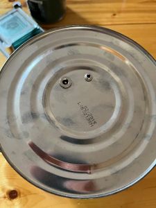

Once you have at least one empty can you can start drilling holes for the controls for your amplifier and power supply. Of course, this is dependent on the type of amplifier and supply you use. In any case, make sure to use masking tape to easily mark the holes and to make sure your drill isn't going to wander about while you try to drill your holes.
After drilling the holes for the amp and power supply you can drill any optional connections you might need for your project. If you make more than one speaker you will need to drill an extra hole for the 3.5mm cable connecting the first (active) speaker to the second (passive) speaker. Furthermore, I added an extra 3.5mm socket because I am planning on adding a subwoofer later on.

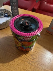

For assembly I started by fitting all connectors and buttons into the holes I drilled in my cans. After that I used a glue gun to fix my amp on top of my battery pack and my battery pack to the bottom of my active speaker. If you use a different style of amplifier the first step might not be necessary. In that case, just glue the battery pack to the inside of the can.
When everything is connected and fixed to the can you can add some cabinet damping if you want. I used specialized materials I bought online but I guess you can also use some cotton wool as well. Just to be safe I added some baking sheets between the electrical components and the damping material. I have no idea whether this helps or not or is even necessary, but it gives me peace of mind.
After everything is inside your speaker you can fit the speaker chassis with the speaker where the lid used to be. I found that it was a perfect fit for one can, but not for the other. To remedy this, I just used some glue to keep it in place.
Lastly, if you want to use the cans on their sides, you have to assemble the feet. You can use simple 3x16mm screws to fix the furniture coasters. The steel rods should fit perfectly in their holes. If not I guess you could use some glue to keep them in place.
Now you should be good to go and enjoy some of your favourite music!
