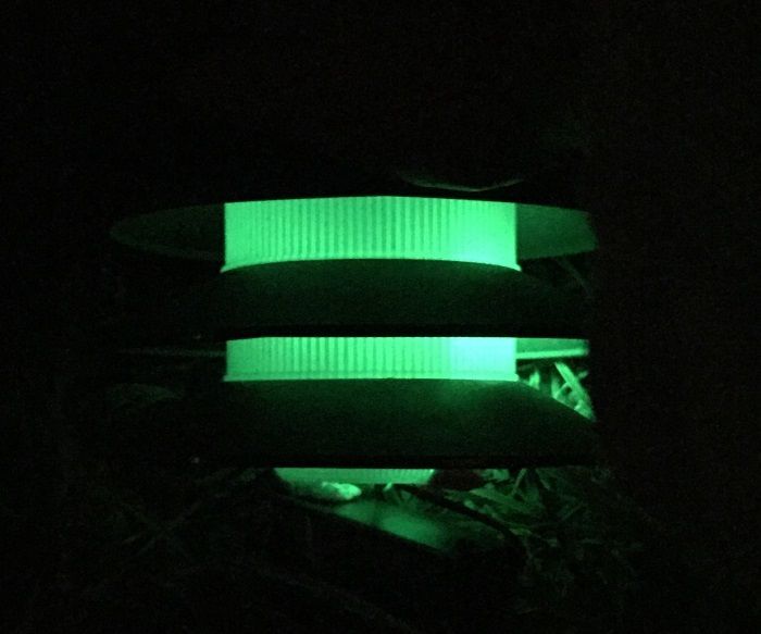

Introduction: Church Lights
If you watch the video you can see how the colour of the foam church changes when I rotate the potentiometers.
I used a tricolour LED. However, you can use three bright LEDs of different colours.
You also can try normal LEDs instead of bright LEDs but they could be very dim. Also, there are colour changing bright LEDs sold on the internet nowadays. Their colour slowly changes with time. They are expensive and certain cheap bright LEDs could be smaller than expected when they come in the mail.

Step 4: Build the Sculpture
I used high-power wires to attach the church piece to the ground piece of this sculpture.
