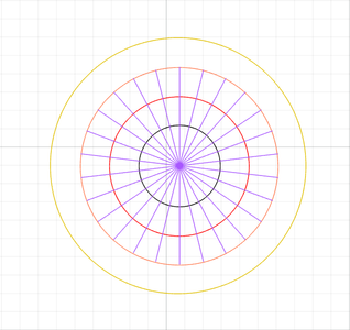

Create a 1.75" diameter circle and assigned it to a black layer. I used the “Outline” tool in Creative Space to create offsets of this circle with diameters of 3"(red), 4.25" (orange), and 5.5” (yellow).
Draw a line through the 12:00 and 6:00 positions of the largest (yellow) circle. Use the “Array” tool to create a circular array with 13 lines. I assign this to a green layer.
Draw a line through the 12:00 and 6:00 positions on the second largest (orange) circle. Use the “Array” tool to create a circular array with 13 lines. I assigned this array to a purple layer.

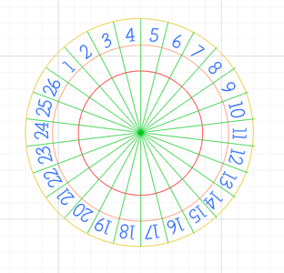

Add numbers 1-26 between the yellow and orange circles and spaced appropriately for one number in each cell.

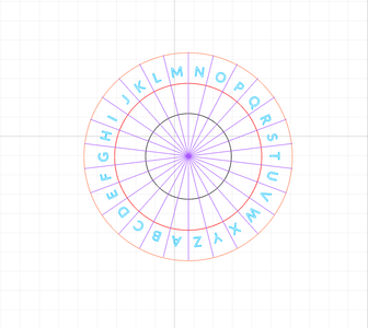

Add letters A-Z between the orange and red circles and space appropriately for one letter in each cell.

Create a copy of the red circle. Add the text and symbol of your choice. This will become the centerpiece.

The first job was for the stationary disk. I set layers green, blue, and black to score. The yellow layer was set to cut.
The second job was for the moveable disk. I set layers blue, red, and purple to score. The orange and black layers were set to cut.
