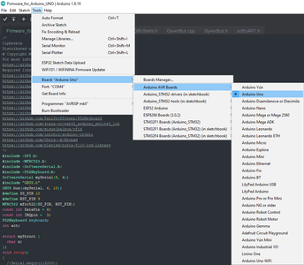

Step 3: Install Drivers and Configure Arduino IDE *Optional
If you've never flashed ESP32 or ESP8266 before you'll need to configure Arduino IDE and install drivers to upload the firmware to the boards, you can find drivers here:
CP210x driver for ESP32: https://www.silabs.com/developers/usb-to-uart-brid...
CH340 driver for ESP8266: https://sparks.gogo.co.nz/ch340.html
In case you don't have Arduino IDE, you can download it here: https://www.arduino.cc/en/software
Configuring IDE isn't a part of this tutorial, you can read about it here:
ESP32: https://randomnerdtutorials.com/installing-the-esp...
ESP8266: https://randomnerdtutorials.com/how-to-install-esp...

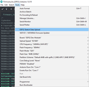

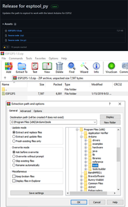

Step 6: Install ESP32 Filesystem Uploader
The primary purpose of the ESP32 Filesystem Uploader is to let you upload files into ESP's filesystem. In this tutorial, the purpose of this tool is to upload an empty SPIFFS image into ESP.
Download the "ESP32FS-1.0.zip" file here https://github.com/me-no-dev/arduino-esp32fs-plugin/releases/
And then extract the content of that archive into the "...\Arduino\Tools\" folder.
After that, restart the Arduino IDE.
Step 7: Format ESP32'S Built-In Flash Memory
Click Tools -> ESP32 Sketch Data Upload. Then click Yes in the pop-up window. The program is going format the built-in flash memory.

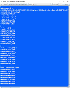

Step 8: Generate Keys
To make the unauthorized deciphering of your data computationally infeasible - It is crucial to generate your own keys and never reuse them.
The best way to generate the keys is to throw 20-sided dice.
If you get a number from 1 to 9, write it down.
If you get a number from 10 to 15, write down a letter corresponding to that number.
10 = A;
11 = B;
12 = C;
13 = D;
14 = E;
15 = F.
If you get 20, write down 0.
If you get something else, don't write anything and throw the dice again.
There's also an easier option.
I modified one of my previous projects to work as a random number generator, the generated output seems "random enough" for me, but I haven't run any tests. So, I can't guarantee that it's random.
Use it at your own risk.
To generate the keys - launch gen.exe from the "Cipherbox-main\V2.0\Untested RNG" folder, and then click the "Generate keys for Cipherbox V2.0" button. The background turns from black to blue when you press that button.

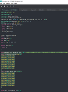

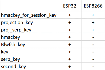

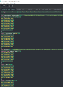

Step 10: Modify the Firmware
Open the files "Firmware_for_ESP32.ino" and "Firmware_for_ESP8266.ino" from the folders "Cipherbox-main\V2.0\Firmware for the vault\Firmware_for_ESP32" and "Cipherbox-main\V2.0\Firmware for the receiver\Firmware_for_ESP8266" and then replace my keys with those you've generated.
The vault requires eight keys, while the receiver only needs three. Make sure that projection_key, hmackey_for_session_key and proj_serp_key are the same on both devices.
Don't forget to replace the receiver's MAC address in the line
uint8_t broadcastAddress[] = {0x5C, 0xCF, 0x7F, 0xFD, 0x85, 0x1D}; // Receiver's MAC address
in the file called "Firmware_for_ESP32.ino"
Step 11: Flash the ESP32
Upload the firmware from the folder "Cipherbox-main\V2.0\Firmware for the vault\Firmware_for_ESP32" into the ESP32.
Step 12: Flash the Arduino Uno (transmitter)
Upload the firmware from the folder "Cipherbox-main\V2.0\Firmware for the vault\Firmware_for_Arduino_UNO" into the Arduino Uno.

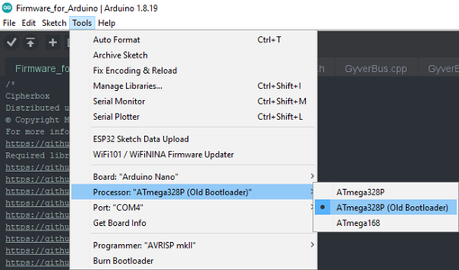

Step 14: Flash the Arduino (Receiver)
Upload the firmware from the folder "Cipherbox-main\V2.0\Firmware for the receiver\Firmware_for_Arduino" into the Arduino.

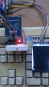

Step 19: Power Up the Vault and Approximate Four RFID Cards
Ok, it's time to unlock the vault. Power the vault up and consequently approximate four RFID cards to it. You need to approximate cards in exactly the same order every time you unlock the vault, or you won't be able to decrypt your stuff.
Important thing: If you want to reboot ESP32, reboot all boards. And if the keyboard suddenly stops working as intended, only reboot the Arduino Uno.
