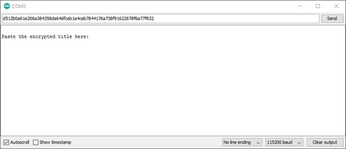

An attacker obtained physical access to the device and extracted the database from it.
An attacker found these three Ciphertexts that they're unable to decrypt. But, let's suppose that an attacker knows where the ciphertext with the value of the bonus for Mark Brown is stored, which block has the encrypted value of the bonus, and where the ciphertext with the value of the bonus for John Smith is stored. Let's suppose that attacker knows that the bonus received by Mark Brown is more than the bonus received by John Smith, and an attacker wants to increase the bonus for John Smith. To do so, the attacker takes the block with the encrypted value of the bonus for Mark Brown and replaces John Smith's bonus with Mark Brown's bonus. That trick would've worked with Cipherbox 1, and the forged ciphertext "Send John Smith $500" would've been decrypted without any problems. Cipherbox 3 (and also Cipherbox 2) would decrypt that ciphertext too. But unlike Cipherbox 1, a later version of the Cipherbox computes a tag for each plaintext and then prints that tag in an encrypted form. When Cipherbox 3 (and also Cipherbox 2) decrypts the ciphertext, it also decrypts the tag and computes the new tag for the decrypted text. It then compares both tags. If these tags don't match, it turns the decrypted text red and throws the alert "Integrity verification failed!"

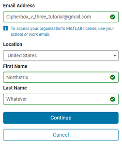

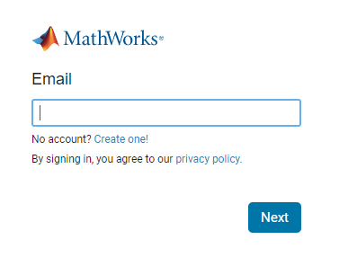

Step 3: Create a Free ThingSpeak Account

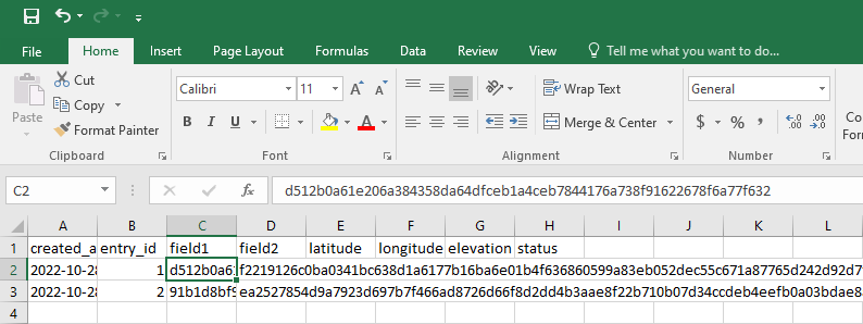

To store notes in the cloud, you need a ThingSpeak account. A free ThingSpeak account allows you to send data to it 3,000,000 times a year.
To create a free ThingSpeak account:
- Go to thingspeak.com and click the "Get started for free" button;
- On the next page, click the "Create one!" hyperlink;

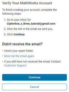

- In the form that should appear after that. Enter your email, first name, and last name. And click the "Continue" button;

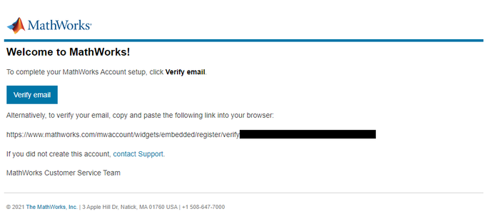

- Open your email and find a letter from "service@account.mathworks.com";
- Open that letter and click the "Verify email" button on it.

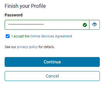

- Now, get back to the tab demonstrated in picture 4 and click the "Continue" button;
- Set the password for your account and click the "Continue" button;
- Click the "OK" button.
*All credentials demonstrated here are fictional. Any similarity to actual credentials is purely coincidental.

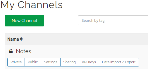

To create a channel:
- Click "Channels" -> "My Channel";
- On the page that will open, click the "New Channel" button;
- Check the checkbox right of "Field 2";
- Name the channel and fields however you want;
- Scroll down and press the "Save channel" button.

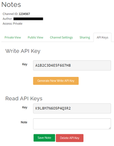

Step 5: Get the Channel's ID and API Keys
To work with the channel - you need its ID, Write API Key, and Read API Key.
To get the channel's ID, Write API Key, and Read API Key - open the channel and go to the "API Keys" tab.
The values demonstrated on the screen are:
Channel ID: 1234567
Write API Key: A1B2C3D4E5F6G7H8
Read API Key: K9L8M7N6O5P4Q3R2
*Channel ID and API Keys demonstrated here are entirely fictitious. Any similarity to the actual channel ID and API keys is purely coincidental.

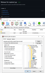

The primary purpose of the ESP32 Filesystem Uploader is to let you upload files into ESP's filesystem. In this tutorial, the purpose of this tool is to upload an empty SPIFFS image into ESP.
Download the "ESP32FS-1.0.zip" file here https://github.com/me-no-dev/arduino-esp32fs-plugin/releases/
And then extract the content of that archive into the "...\Arduino\Tools\" folder.
After that, restart the Arduino IDE.

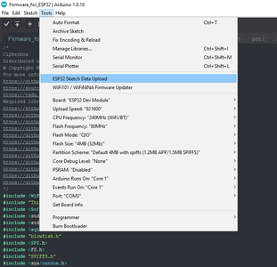

Step 10: Format ESP32'S Built-In Flash Memory
Click Tools -> ESP32 Sketch Data Upload. Then click Yes in the pop-up window. The program is going format the built-in flash memory.
Some boards will flash without any problems.
Unfortunately, that's not the case for all boards. If you configured IDE correctly, installed drivers, selected the corresponding port, and still keep getting this error: A fatal error occurred: Failed to connect to ESP32: Timed out waiting for packet header. Connect a 10µF capacitor to the board while flashing.
Connect the positive lead of the capacitor to the EN pin of the ESP32;
Connect the negative lead of the capacitor (usually indicated by the gray stripe) to the GND pin of the ESP32.
Don't forget to disconnect the capacitor after the board flashes.

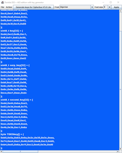

Step 11: Generate Keys
To make the unauthorized deciphering of your data computationally infeasible - It is crucial to generate your own keys and never reuse them.
The best way to generate the keys is to throw 20-sided dice.
If you get a number from 1 to 9, write it down.
If you get a number from 10 to 15, write down a letter corresponding to that number.
10 = A;
11 = B;
12 = C;
13 = D;
14 = E;
15 = F.
If you get 20, write down 0.
If you get something else, don't write anything and throw the dice again.
There's also an easier option.
I modified one of my previous projects to work as a random number generator, the generated output seems "random enough" for me, but I haven't run any tests. So, I can't guarantee that it's random.
Use it at your own risk.
To generate the keys - launch gen.exe from the "Cipherbox-main\V3.0\Untested RNG" folder, and then click the "Generate keys for Cipherbox V3.0" button. The background turns from black to blue when you press that button.

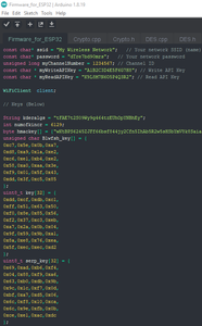

Step 12: Modify the Firmware
Open the file "Firmware_for_ESP32.ino", scroll down a bit, and then replace my values of the ssid, password, myChannelNumber, myWriteAPIKey, myReadAPIKey, hmackey, Blwfsh_key, key, serp_key, second_key, and TDESkey with yours.

Step 26: Decrypt a Note From the Cloud
Well, necessity is the mother of invention. Just because the Cipherbox can't pull the arbitrary note from the cloud doesn't mean you can't.

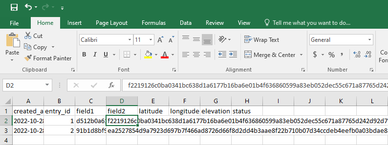

To decrypt an arbitrary note from the cloud - log in to your ThingSpeak account, get to that channel's "Data Import / Export" tab, and click the "Download" button.
Then, open the "feed.csv" file that just got downloaded and open the Serial Monitor because you'll need to paste the encrypted title alongside the encrypted content to it.
After that:
- Select the "Onl strd nots" line in the main menu;
- Press the "A" button;
- Select the "Decrypt Note" line in the "Onl strd nots" submenu;
- Paste the encrypted title to the Serial Monitor;
- Press the "Send" button in the Serial monitor;
- Paste the encrypted content to the Serial Monitor;
