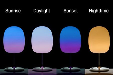

I will be creating a circadian lamp which will change colour depending on what time of day it is. The colours imitate what colour the sun would be outside and puts you in the right mood. All the artificial lights these days have taken us away from our natural body clock by keeping us awake but hopefully this circadian lamp can produce some natural light. You will be able to turn this on and off with a switch.
