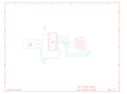

Step 3: Connection
Connect the components within Tinkercad according to the images

Step 5: Test the Circuit
Start the simulation in Tinkercad. Use the virtual keypad to enter the radius of the circle. Press 'D' when finished entering the radius. The LCD should display the calculated area of the circle.
