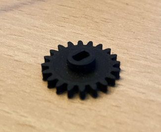

Step 2: 3D Printing the Gears (optional)
I printed the gears on the Ultimaker 2+ using the following parameters:
  • PLA
  • 0.4mm layer height
  • 100% infill
  • Brim build plate adhesive
After printing, I used an utility knife and sanding paper to remove the brim. I found the gears were a little too small for the axle, so I used hot air to heat the hole in the gear and put the axle through.
Instead of 3D printing the gears, the gears can also be lasercut from plywood.

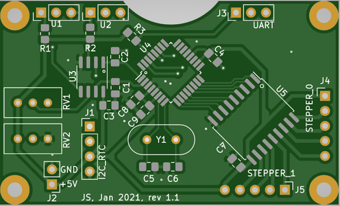

Step 5: Assembling the PCB
In order to assemble the PCB, it should first be ordered. I used JCL's prototyping service for ordering my PCBs.
  1. Download the latest gerber files from my Github repository
  2. Send the files to your favourite PCB manufacturer
  3. Wait for the boards to arrive
Before soldering the microcontroller, make sure the Arduino bootloader has been burned onto it. This instructable will tell you how to burn the bootloader. For burning the bootloader, I used a ZIF socket so I didn't have to solder the chip twice.
There are many ways to solder this PCB, here is how I did it:
  1. Apply solder paste to the pads of the SMD components
  2. Using tweezers and the schematic, put the components in place
  3. Solder the components using hot air
  4. Remove excess solder using solder wick
  5. Solder the through hole components and connectors
  6. Solder the hall sensors using the solid core wire
  7. Solder cables to the battery holder
Optional: shorten the cables of the stepper motors.
Optional: reduce the power used by the RTC module by modifying the module
