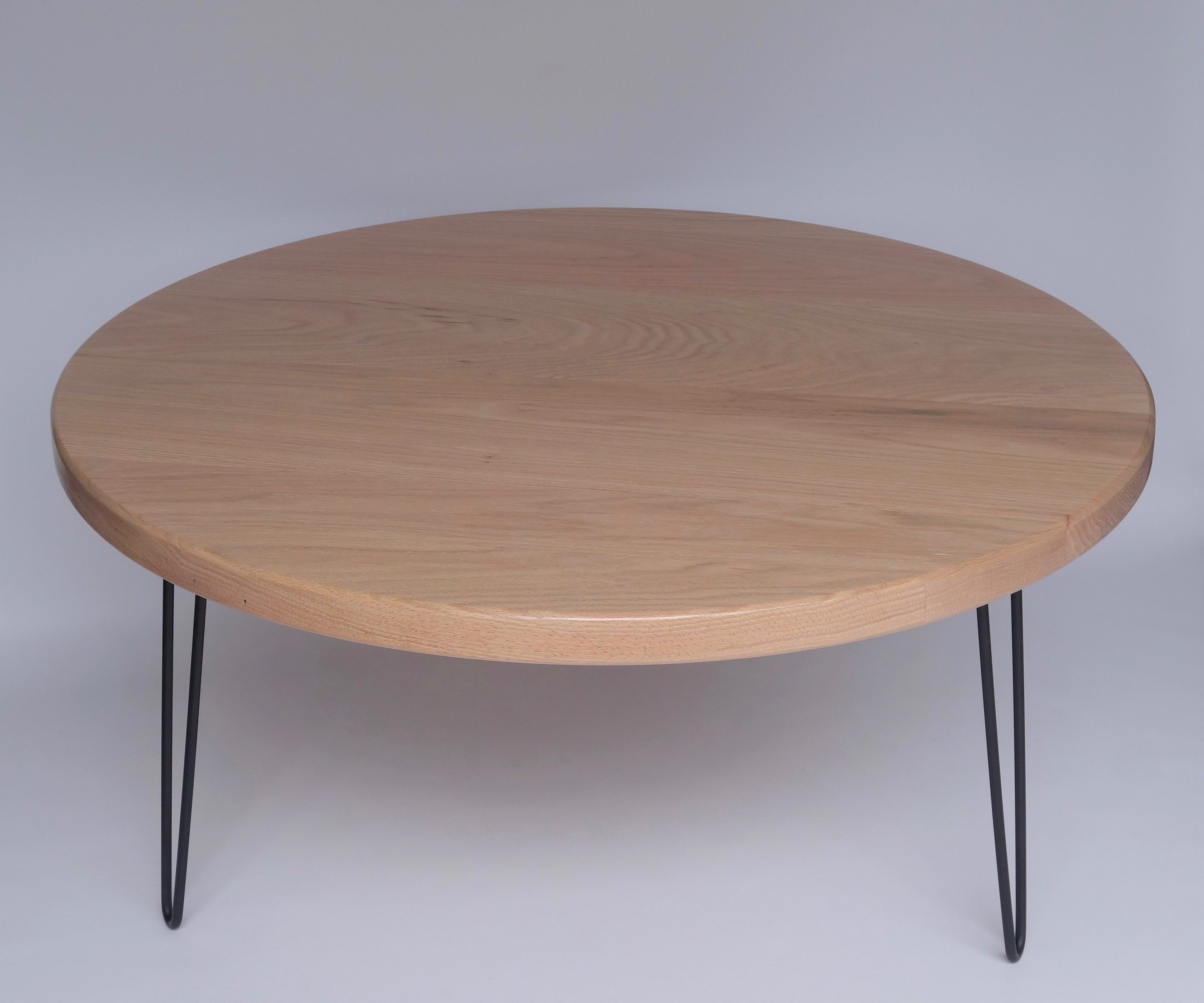

Take the radius of the circle you want to cut and measure that distance away from the hole left by your plunge router.
In this case I wanted my circle to have a 3' diameter so I measured 18" away from the edge of the hole and marked a point. I then drilled a hole there.

Step 5: Time to Cut a Circle!
Find the center of the board you want to cut your circle out of and screw the jig down. If you're making something that will be visible, such as a table top, make sure to put the jig on the underside. Turn your router on and rotate the jig clockwise, lowering the bit with each pass. Be aware of the surface below your board so you don't cut into it. If your lumber is thinner you can simply raise it up and complete the cutting. However, if it is thicker, you will need to use a jig saw and flush trim bit to finish cutting the circle. I simply cut as deep as my bit would reach, used a jig saw to cut between the void left, and a flush trim bit to clean up the remaining wood.
