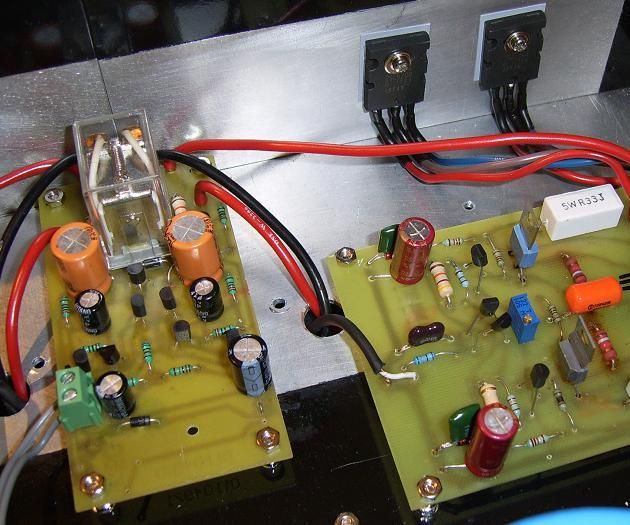

I made a very simple tutorial describes the production board(Diy pcba manufacturing), we want to help, but if poorly written, please forgive me.
General In my own experience wash circuit board, it can be divided into four processes: 1. Artwork --- (by PROTEL or other related software LAYOUT a map, and then transferred to the slide or tracing paper) 2. Exposure --- (photographic board table lamp or exposure to light irradiation way to get shot in the artwork printed on photographic plates) 3. Imaging --- (using a developing solution after exposing photosensitive agent to wash away, leaving the artwork) 4. Etching --- (will not wash away the foil, leaving the line we need) In this example, I use a good webmaster recently LAY 22W power amplifier as an example,
