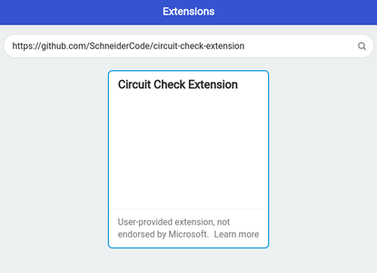

The Circuit Playgrounds are supported with an Arduino Library and the micro:bit is supported through extension for MakeCode. If you need help with importing a zipped Library in the Arduino IDE, check out this tutorial: https://www.arduino.cc/en/guide/libraries. For MakeCode, to add the extension you will need to enter the github url (provided below) in the extension search bar. This process is detailed in Sparkfun's guide for adding the gator:log extension to MakeCode: https://learn.sparkfun.com/tutorials/sparkfun-gatorlog-hookup-guide/adding-the-makecode-extension
The Arduino Library's Zip File: https://bit.ly/3xbGWnS
The MakeCode Extension's Github URL: https://github.com/SchneiderCode/circuit-check-extension

Step 3: Including the Library - MakeCode
In order for your micro:bit to connect to Circuit Check, you'll need to add the "run circuit check" block to the start of your forever loop. Once that block has been added you'll be able to view and control any of your on board sensors and actuators!

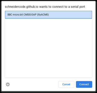

Step 4: Connecting to Circuit Check
To connect your microcontroller to Circuit Check you will need to:
  1. Navigate to Circuit Check's website
  2. Make sure you are using a compatible browser - Chrome, Edge, Opera
  3. Click the USB icon in the top left corner
  4. Select your microcontroller from the pop-up list
  5. Click connect and make sure the USB icon turns white
