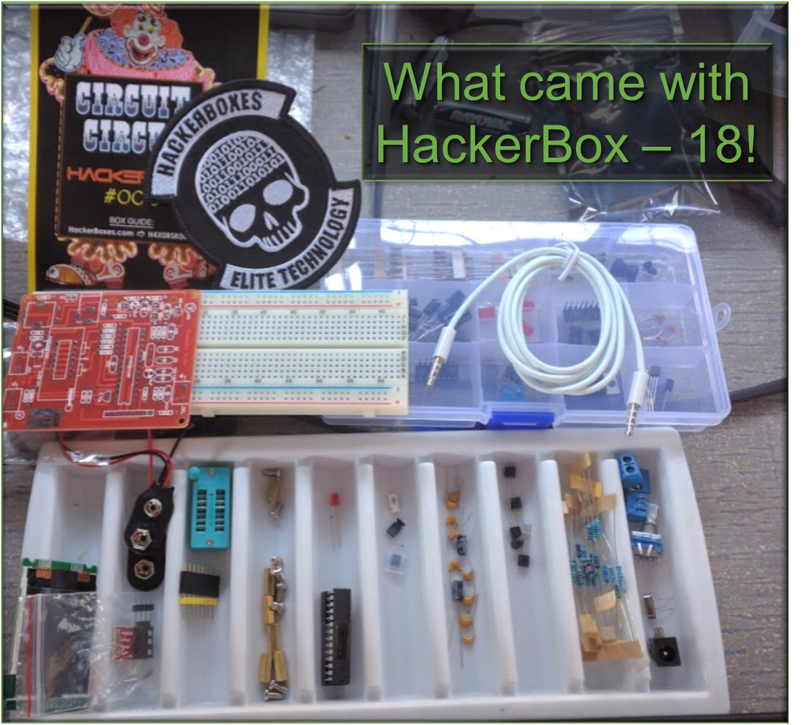

The "TransistorTester with AVR microcontroller" is an incredible little device that will help you figure out the specs of virtually any kind of electronic part. No worries if the labels are scratched off or painted over, just plug it in and test it out! The detailed manual can be found here (updated 26 May 2017, as of this post). I've included it below in the references, along with may other helpful things.
This Instructable explains the HackerBoxes 0018 Circuit Circus instructable, but play-by-play, and for the absolute beginner. I included as much detail as I could find. This kit can be bought at their website, but they have a limited amount. **(edit 24 Sep 2017: I ordered and received this kit: 2017 DIY kits ATMEAG328 M328 Transistor Tester LCR Diode Capacitance ESR meter PWM Square wave Frequency Signal Generator - at 17 USD$, which is is a very good deal; it took two weeks to get here, and also came with a case! Ithad no instructions or parts list, but it has all the right pieces. As I build it out, i'll supplement and update this Instructable with updated / more helpful pictures. I'm actually using this Instructable to assemble it, step by step.)
The purpose of this Instructable is to document every tiny detail so that the absolute beginner would be able to complete this project. I also want to provide practical tips and information, most of which I learned as I did this project.

Step 1: 1.1 the Optional Micro Components
These components were considered optional, so I decided to try it anyways. No harm, no foul, right?
