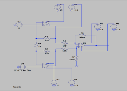

Step 1: Instrumentation Amplifier
Materials Required:
  • 3 uA741 op-amp

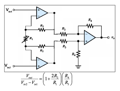

  • Resistors: R1 = 1KΩ, R2 = R3 = 15 KΩ, R4 = R5 = 10KΩ, R6 = R7 = 390KΩ.
Procedures:

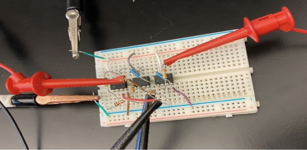

To design our instrumentation amplifier we first calculated the values required for our resistors, and capacitors by using the equation. We found our gain to be 1209. After finding the required values and gain desired we then created the circuit schematic using 3 uA741 op-amps, resistors with value R1= 1KΩ, R2 = R3 = 15 KΩ, R4 = R5 = 10KΩ, R6 = R7 =  390KΩ in LTSpice as shown in figure above and then ran the stimulation. After completing LTSpice simulation, we designed the circuit in the lab using breadboard, uA741 op amps, resistors with desired values and connected the circuit using jumper wires, alligator clips and different cables. We then displayed the input and output signal on the oscilloscope at different input frequencies to measure the magnitude and phase of the output signal.

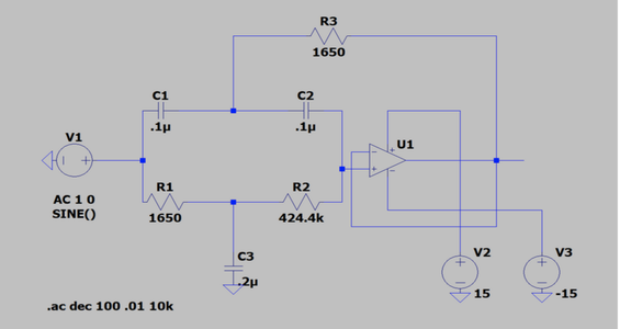

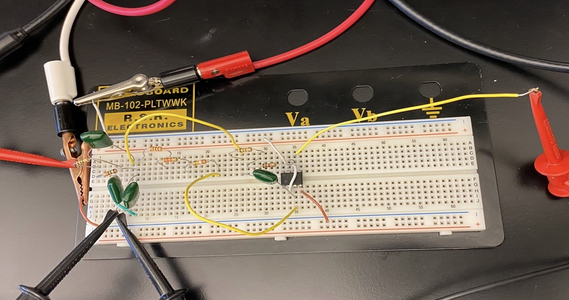

Step 3: Notch Pass Filter
Materials Required:
  • 3 uA741 op-amp
  • Resistors - R1 = R3 = 1.65KΩ, R2 = 424.4 KΩ
  • C1=C2 = .1uF, C3 = .2uF
Procedures:                                                                                                                               We first calculated the values required for our resistors, and capacitors by using the equation shown above..... The cutoff frequency of the notch filter used here is ~62 Hz. We then created the circuit schematic using 3 uA741 op amps, resistors with R1 = R3 = 1.65KΩ, R2 = 424.4 KΩ, and capacitors with C1=C2 = .1uF, C3 = .2uF using LTSpice which is shown in figure 1.5 below and ran the stimulation which is shown below in figure 16  below. After completing LTSpice simulation, we designed the circuit in the lab using a breadboard, resistors, capacitors, op amps, jumper wires, etc. which is shown in figure 1.6 below. We then displayed the input and output signal on the oscilloscope at different input frequencies to measure the magnitude and phase of the output signal.

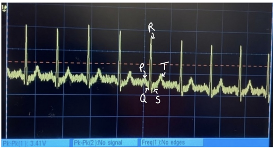

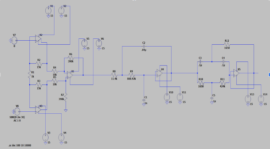

Procedures: After successful testing of all three circuits above individually on LTSpice, we then connected the individual circuits on LTSpice as shown in figure above and then ran the simulation. After completing the LTSpice simulation of integrated circuits, and successfully running individual circuits we then combined the individual circuits together as shown in figure. We used two 9V batteries, one to supply Vin(+) and the other one to supply Vin(-). We then connected 3 electrodes to the circuit; the electrode carrying Vin+ was attached to left ankle, the electrode carrying Vin- was connected to right wrist, and the ground electrode was connected to right ankle. The output of the integrated circuit was connected to channel 2 of the oscilloscope. After adjusting the circuit and the scope, we recorded the ECG reading successfully.
