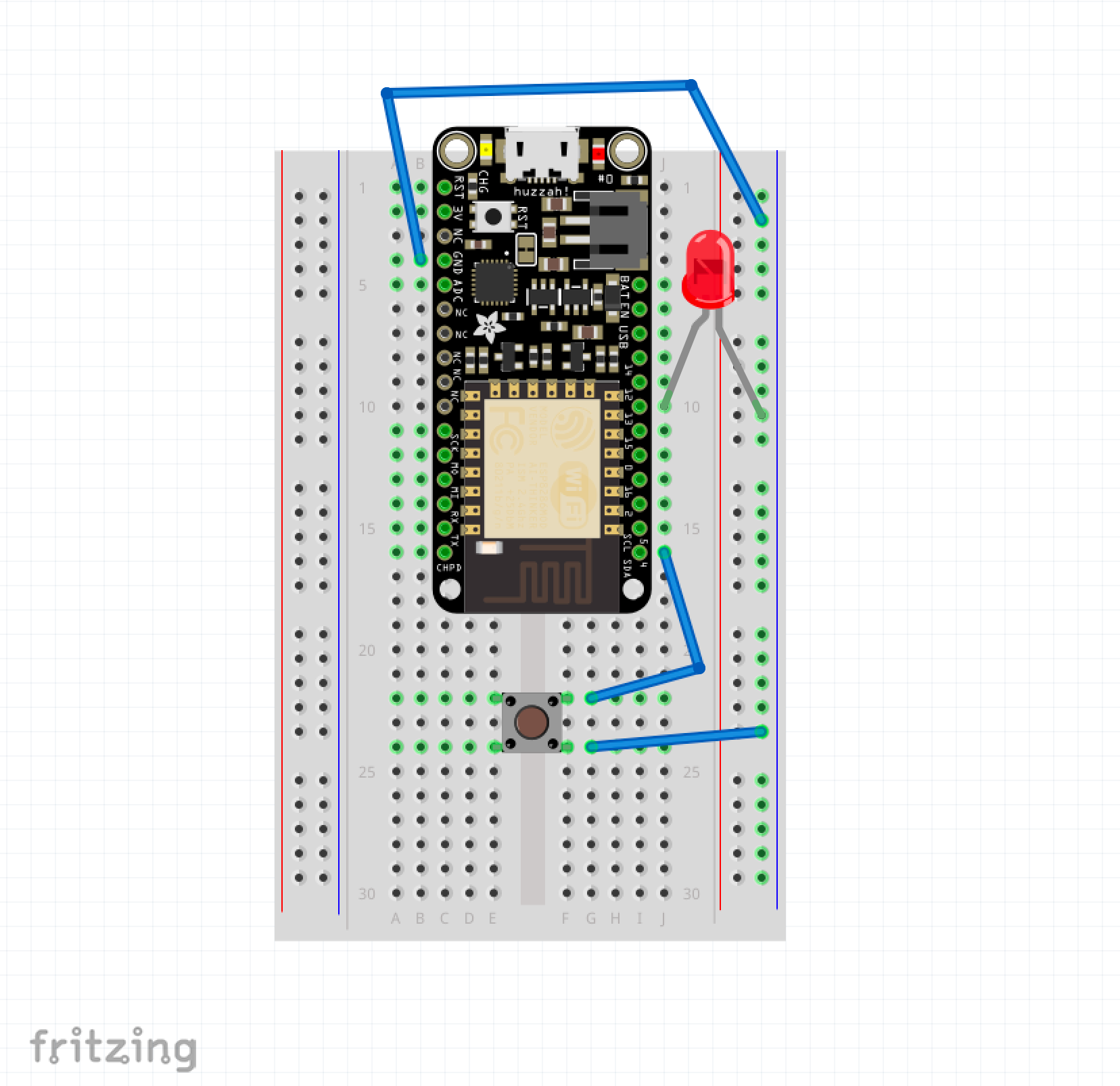

Step 1: Simple LED Circuit
Does this circuit look familiar? It should by now! It's the same one we used at the beginning of the previous lesson— a simple pushbutton and LED connected up to the Feather Huzzah ESP8266. Rebuild the circuit according to the diagram and load up the button-to-Adafruit IO test code once more by navigating to File -> Sketchbook -> button_input_led_output. If you can't find it, no worries, just download it from this step (and take better care of this copy, will ya?).

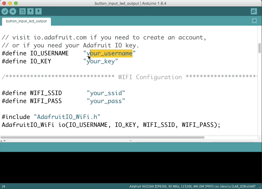

Before uploading the code to your board, fill in your Adafruit IO username and key as well as your wireless network name and password (if you haven't already). Upload the code and test that the button works to illuminate the LED. Use the serial monitor to check if there are any problems (incorrect wifi details would prevent connection, etc.).

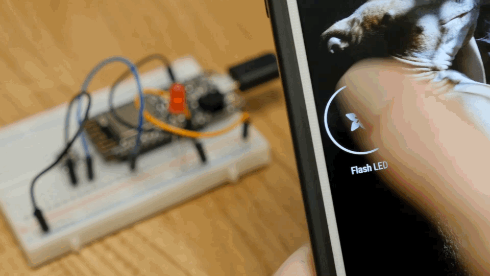

After installing the IFTTT app for Android or iOS, you can complete the applet creation process in your computer's web browser or on your mobile device (the process may have some differences in appearance between platforms but is largely the same).
Click to create a new applet, and pick "Button widget" then "Button press" as the trigger ("+this") and "Adafruit" -> "Send data to Adafruit IO" as the output ("+that").
Select your feed "command" from the dropdown menu, and enter the number 1 in the Data field. Click through to finish creating the action.
Applets created with the button widget are special— they put a widget on your mobile device that triggers the action with one click of the icon on your home screen. Add your new widget to your home screen using IFTTT's excellent multi-platform guide, and tap away!
What do you notice about the behavior of the circuit? How long does it take for the LED to light up after you activate the widget? When I'm prototyping IoT devices, I will often create a button widget to trigger my circuit manually when it would only otherwise be triggered under certain conditions that complicate prototyping (activities that occur only once per day, only when the weather changes, etc.). It can also be a useful tool in demonstrating a proof of concept prototype where the proposed data source is difficult to simulate live (simulating arriving at a GPS location while inside a presentation hall with wifi but no GPS signal, for example). It's also a great troubleshooting tool.

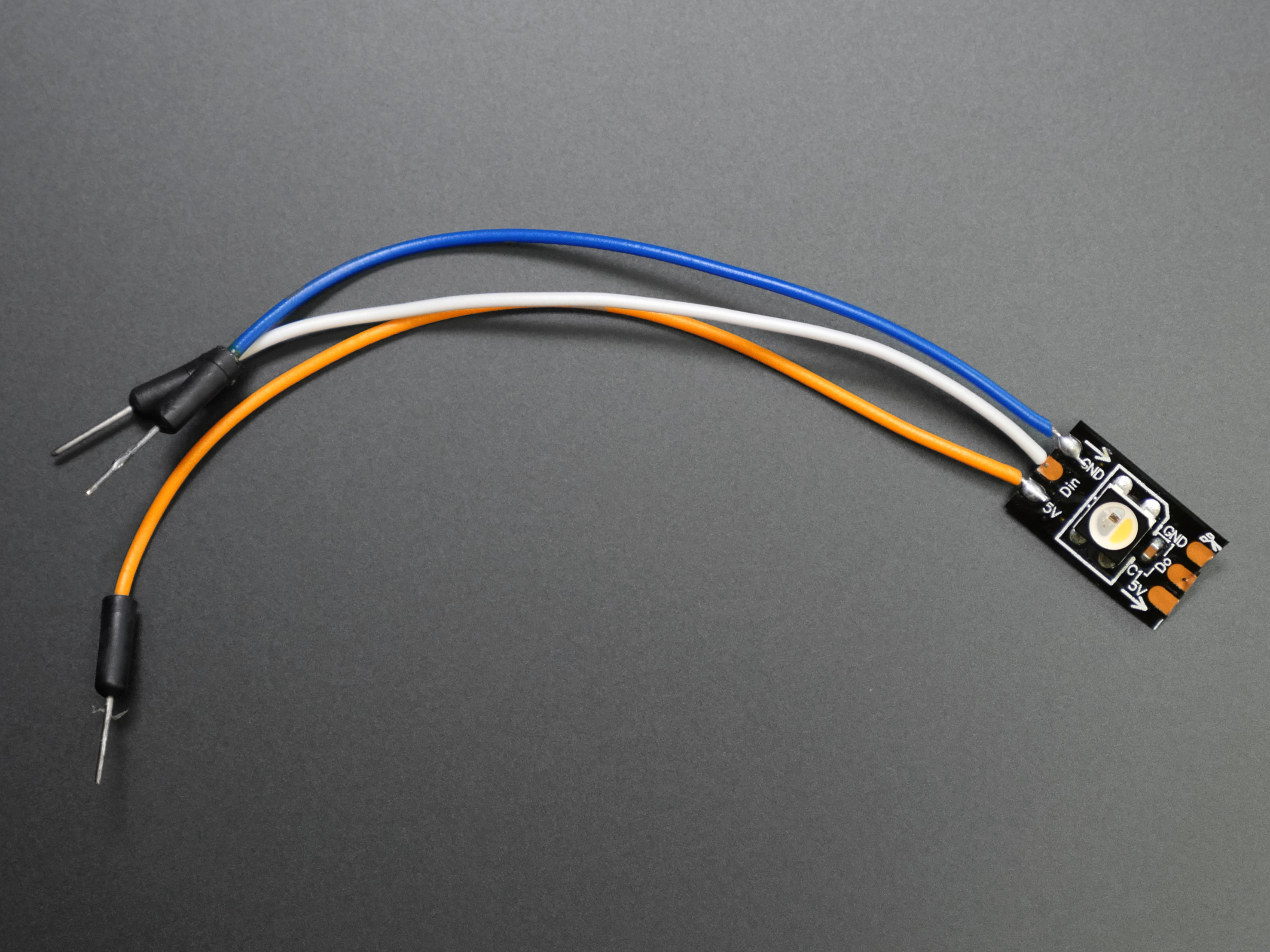

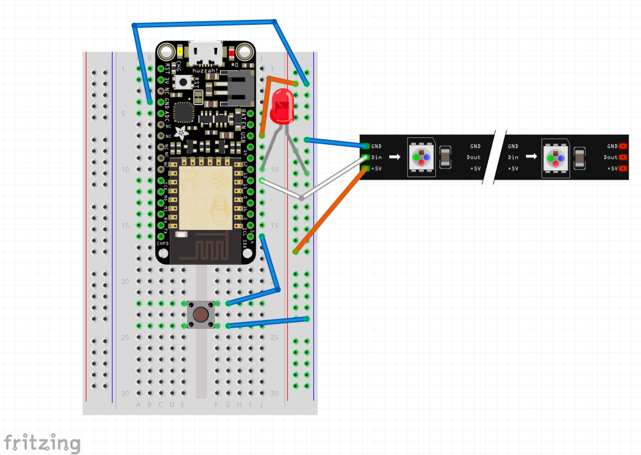

Let's upgrade this circuit's output with some color changing addressable LEDs, aka NeoPixels. You just need one at the minimum, and the sample code later in this lesson uses six. I don't recommend using more than ten pixels for this exercise. If you haven't already, you can learn to solder wires onto your NeoPixels and install the Arduino code library by reading the Skills Infusion lesson in my free Arduino Class. You might find it helpful to resize your browser window so that this lesson is visible along side your Arduino software window.
Wire up your NeoPixel(s) to your existing circuit according to the following diagram:

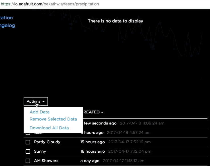

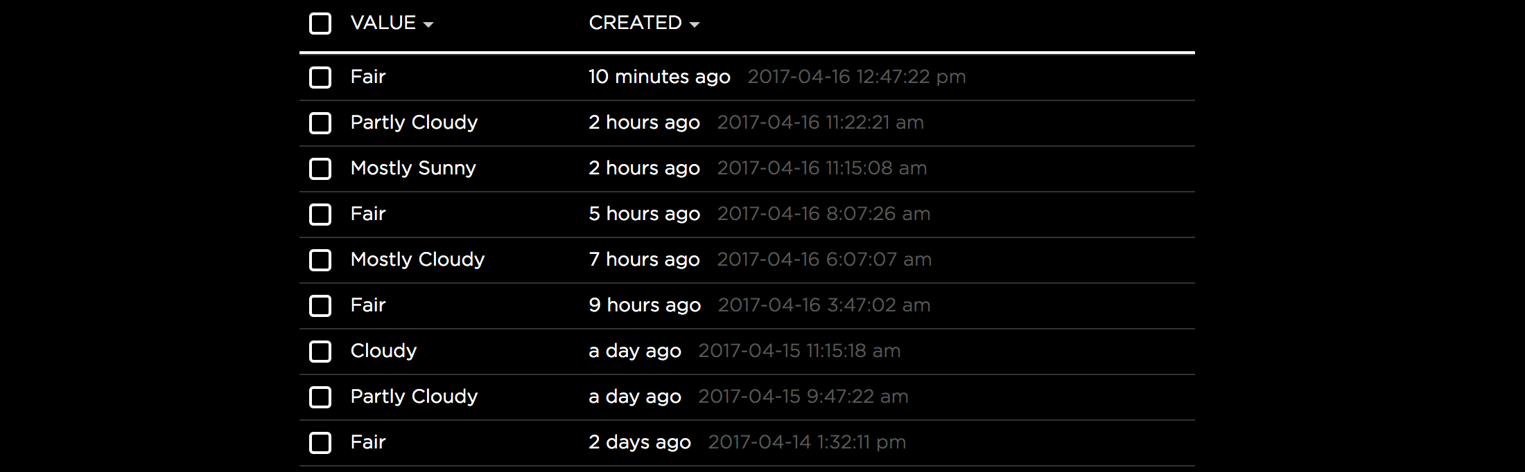

Up until now, our feed's data has consisted only of 0s and 1s. Let's see what happens when we collect some weather data into a new feed called "precipitation". To get an update each time the current weather condition changes, create four IFTTT applets that send data to the same precipitation feed using the Weather Underground trigger, each with a different one of the four condition options. Since this feed is only updated when the weather changes, it can take a few days to see the variation in the data.
Instead of numbers, the feed is filled with words representing a variety of weather conditions. In Arduino, this feed data type is called a String, which is an object that can store multi-character text. You can learn more about this variable type on the official Arduino site, and explore several String examples in the Arduino software. Since we are looking to evaluate the strings in the feed, the StringComparisonOperators example is particularly relevant. In the sample sketch (also accessible in your Arduino software by navigating to File-> Examples->08.Strings->StringComparisonOperators), you can find several if statements with descriptive comments that explain and show how to compare two strings in several different ways.

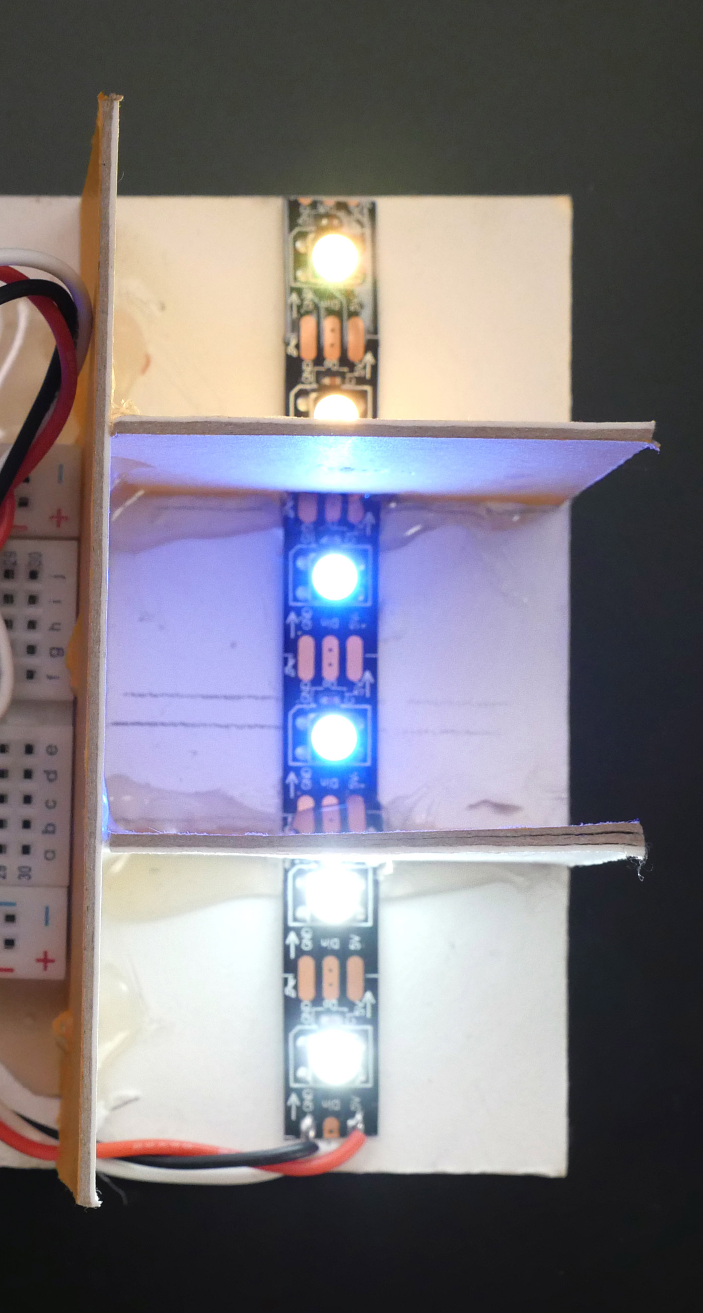

To mock up a weather display, let's make the pixels illuminate some symbols. One of the simplest and best ways to diffuse LEDs is to give them space, so build a small cardboard enclosure that has some depth to it. Add more cardboard walls to divide the pixels into chambers (I'm using three chambers of two pixels each). A piece of plain white printer paper taped to the openings of the chambers provides the "screen," and glueing on another layer of cut paper creates shadowy outlines of whatever shapes you choose.
To test this code, you can manually add data to your feed by clicking on Actions -> Add Data. Type in a weather condition (stick to the ones described in the Arduino sketch) and click Create to add it to the feed. If all's well, your pixels should change whenever the feed updates.

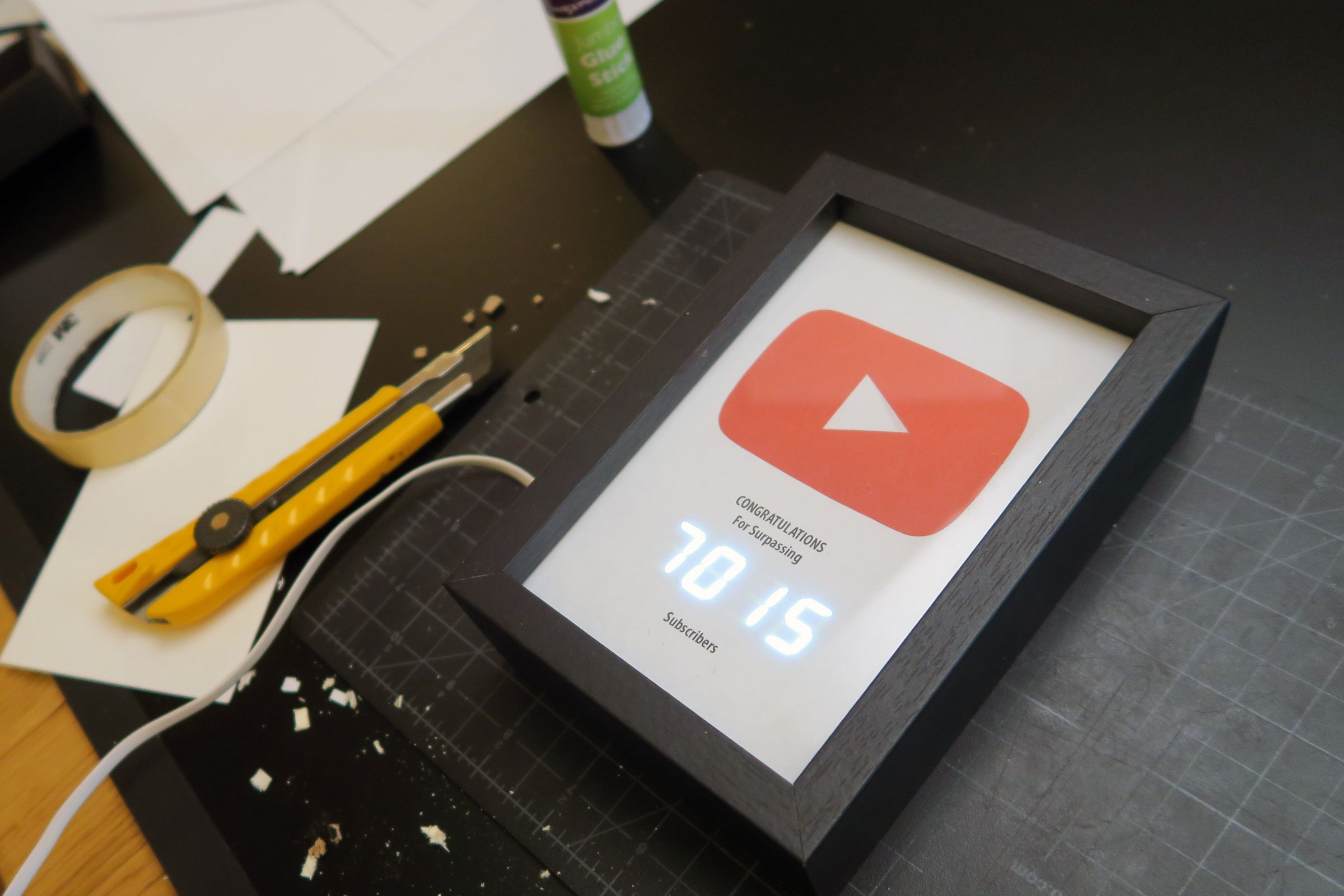

If you find the weather display ideas intriguing and/or useful, you may wish to build a more finalized version with a soldered circuit inside an enclosure of some kind.
You may wish to add a numeric LED display to show the temperature too— find techniques for both in my WiFi Weather Display Instructable!
Perhaps you're interested in visualizing some numerical data like the number of YouTube subscribers— I've got you covered there too. These are just two examples of projects that display internet data, check out more project ideas in the collection below! To complete this lesson, post up a picture of your circuit from this lesson, or a sketch and description of a project you'd build with the skills you learned here. Next up we'll combine inputs and outputs to create two devices that can talk to one another from anywhere there's a wifi connection.
