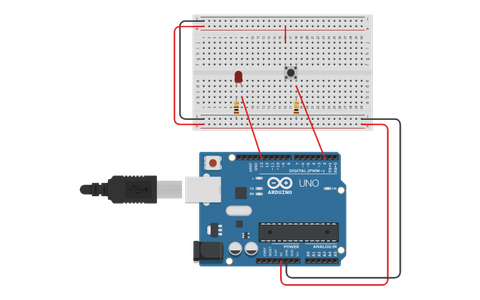

Drag a pushbutton from the components panel to the center of your breadboard, and place it across the center column break so that its legs are plugged into four different breadboard rows.
Click to create a wire connecting one button leg to power.
Create and position a high value resistor (10K) between that same button leg and ground on opposite side.

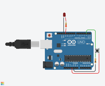

To better understand what's going on, it's useful to also take a look at a free-wired version of the sample circuit, pictured here.
Explore the sample circuit embedded here by starting the simulation and testing the pushbutton. Remember that the breadboard rows are connected inside, so you can plug in components and wires to make quick temporary connections. You could load up a new Tinkercad Circuits window and build your own version of this circuit along side the sample. Reference, the picture above. You may choose to do the exact same placement as my tinkercad or schematic.

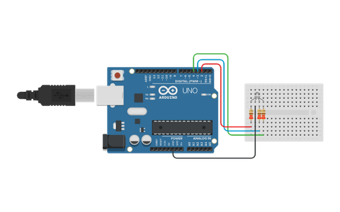

In this step start wiring all your components. Make sure to use the proper colour for the RGB wires. Connect your Piezo to ground, pushbutton to power, all the LED's to each output. Check PDF below.
Add your components, the Piezo, LED’s, RGB, resistors, and pushbuttons.
560Ω resistors go to ground
10kΩ resistor go to ground
RGB go to ground
LED go to ground
Piezo go to ground
Pushbutton go to ground
LEDred to pin 8
LEDorange to pin 9
LEDyellow to pin10
LEDgreen to pin 11
LEDblue to pin 12
Push to pin 2
Buzz to pin 7
