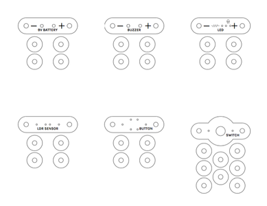

The Circuit Making modules can be easily reproduced using a laser cutter.
Start off by downloading the "modules" PDF file. By feeding it to the laser cutter, you will obtain the foundation of a complete set of modules.
We suggest using plywood or plexiglass. Plywood is cheaper, but comes only in one color. On the other hand, plexiglass will allow you to differentiate the modules by category.
In order to built each module, you will also need a bunch of other components, including screws and magnets, that are listed in the Circuit Making Bill of Materials. You should be able to find all of them at your local hardware store. Once you're all set, you can start building.

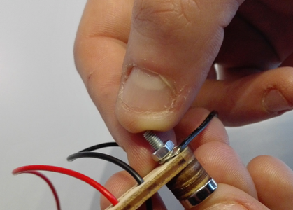

First, insert the screw in the hole of the magnet. Since the magnet is countersunk, the screw head should fit perfectly. Then, repeat the action with the 2 washers. Later, you will need the nut to secure the leg to the module.

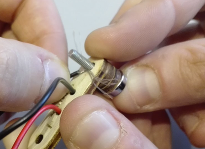

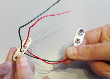

Now it's time to loosely attach the legs to the base of 9V Battery. Notice that the top of the base has the name of the module written on it, as well as the plus and the minus signs. Insert the screws in the two holes of the base, making sure that the engraving sits on the top. This will help you identify the positive and the negative pole of the module.
Keep the legs in position using the nuts. At this stage, you don't need to tighten them; just make sure they don't fall off.

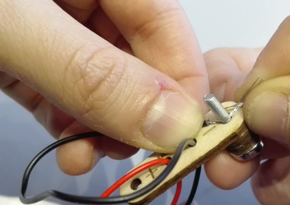

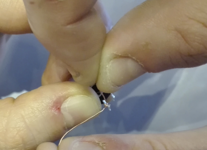

Once you've built the 2 legs needed for 9V Battery and loosely attacched them to the base, strip the wires of the 9V clip. If you don't have a wire stripper, feel free do use regular scissors.
Each wire will be wrapped around one of the screws. The red one should be wrapped around the one marked with the positive sign, whereas the black one should be attached to the one marked with the negative sign. In order to do so, insert them in the small holes of the base, making sure they stick out on the top. Divide each set of wires into two bunches and roll them until they are firmly attached to each screw. This passage is very important for the effectiveness of the circuits you will make later: if they aren't attached properly, there won't be the needed electrical connections.
Once you're done with this task, tighten the nuts on the screws.

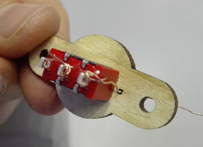

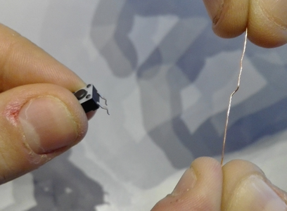

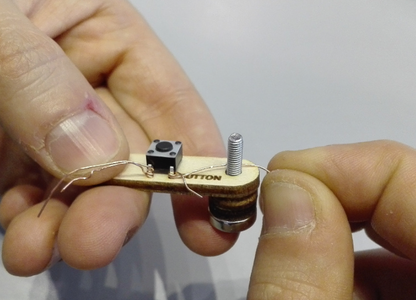

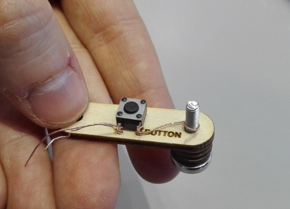

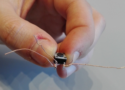

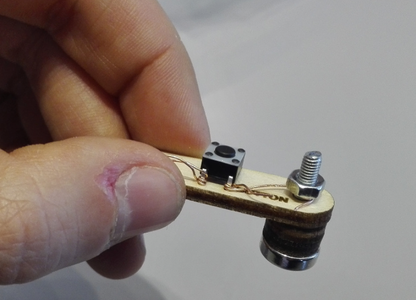

Now it's time to build Button. Start off by putting together two legs, as shown in the previous passage, and loosely attaching them to the Button base. Once you've done that, grab a small piece of copper wire and attach it to one of the four legs of the actual button. Repeat the action for the leg that sits opposite to the one you've just attached the wire to.
Place the button on the base. The holes at the center will help you to secure it.
Now take the two pieces of copper wire and wrap them tightly around each screw. Secure them with the nuts. Bear in mind that the buttons don't need to be oriented in a specific way in order for them to work.

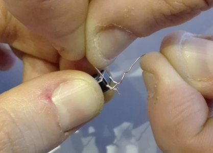

Take a look at the potentiometer. As you can see, there are three pins that need to the connected the actual legs of the module. The one at the center will connect to the leg marked by the letter S. The right one will go to the right leg and the left one will go the left leg.
In order to do that, use copper wire. You can wrap it very tightly around the extremities of the wires, or you could also solder them, if you have access to a soldering iron.

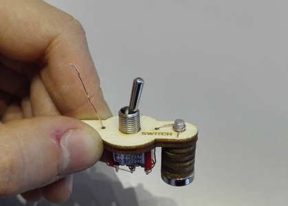

Now let's build the switch module. First of all, build the legs.

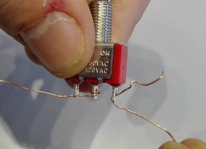

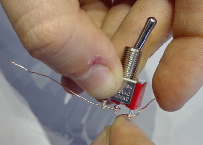

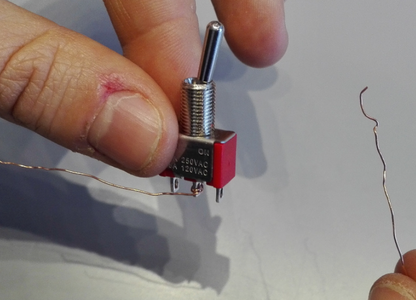

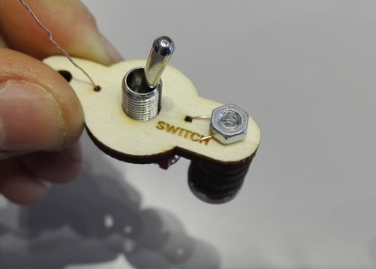

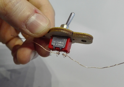

Once you're done, take a look at your switch. As you can see, it has three different pins. You are only going to use two of them. Take two pieces of copper wire and attach them to two pins, as shown in the pictures. Bear in mind that there shouldn't be any connections between the pins, so make sure the wires don't touch each other.
Now insert the top of the switch inside the biggest hole on the base. Then insert the copper wires in the two remaining holes and fasten them to the screws.

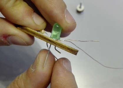

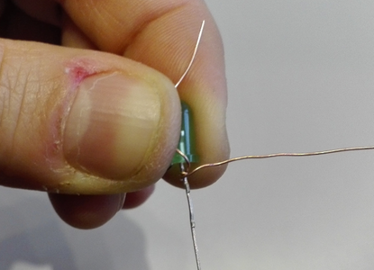

Let's start with the LDR. Mount the photoresistor on the base, then bend its legs upwards, inserting them in the small hole of the base. The photoresistor isn't polarized, so you don't need to worry about placing it incorrectly. Now take two pieces of copper wire and wrap them around the legs. Secure the module with the nuts.

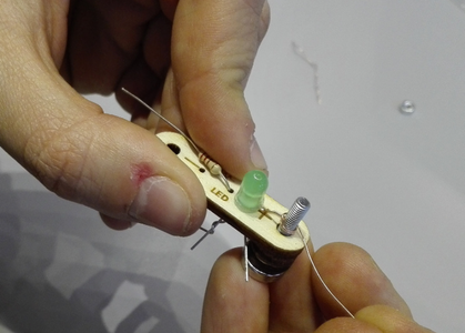

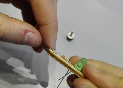

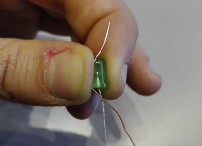

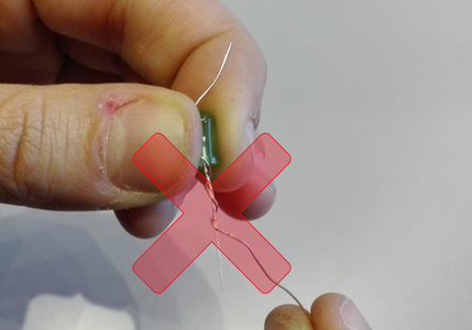

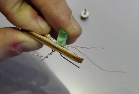

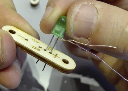

Now let's build the LED. The LED is polarized. The longer pin is the positive one, and thus should be placed on the side of the base that is marked with "+". Create the connection between the pin and the screw with copper wire.
The shorter pin the negative one. Connect it to one side of the resistor and use it to create a bridge with the screw that will represent the negative side of the base. You don't need copper wire for this side of the module.
