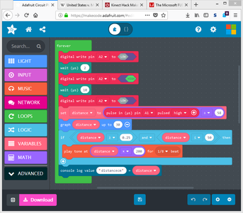

The sample MakeCode is shown above and is also available as a published project.
The code is a simple loop sending a pulse to A1 output pin and then measuring the pulse on A2 input pin with the Makecode pulse in pin block. The division by 58 converts the timed value into centimetres and this value is then show on the neopixels up to a value of 30cm. The distance is also represented by a short beep with frequency between 50Hz (0.25cm) and 10kHz (50cm). The distance is also logged but this is only visible if you are using the Windows 10 app version of Makecode.
It's not clear if this sensor has a maximum measuring rate or a required pause after the Echo pulse before the next measurement. If it does then the code has a minor flaw as it's relying on the console log as a delay if the distance is out of range for the beep to occur.
