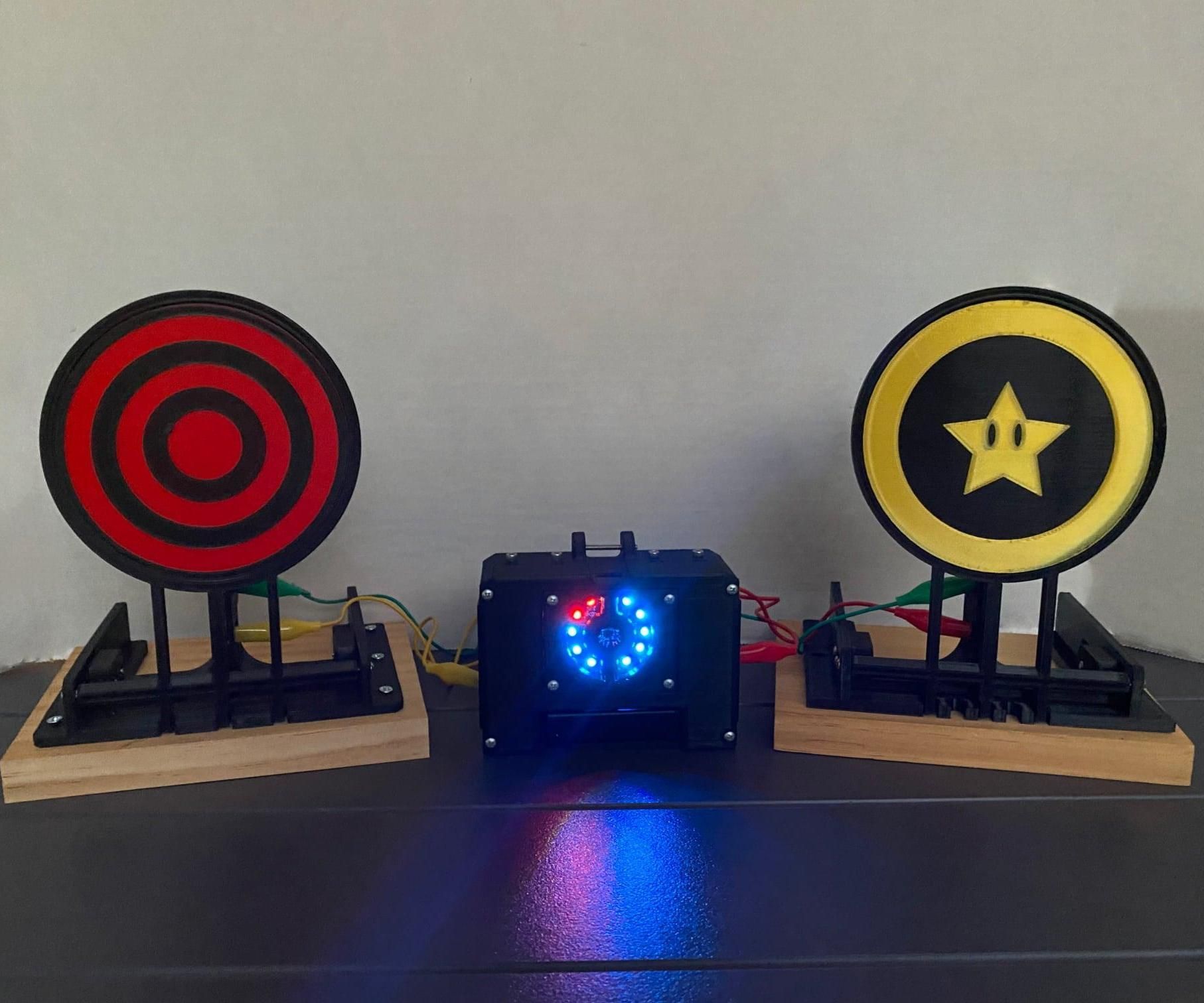

Meet the Circuit Playground Project Box! Struggling to find a sturdy, protective display case that could be used with the Circuit Playground in my Elementary coding class led me to the development of this Circuit Playground Project Box. The purpose of the box is to protect the Circuit while allowing the kids full access to the terminals and sensors. My hope is that this will allow students to explore the capability of the Circuit Playground while also displaying their projects in a stylish, compact display box.
Examples of Projects Include: Nerf target (explained below), Alarms, piano, and much more!!.

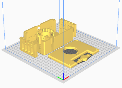

Step 2: Let's Print the Parts

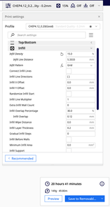

All of the parts have been printed in PLA plastic using an Ender 3 Pro and Cura as my slicer.
I'm using CHEP slicer profile "CHEP4.12_0.20(Good)" with no support and an infill of 15%. You can find the profile here just make sure to change the support and infill.
CHEP is also a good resource if you getting started with 3D printing and have any questions about the Ender 3. Link to his YouTube Channel.
As you can see from the pictures, all of the holes are marked with the corresponding Circuit Playground pin.
All of the prints were printed in the same position as they would be put together. Look at picture to see the printing orientation. No support is needed when printing the parts.

First, place the Circuit Playground in the correct orientation in the box. Do not add it yet; this is just for point of reference to get to know how everything will be wired. I have labeled all of the holes with the corresponding Circuit Playground pins. If you look at the picture, you will see that I have duplicate pins for A2 to A5. This allows the students to be able to use those pins as a touch pad or for a physical switch if needed. This would be needed when building a Nerf Target game. The project will need a touch pad to start the game and a physical switch to track hits. We will be able to use pin A5 and A4 on the top of the box to reset and start the game. Then we can use the ground pin on the back of the box and pin A6 on the left of the box with alligator clips to use as a switch on the target. So, for example, pins A4 and A5 will have a Y-connector and the A6, A7 and 3.3V pins will be straight one to one connections. In the next step, I will give the measurements of the wires I cut for each pin.

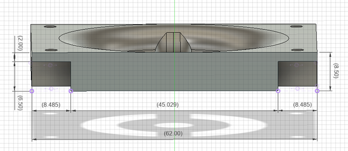

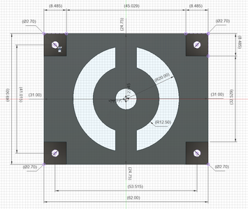

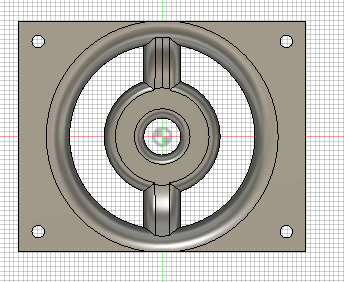

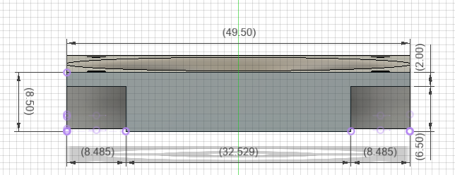

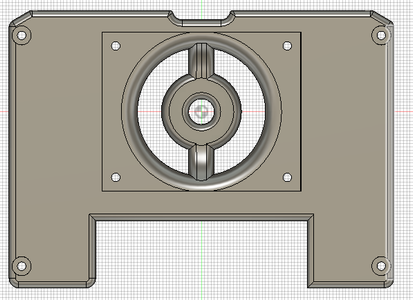

Step 13: Bonus Cover V2
The new cover was inspired by a project that I'm working on. Trying to make the cover easer to configure by allowing students to use Tinkercad or 360 Fusion to design a custom faceplate.
