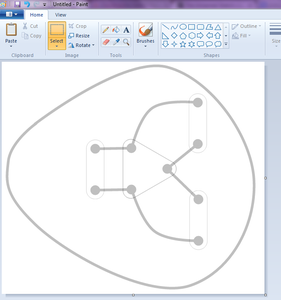

Step 3: Nab a Screenshot
There are some great options at 123D Circuits for Circuit Scribe that allow you to do things like print off your creation. Once you have a sketch of a Circuit Scribe project you want to make, you can create a Bill of Materials (BoM) and a printed version that makes it easy to go back and trace over the important paths and nodes with a conductive ink pen.
However, we are not going to be doing that. We are going to get a screenshot to manipulate.
- First, make sure you are inside your project's sketch in edit mode.
- Next, click "View" towards the top.
- Make sure that you turn "Modules" off.
- To verify you have the right view, we want to see the paths of the conductive ink and the circles the components ("modules") should sit on, but we do not want to see the components right now.
- Get a screenshot!
Once you have a screenshot saved, you are ready for the next step.

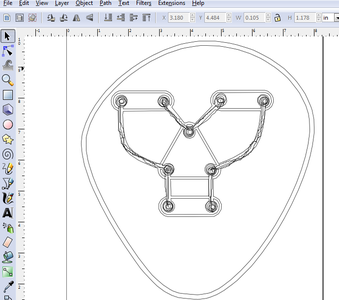

Step 4: Edit and Save As SVG
We used Inkscape here.
There isn't much to edit, but keep this stuff in mind:
- Change the orientation to how you want it to appear on your polargraph drawing machine.
- The best method here is to create a new layer and only trace over paths and circles and then erase the original image before saving as SVG.
- If you want, you can also draw artistic components as a separate file with a regular pen to save expensive conductive ink. Just make sure no lines short out any of your paths, or the components will not work as intended.
- Make sure you redraw multiple times over each path to be drawn out, and..
- Make sure you redraw each module node (the circles) multiple times.
Those last two steps are pretty important. You want your polargraph drawing machine to make multiple passes for each module node circle and path so that the conductive ink will be heavy enough and makes a solid connection.
Our poor little Pablo skips just a little bit, so one single line is not reliable enough.
Almost done! On to the next step!

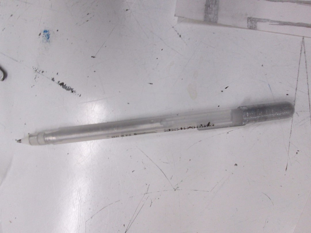

Step 5: Send to a Polargraph Drawing Bot!
After you save your new image as an SVG, load that sucker up into your drawing machine, equip your drawing machine with a conductive ink pen, and BOOM!
Robots drawing robots.
If you are having trouble figuring out how to send vector SVG files to your polargraph drawing machine, consult the instructions and accompanying resources for your build. Euphy has documented a lot on this process in his tutorial linked at the beginning of this tutorial.
Once your robot draws a robot, place a metal backing behind the image and place your components on the front side of the image.
Test it out and see if it works! Ours did!
As a side note, you may want to adjust the size of your drawing. Since we are using Euphy's design, we can do this in the custom Processing program used to control our dear Pablo. It took us a test draw before we got the sizing right.
You might want to test with a regular pen before wasting conductive ink.
