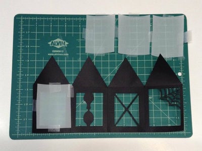

Step 4: Create the Lantern
Cut out our lantern template on black cardstock using the Silhouette plotter. Our file is attached to this step! You can also print out the template on an inkjet or laser printer and use an X-acto knife to trim out the pattern.
Cut squares of vellum paper (or parchment) to cover the empty spaces in the lantern where you want the light to shine through. Tape the vellum onto the lantern, and fold lantern so that it can stand on its own. Tape to secure.
